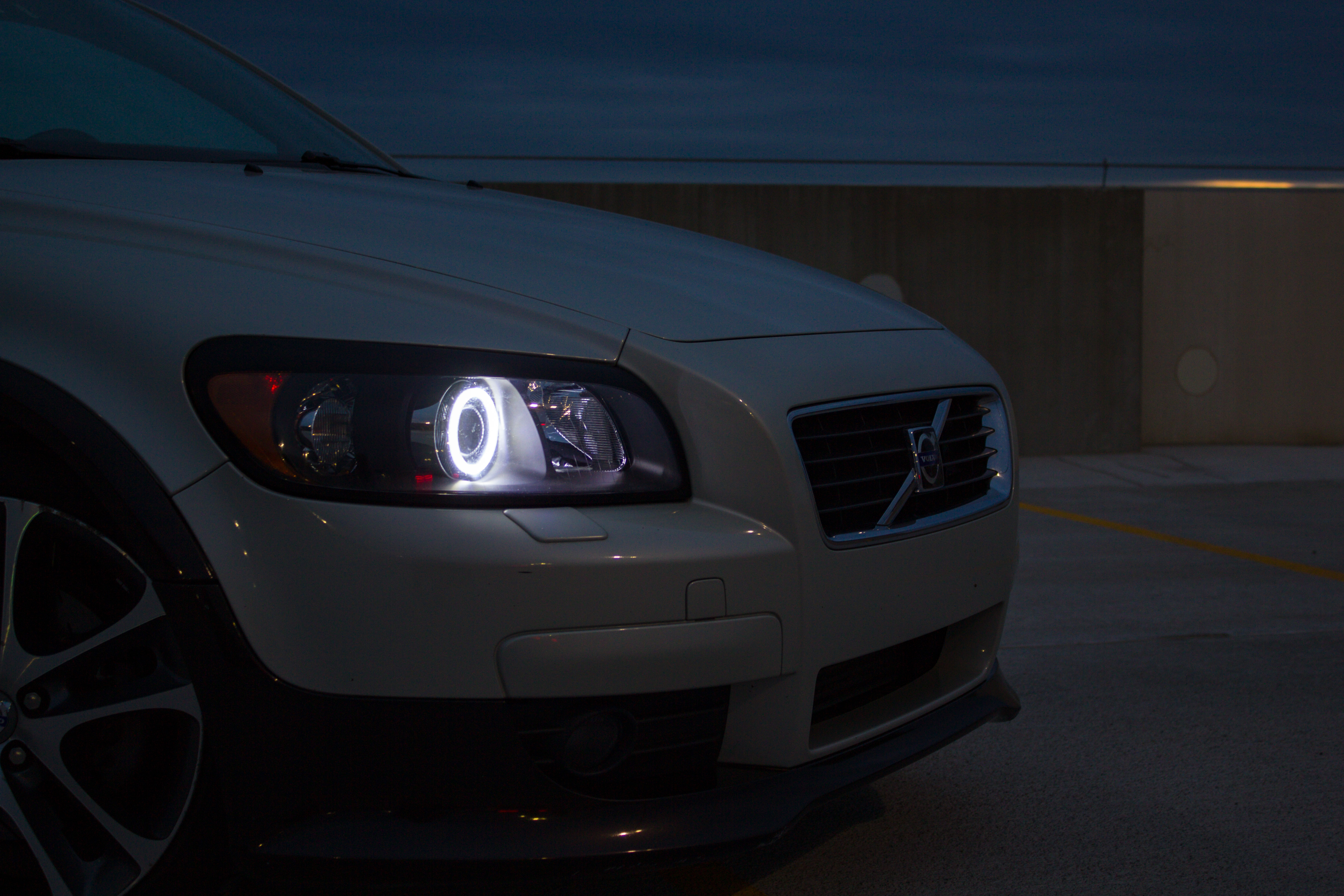

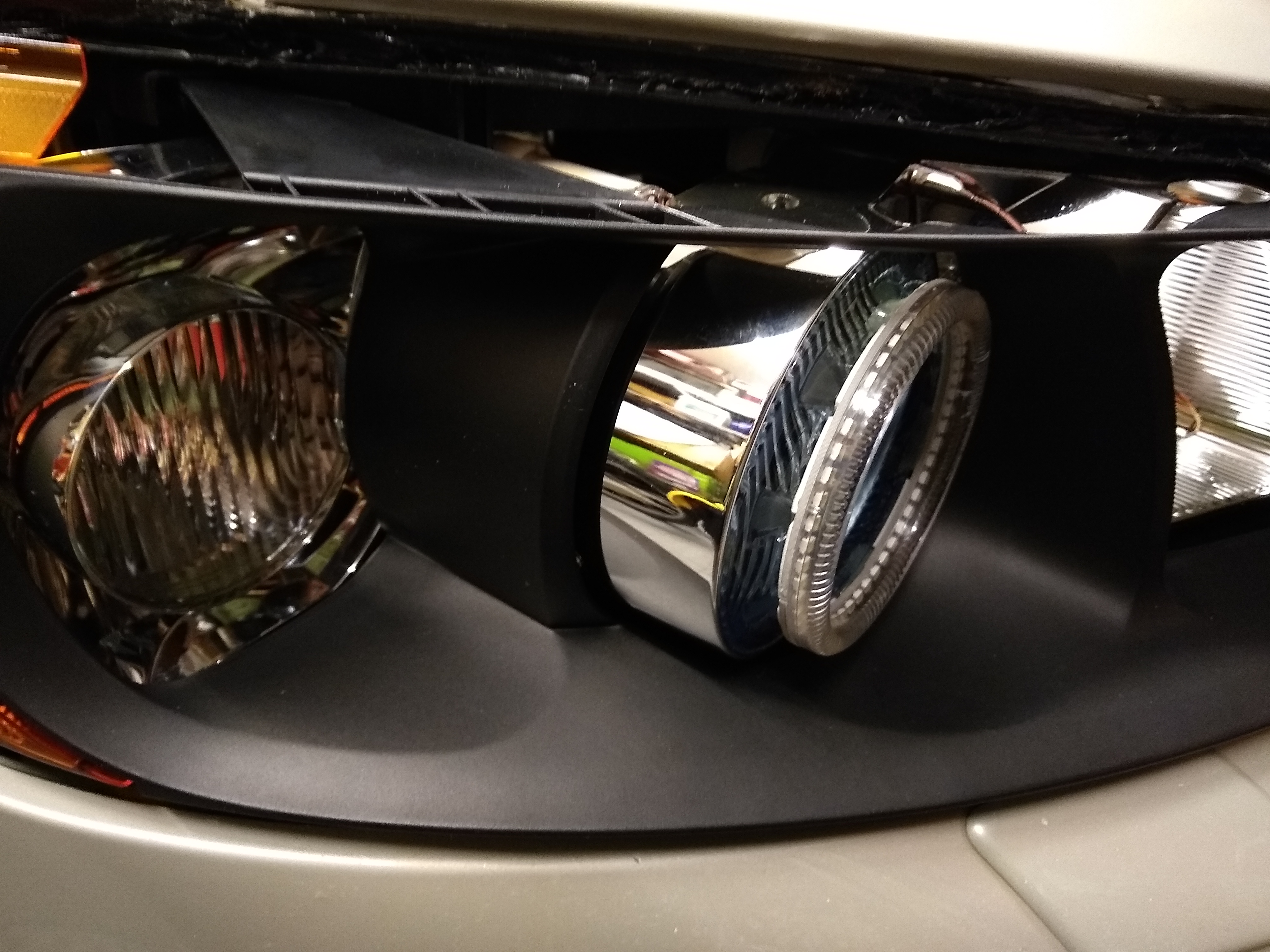

Suggest you find a Halo small enough to go behind the trim ring / xenon cover. We separated our assembly but another C30 member said his Halo was slightly smaller so could just go on the back of the ring. Wire into parking light and it can be on all the time without issues and you won't have the DRL or headlights on.
Hot glue and double sided tape which it came with.

Bright enough for safety during the day.

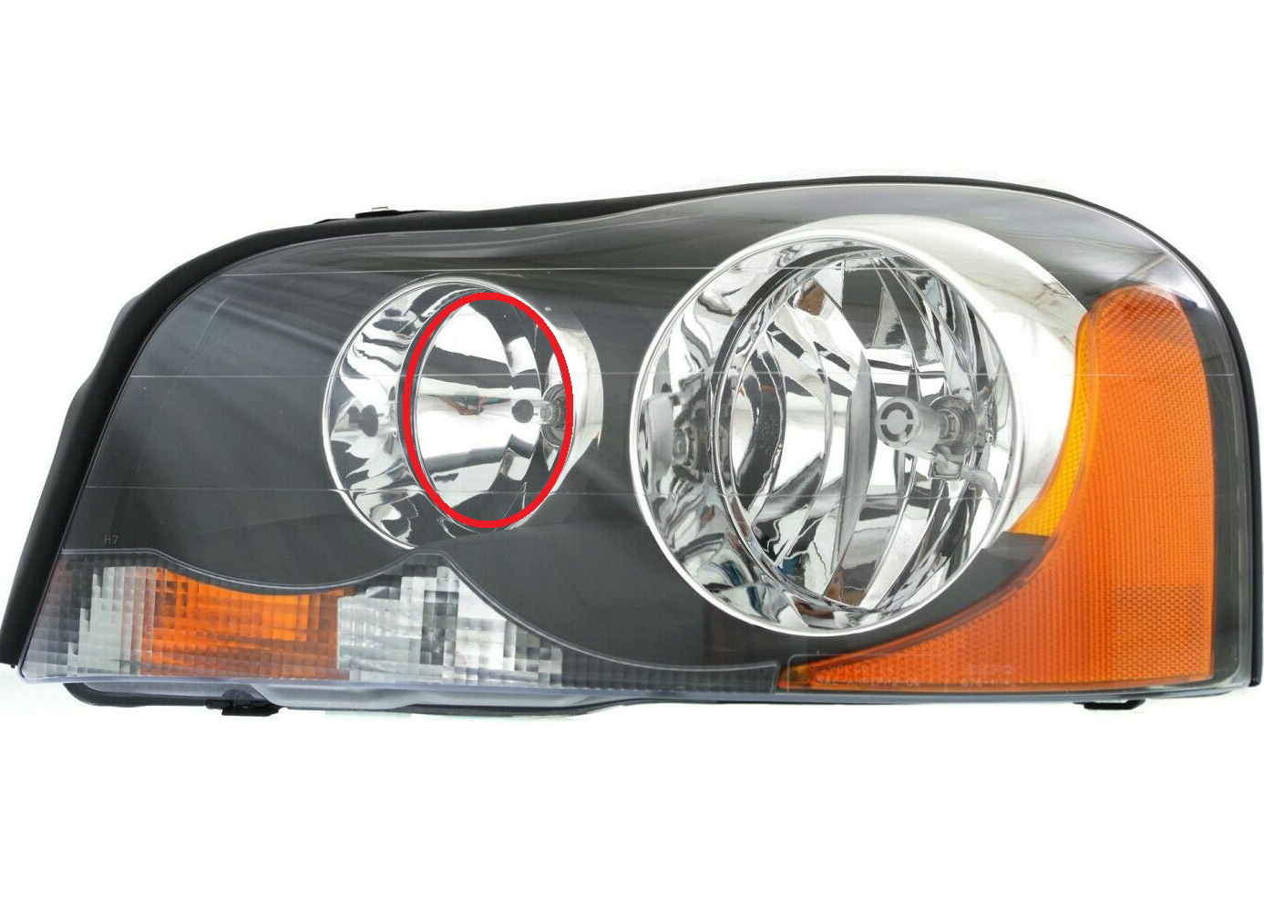

Headlight Set For 2003-2014 Volvo XC90 Left and Right With Bulb 2Pc
https://www.ebay.com/itm/231559409104?f ... SweLNhQCZu
Looks like Halogens for both hi and low beams. Take you own assembly and separate. From the seams it looks straight forward. Install Halo's on the hi beam as it hardly ever gets use. When the lo beam is on in the evening it won't heat up the Halo as it's on the other lens.
As mentioned before driving with only the parking lights switched on during day all your exterior lights will be on for safety and the DRL will be off.
