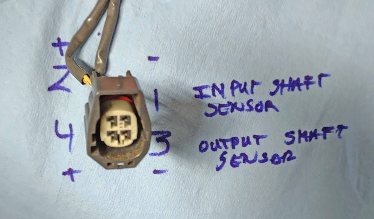

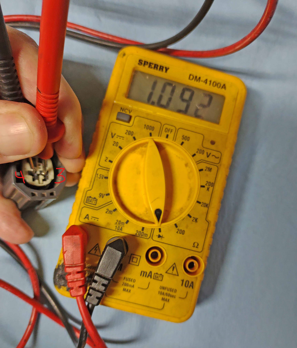

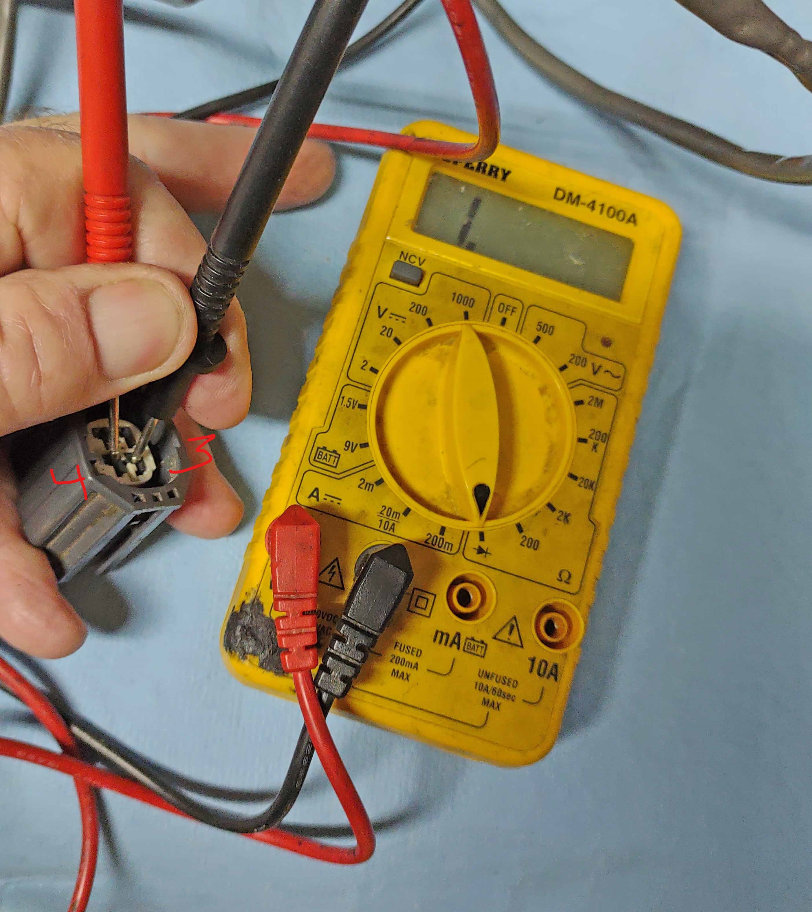

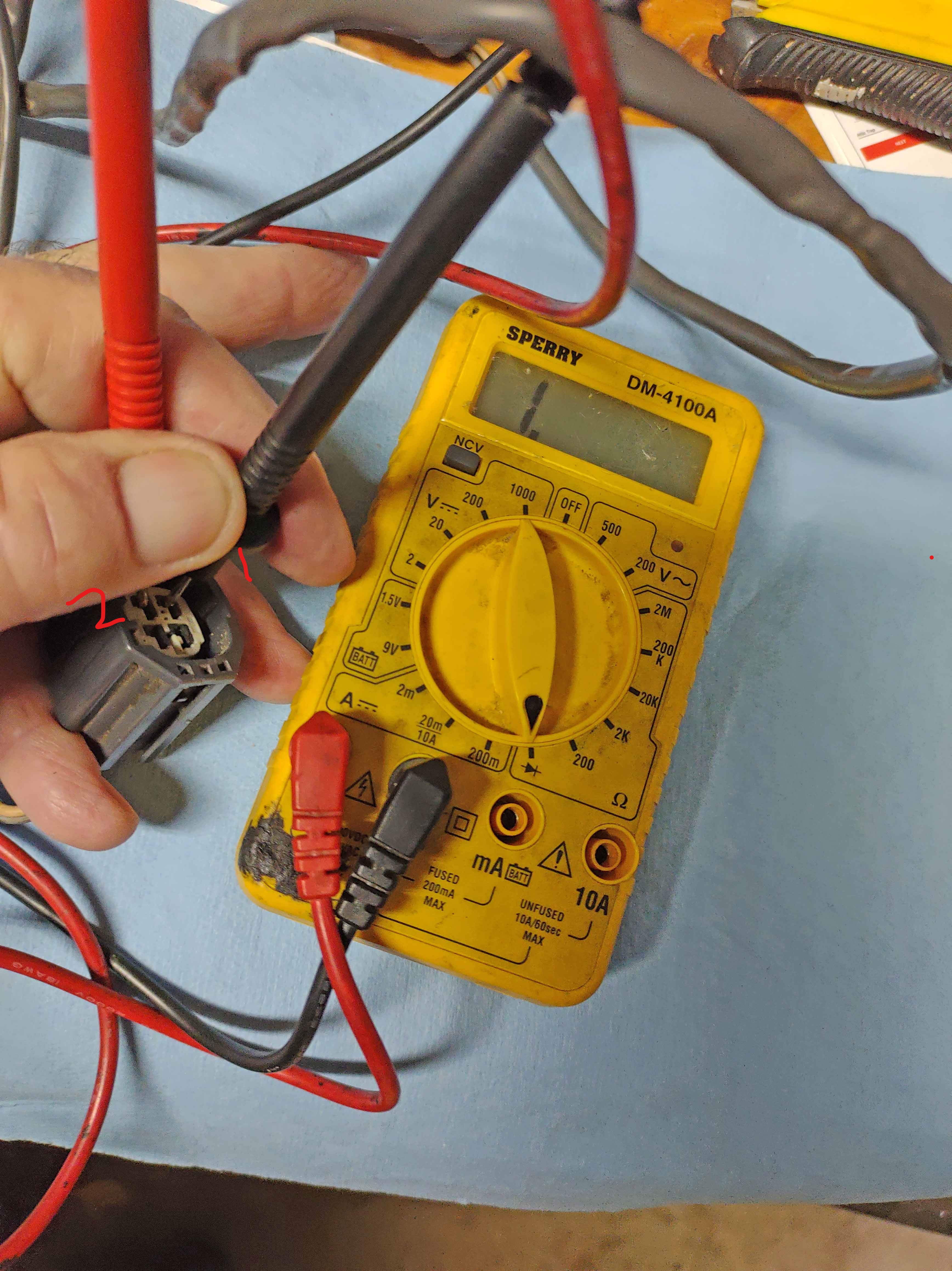

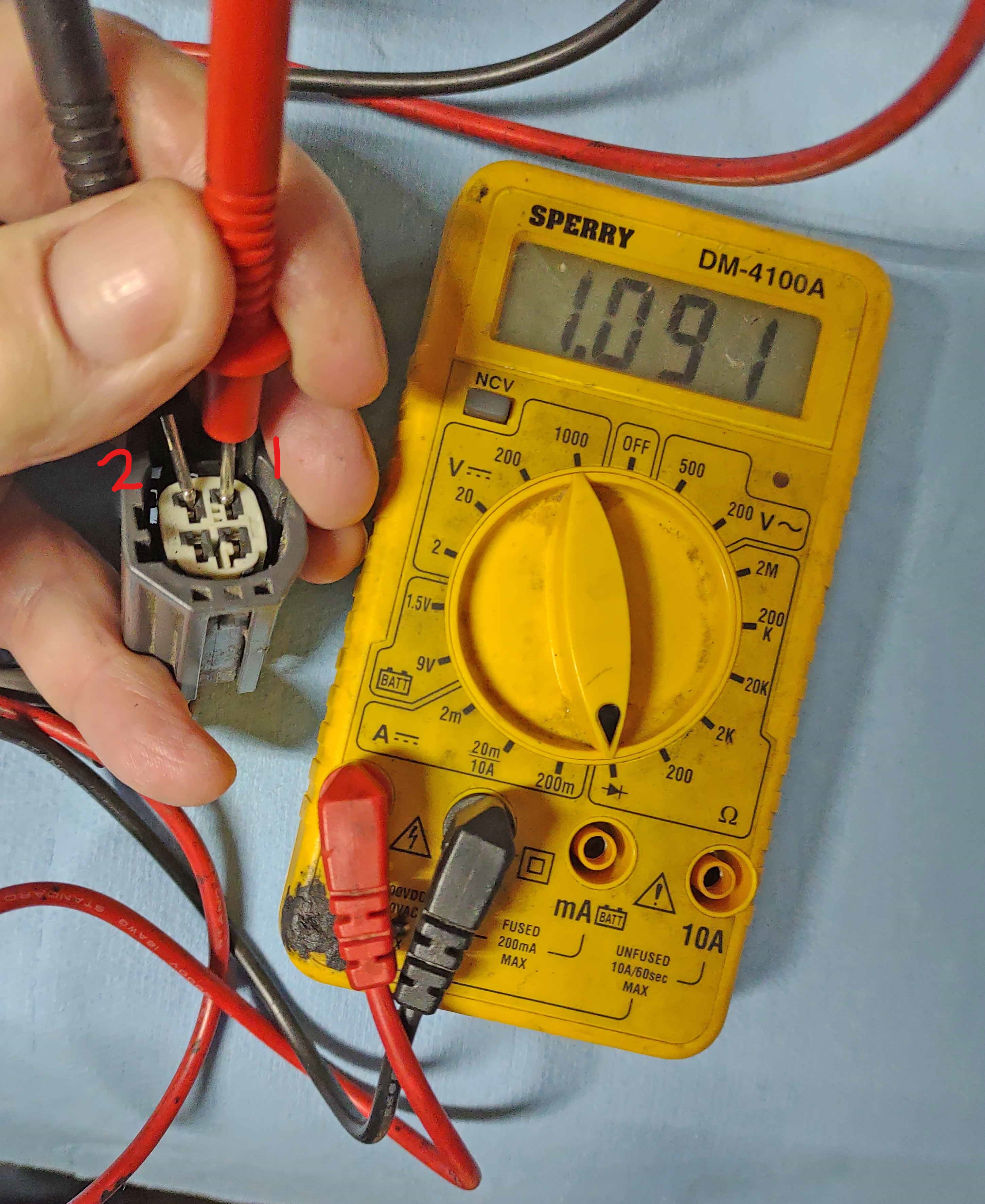

When I checked these sensors with the older style harness where the two sensors are hard-wired to the 4 pin connector they were tested using the diode setting on the meter because they're active type sensors with polarity, not a single resistance in both directions. With the older ones hard-wired in and if you don't mind splicing in a replacement sensor these sensors are easy and cheap to get from the salvage yards. In my opinion getting a used genuine OEM sensor is better bet than a $10 aftermarket sensor although it's good to know there's an inexpensive option available that works if funds are tight. Always appreciate someone like yourself that does some experimenting and finds an alternative that works. The input shaft and output shaft speed sensors are identical as far as I can tell and they don't go bad very often.
