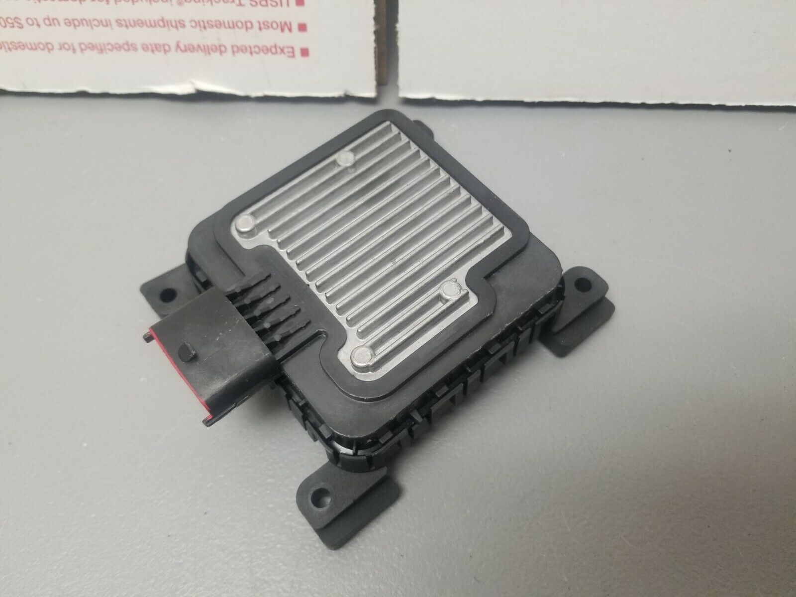

Pump output is controlled by a module (PEM), part of a demand system that manages pump speed as a function of a number of inputs (FPS sensor feedback as one). Looks like you replaced pretty much everything except the PEM. Was this ever checked as part of the troubleshooting process? Module should be under the seats in the area of the tank, looks like this (gratuitous photo from the internet):
I might have another look in the area of the tank and consider replacing the PEM with another while the tank rings get opened, tank channel fully cleaned, and o-rings reseated and properly tightened. Might also be something completely unrelated but if I still had this issue after all of the other parts you're replaced, I would be looking at the electronic module which controls the pump output and that's the PEM.
Speaking of which, something in the back of my head suggests that the fuel pump will still produce a partial output if the PEM is not working, this might be served via the internal ejector pump. Forum member jimmy57 can probably provide some insight into this and it "could" explain the sputtering and cutout at full pressure.
