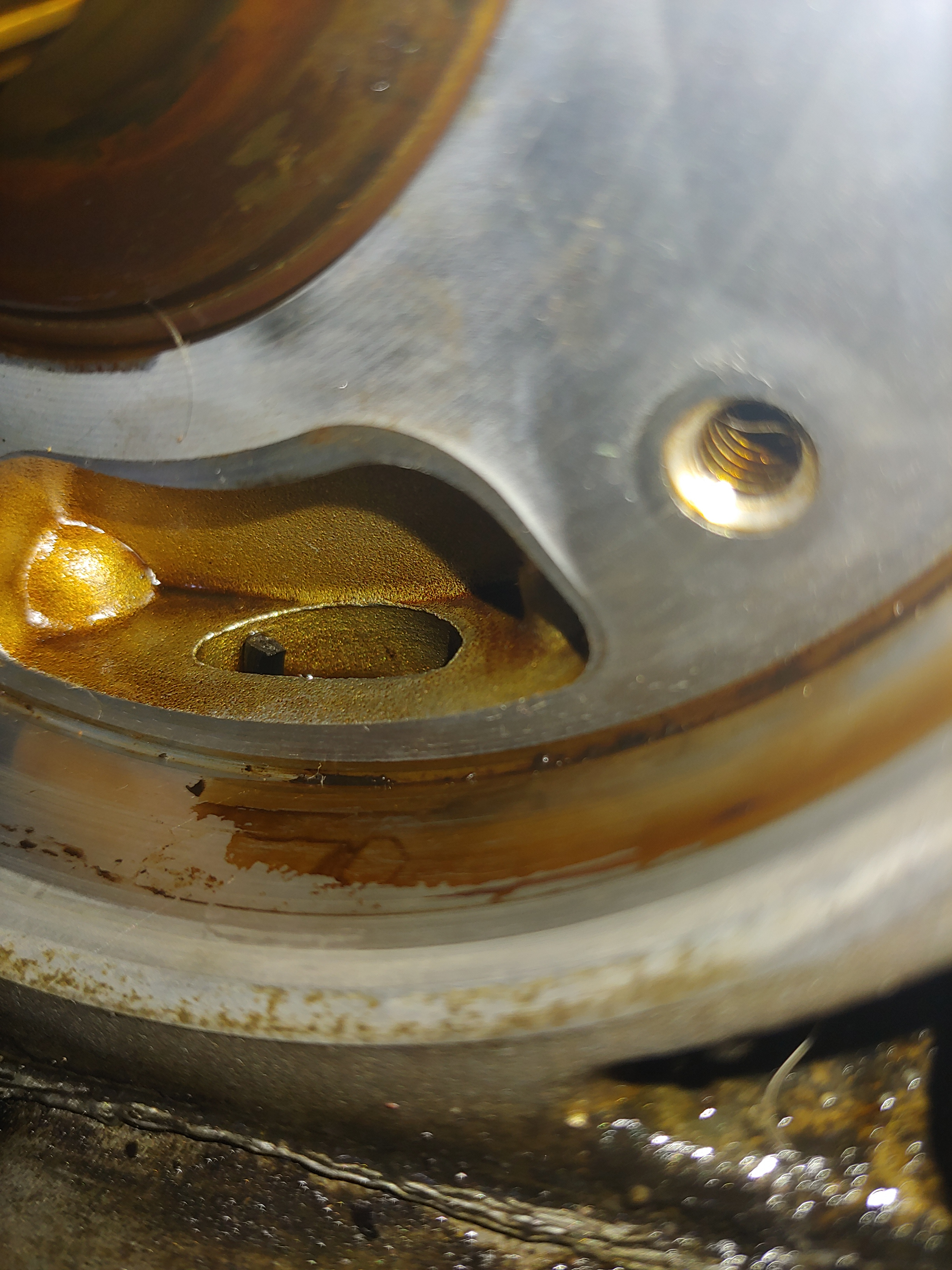

- I have never opened the oil pan, so most likely I have all problems of sump pump seals. When I removed the oil pump, there was a piece of dried mangled o-ring sticking from the bottom hole (pic below)

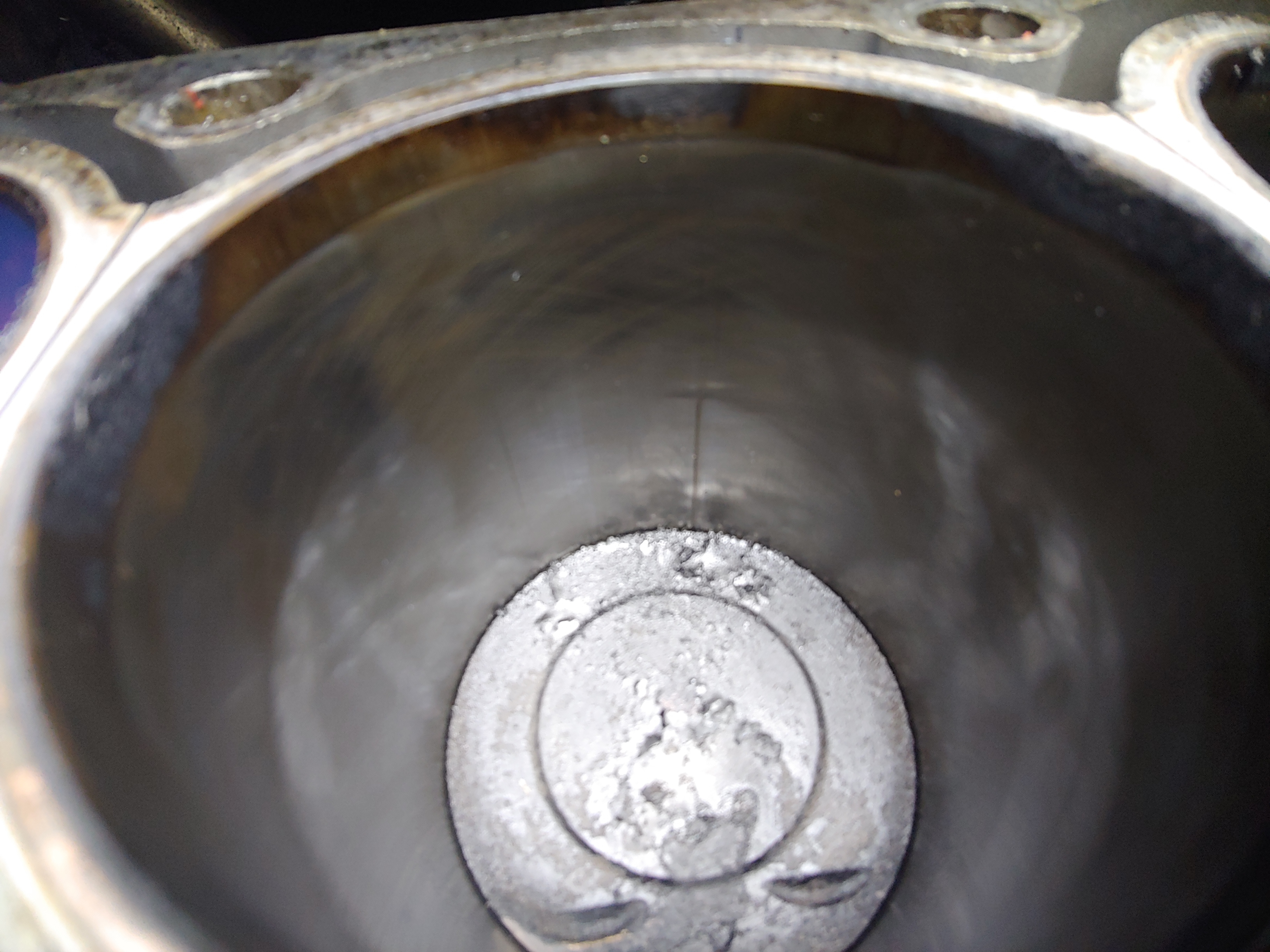

Guys, thank you for your response. It turns out I failed to disclose some damning evidence:
The vertical line in the middle is a gash/nick. I have noticed it today when going over cylinders (last time I just removed the head and call it the end of a long weekend).
The nick goes from the bottom to about half way up of the piston travel. I can feel it but I cannot measure how deep it is. I guess it is deep enough to cause pressure of only 110-150psi.
I suspect it's been there all these years (given the oil mess in/around oil separator , flame trap, and pushed out seals). Call me sloppy: I do not recall doing a compression test back in 2010 after I put the engine back together with new valves - I was happy it ran better.

Is that a scratch or a split in the block cylinder wall? Yikes. Have not seen that before, except on thin walled R motors
Put it back together and drive it with love. I think you are only going to get another 10 years out of it at best

Second leaving it alone. Do the oil pan o rings though and avoid being tempted to do more "while you're in there." Did you mention anything about oil consumption, might have missed that. Not sure why compression of 120-150 in one cylinder would cause a misfire? The vertical line does indeed look weird.

To answer questions above: it was a nick, not a crack. I assume the burnt valve actually lost a piece of metal (some 12 years ago). I can imagine how the fragment bounced in the cylinder before being blown out.
