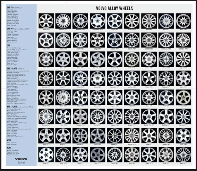

Matt put up a collection with a good number of the wheels available a while ago. Here is that:
https://www.matthewsvolvosite.com/volvo-wheels/
