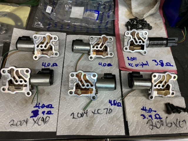

To test the solenoid/coil, though, you can check continuity; it should come in around 3.7 ohms, per ViDA.
I test them with 12 volts simply to see if the plunger moves freely within the bore.
If the solenoid clicks but the plunger doesn’t move you can bet that it needs to come apart (if it’s the serviceable type) for cleaning.
If the solenoid doesn’t click & there is no movement of the plunger (and no viable continuity reading), the coil in the solenoid is dead.
All the VVT solenoids I got today (and my original 01 XC70) came in right around 3.8-4.0 ohms. I tested them cold, though it would be more accurate to test them hot.
FezMonki, is your original like the top right in this photo? If so, that is the non-serviceable type.
I happened across this useful guide for disassembling the serviceable-type of VVT Solenoids.

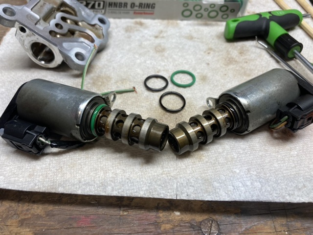

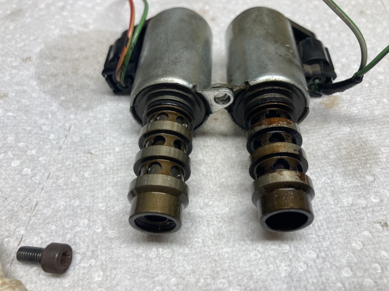

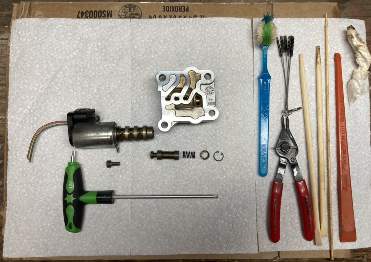

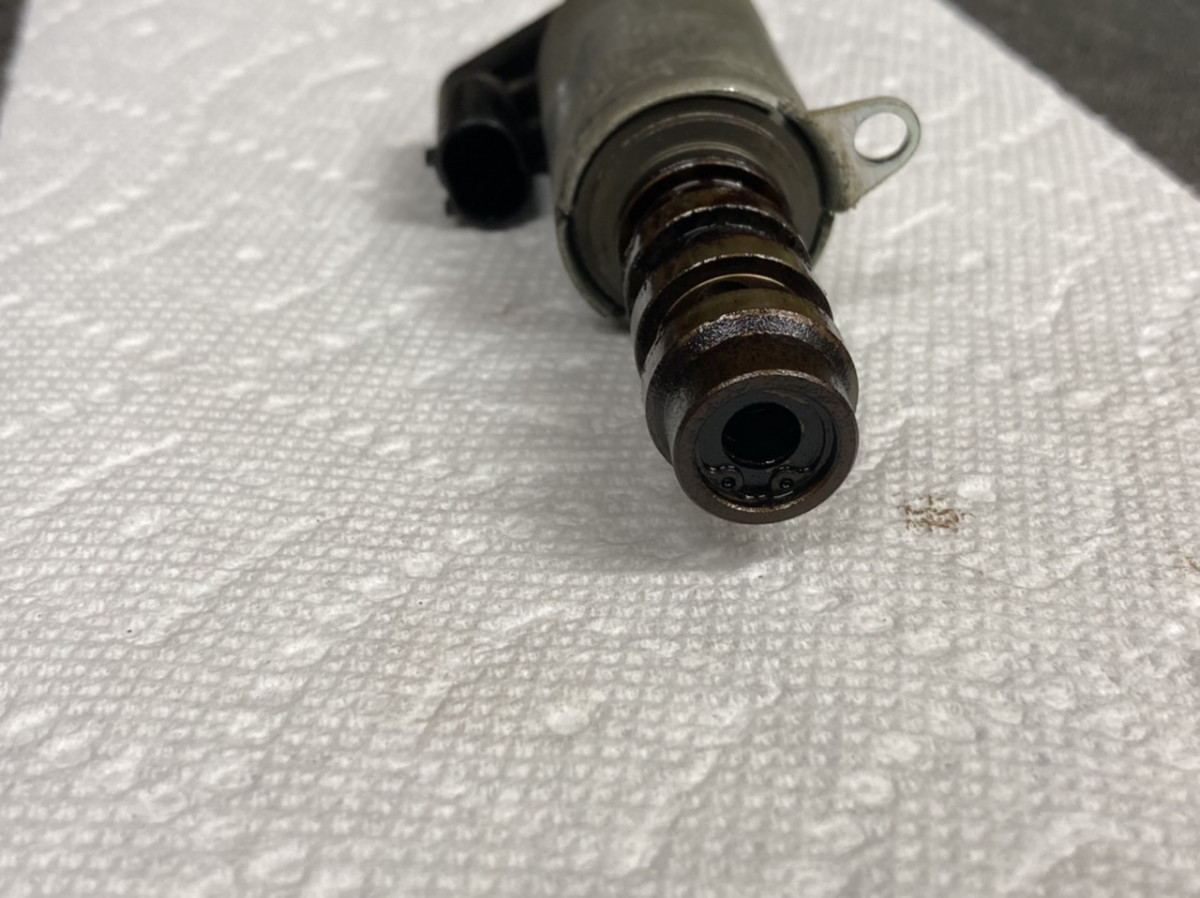

I took some time after work to disassemble a couple of the junkyard VVT solenoids. Very simple construction & disassembly is exactly as depicted in the link I shared earlier.
One trait that I was particularly impressed by was how very tarnished and immobile the plunger was on both solenoids I disassembled! Both were intake solenoids out of 2 different engines, almost identical in overall condition (inside and out). It was a tedious chore to remove the plunger from its bore (using nylon and bamboo tools (the same tools I like to eat sushi/shish-kabobs with) to not marr any surfaces) on both solenoids.
Here is a photo of one disassembled, cleaned and ready for reassembly. For cleaning I used diesel followed by brake parts cleaner. You will want to be careful to not get brake parts cleaner on the rubber o-ring that seals the solenoid to the valve body. You’ll also want to avoid getting diesel or brake parts cleaner on/in the solenoid portion.
After cleaning everything I reassembled using engine oil and tested with 12 volts. It truly is amazing the difference it (cleaning) makes in the actuation! After seeing the before and after I’m pretty sure I’m going to take the solenoids off all my engines & repeat this process. I’m curious if any real world difference would be noticed.
Anyhow, FezMonki, I wanted to say that after giving it more thought, I think you should give the PPS solenoid a whirl. Post your ohm reading on it if you will also. I’ll still send you an OEM one if you’d like (disassembled, cleaned & reassembled or not). It’s up to you.

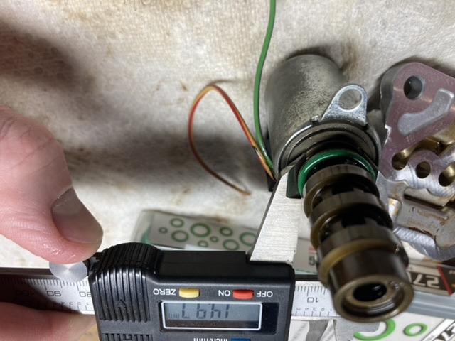

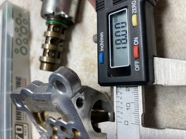

It was kind of silly of me to recommend being careful with brake parts cleaner around the original o-ring that seals the solenoid to the valve body. The problem is, Volvo does not give any direction as to servicing these, nor do they have a spec for replacements (o-rings). No big deal, we’ll figure it out.
The o-ring channel on the solenoid measures a hair under ~15mm and the bore into which it will install measures ~18mm. Factory 16-18ish year old o-rings came in between 2.06-2.19mm cross-sectional width. For replacements, I opted for 15mm X 2mm HNBR o-ring for their heat tolerance & petroleum product resilience. I will be due for oil/filter change in around 400 miles on my 2001 XC70. I will install one of these “rebuilt” exhaust VVT solenoids (8670422, now superceded to 36002686) on my 2001 within 48 hours, run it the remainder of this oils life and check it periodically for leaks.
