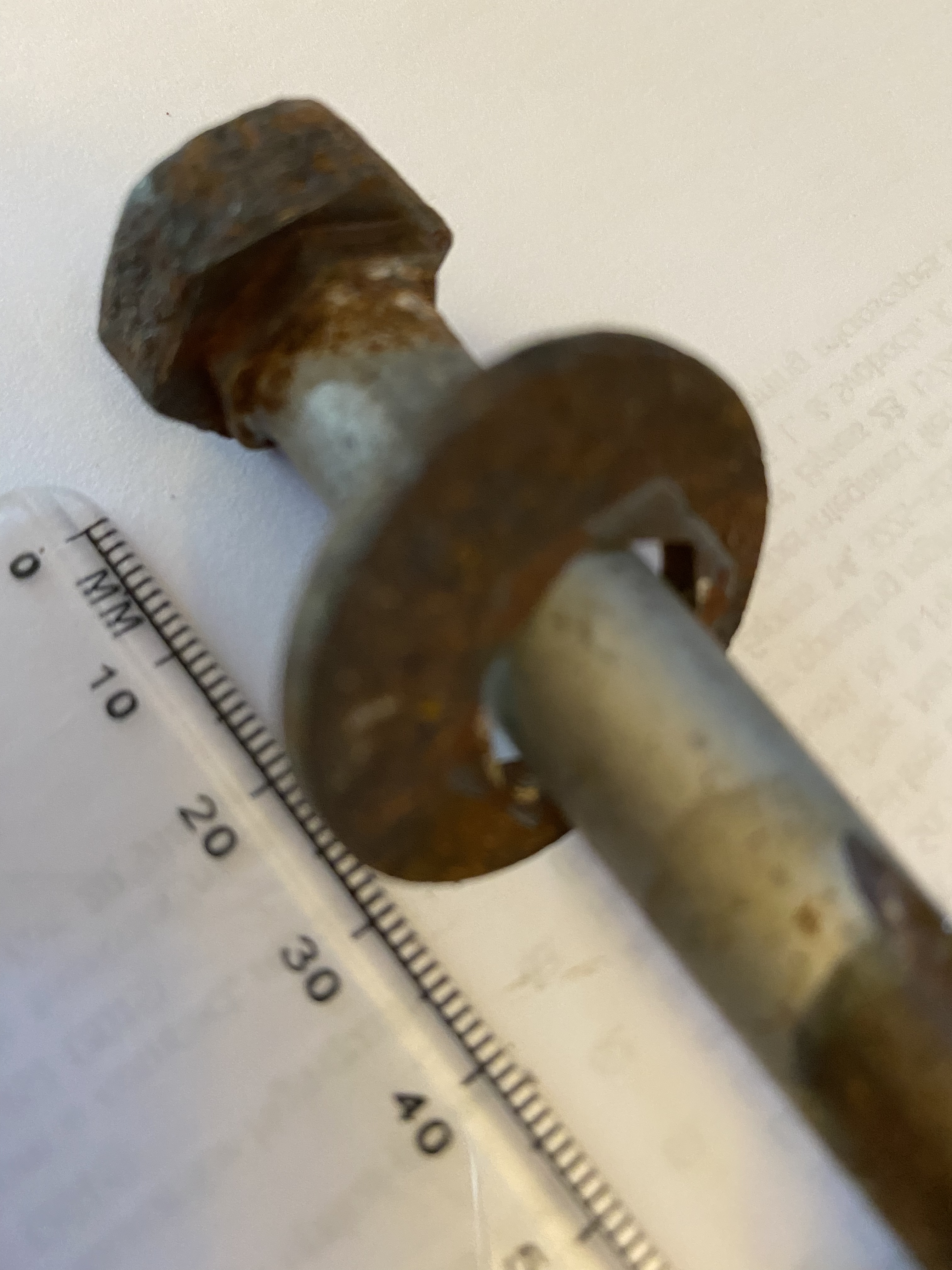

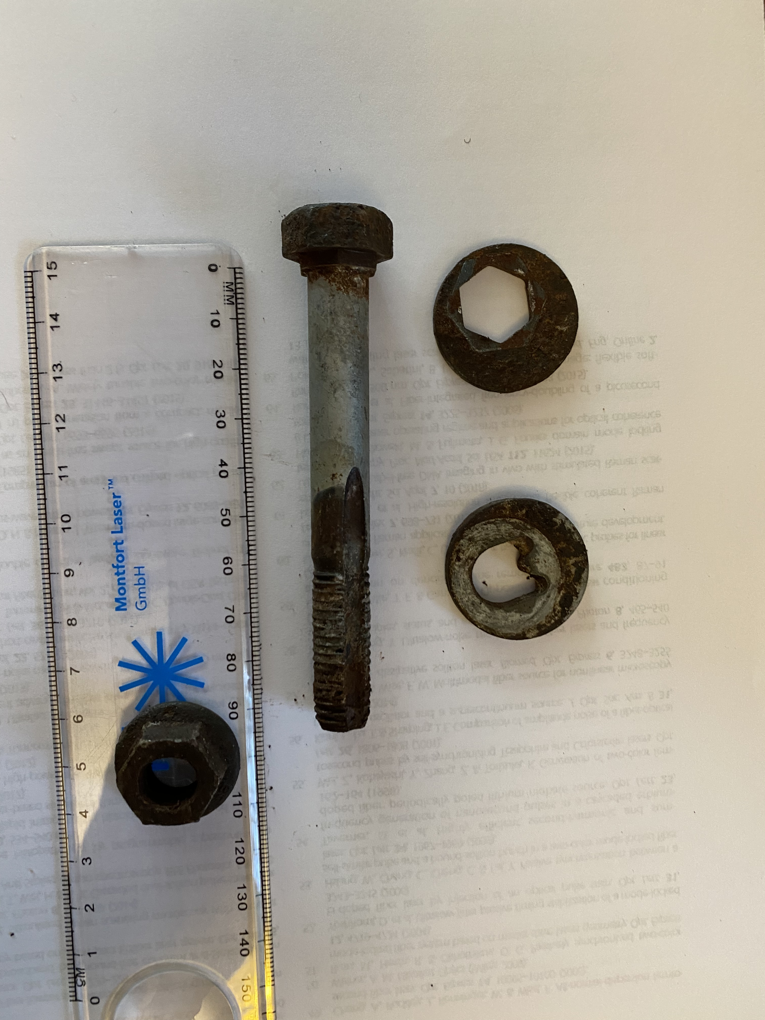

Here are the details in the adjuster. This is not going to be easy to make.
You have to put a hex boss inside the cap head on an M12 bolt in 10.9 steel
One obvious solution is tack weld the adjuster washer to the head

Managed to find and order two spares. New part is one piece on the head , the other washer and nut are later P2 parts and are still available

Maybe it is just the angles in the picture, but are the bolts the same diameter?
