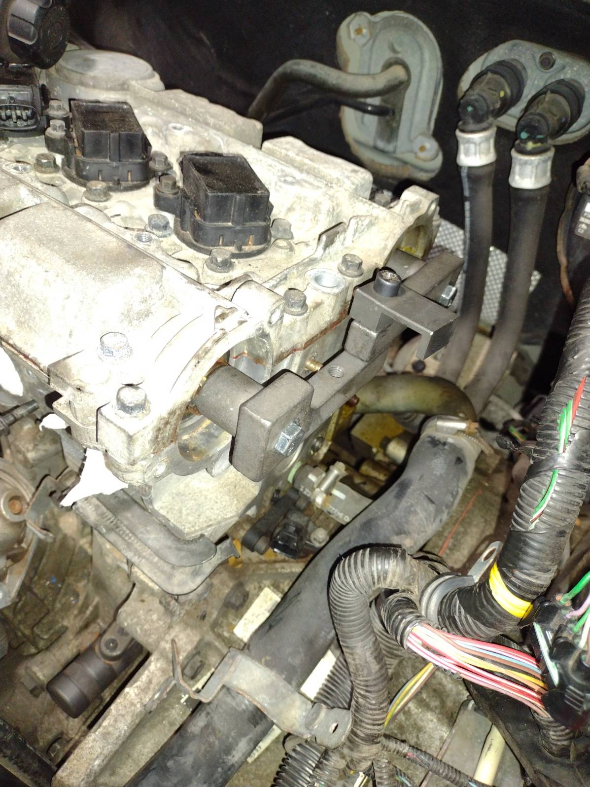

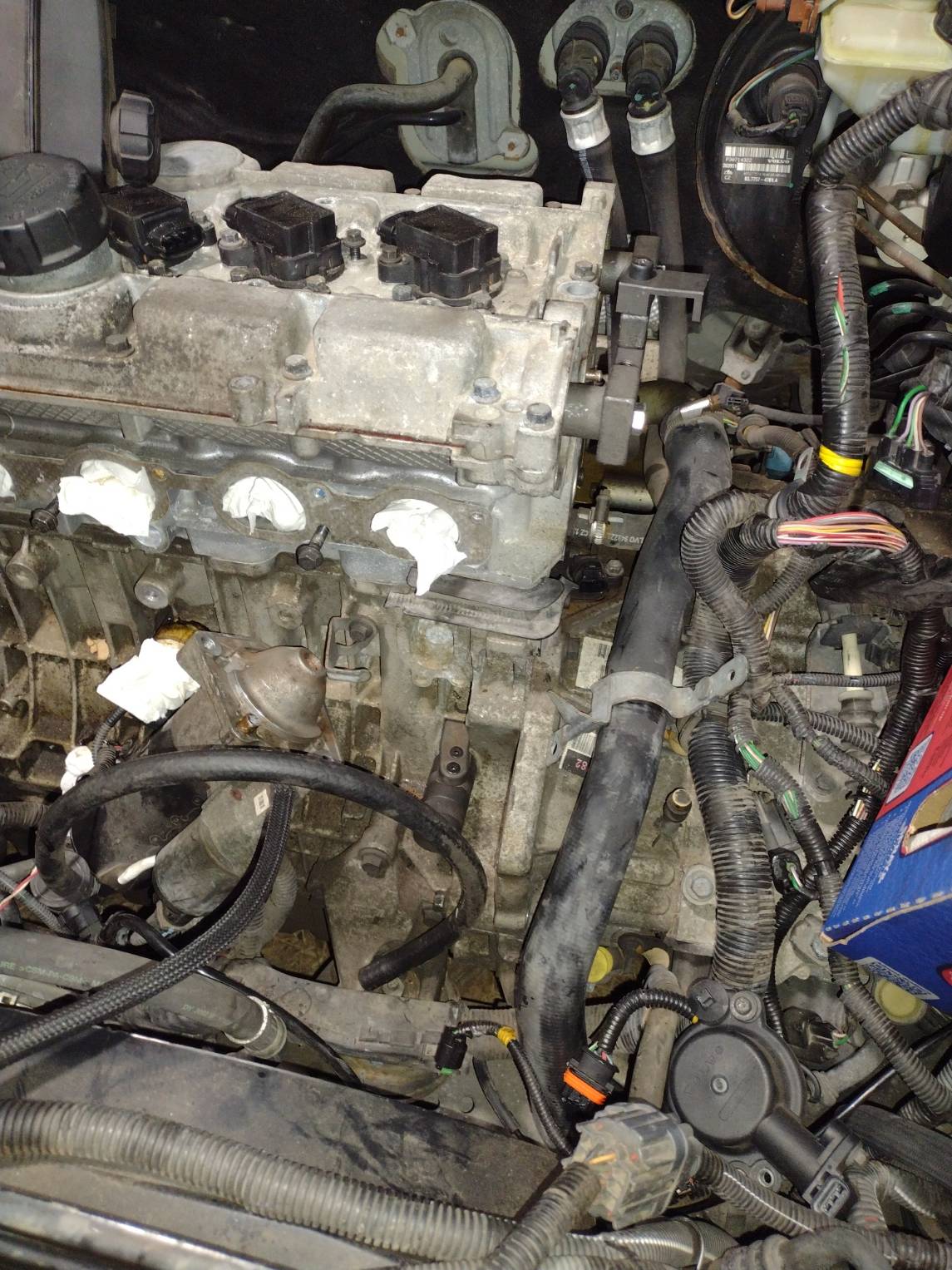

Ok. My mom has a 2005 S60 2.4L non-turbo. I have been doing the maintenance on the car since new. In 2015 I changed the timing belt and water pump out at 100K on the car. I went with a Gates timing kit as it was what appeared to be a good choice, which ended up being the worst choice out there. The bearings went out in the water pump, threw the timing belt, and smacked the valves. Sent it to Scroggins machine shop in Houston, TX to do the head work and replace the valves. That's the same shop that does all the cars, trucks, heavy equipment for dealers, new and used. Put new gaskets, etc, etc. Everything went together perfectly. The car once the fuel system primed, cranked up effortlessly. Ran for a minute and died tried to restart nothing, cycled the key on and off, then it started running for exactly one minute before shutting off, nothing out of the ordinary, like you, turned the key off. While I don't have a Vida or DiCE I have an Autel MaxiPRO MP808, the next best thing. It set three codes on the ECM, 941C, 310A, and 300A. The first code is a faulty signal for the brake lamp switch. Will that cause this? The second code is engine speed(RPM) sensor intermittent fault. The third is the Camshaft position sensor, faulty signal. I rechecked the timing marks and everything was spot on. The only thing I can think of is the VVT hub which is only on the intake cam. There is what I consider sketchy, at best, information from Volvo on how to set the VVT.

58.9 psi on the fuel rail with a gauge also 58.9 psi on the fuel pressure sender. All 5 injectors have less than 10,000 miles since being replaced with Bosch units. That rules out fuel. Monday I went back to ground zero with the car's timing, reset it 3 times just to make sure. I used the crank lock and the cam lock tool. Nothing. Same codes, same conditions, different day.

Put it all back together, you can't do troubleshooting on it if its all apart.
When it quits test for spark.
