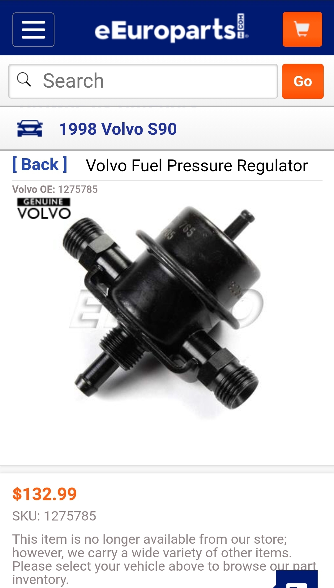

purplebeauty wrote: 22 Mar 2021, 12:22
0280160765
1275785
But then when we looked online, they were all "L" shaped and he wanted a "T" shaped one.
So my questions are:
  • does this sound like a FPR problem?
  • Any update on where I can find one of these things?
So everywhere I looks shows discontinued on that product. Eeuroparts still has a picture for reference. The only place I see it for sale is a sketchy site. I'll post the link. I dont know anything about the 2040-0arts site but it claims to have a new one. Other option would be junkyard hunting. Im not sure how the parts stores say those right angle L shaped ones are compatible. They are missing a hose connection.
http://www.2040-parts.com/new-genuine-v ... 5-i352077/

Super helpful post, thank you!
Yeah that's the right part!
Here's my updates:
So when I clicked on the "place order" link on the 2040-parts.com link, it said "part is no longer available."
I called eEuroparts.com to see if they had the part, and they said it was discontinued. I asked if sometimes a part like this will show up again and he said that parts get discontinued if demand is really low. And so the only option is find it used.
So looks like my only option is a junkyard at this point. Will keep you all updated. Let me know if you have any advice on the best Volvo junkyard in SoCal....

This is an update on the prior posting I made on January 13th, above. The part Iwas directed to, the Beck Arnely part is the incorrect part for the car (98 Volvo v-70 T5). It is the correct part if the FPR is located on the fuel rail. In my case the FPR is located over the steering box. Iam sorry for the confusion; I did not have access to the car at the time, and was misdirected after showing a picture of the engine and its fuel rail and fuel lines. To determine what you have for a FPR in your car you have to present the VIN. If I could get access to my previous posting, I would change it to reflect this. Thanks.
