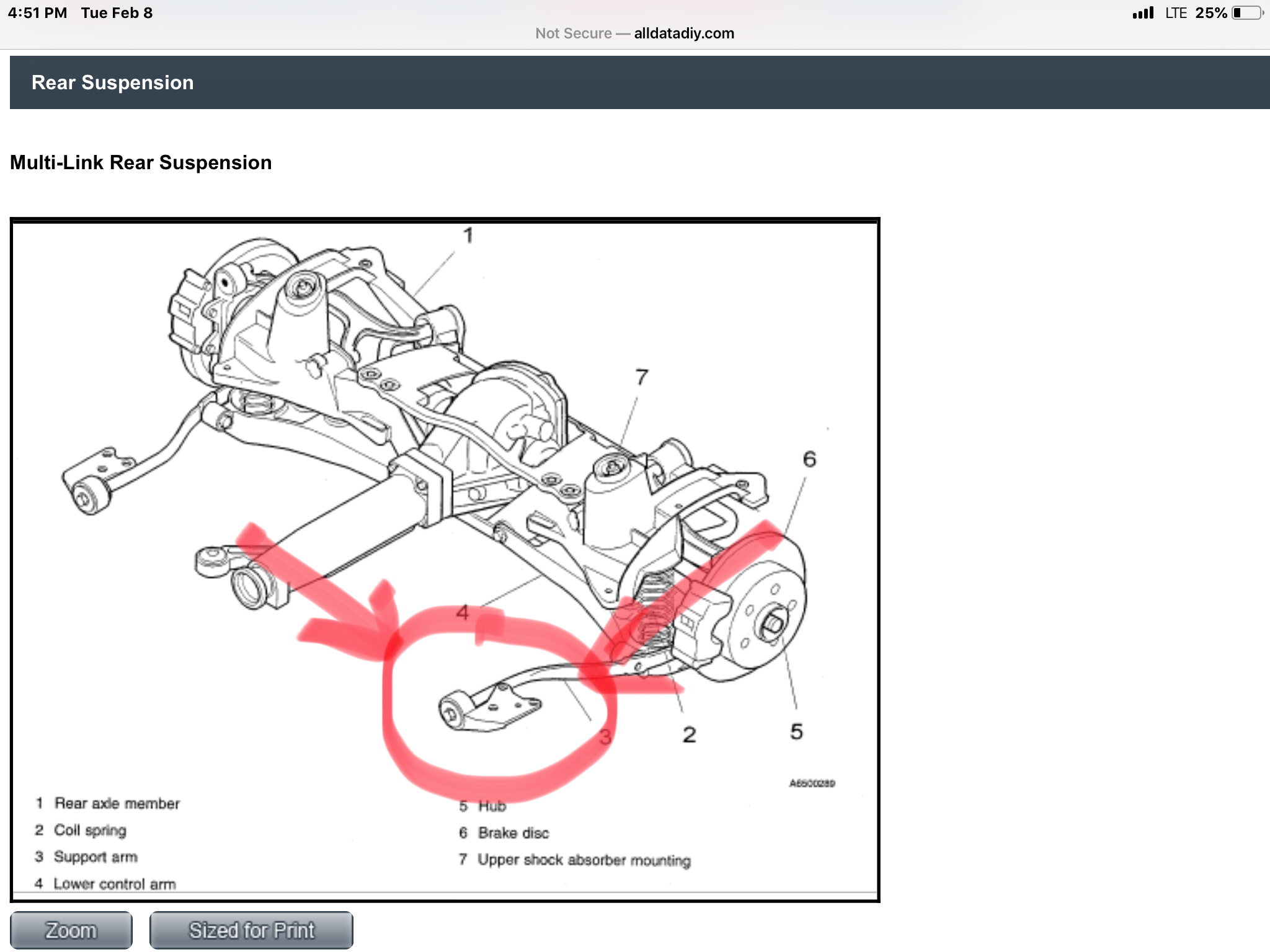

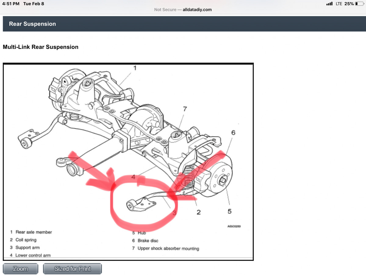

This is called a support arm in VIDA and a stay in the Volvo parts web store. It’s part number 9157302 and bolts to the rear axle carrier, the lower control arm, and the to the body forward with one long bolt up into the “ snout” and three shorter bolts thst also hold the jack point onto the car

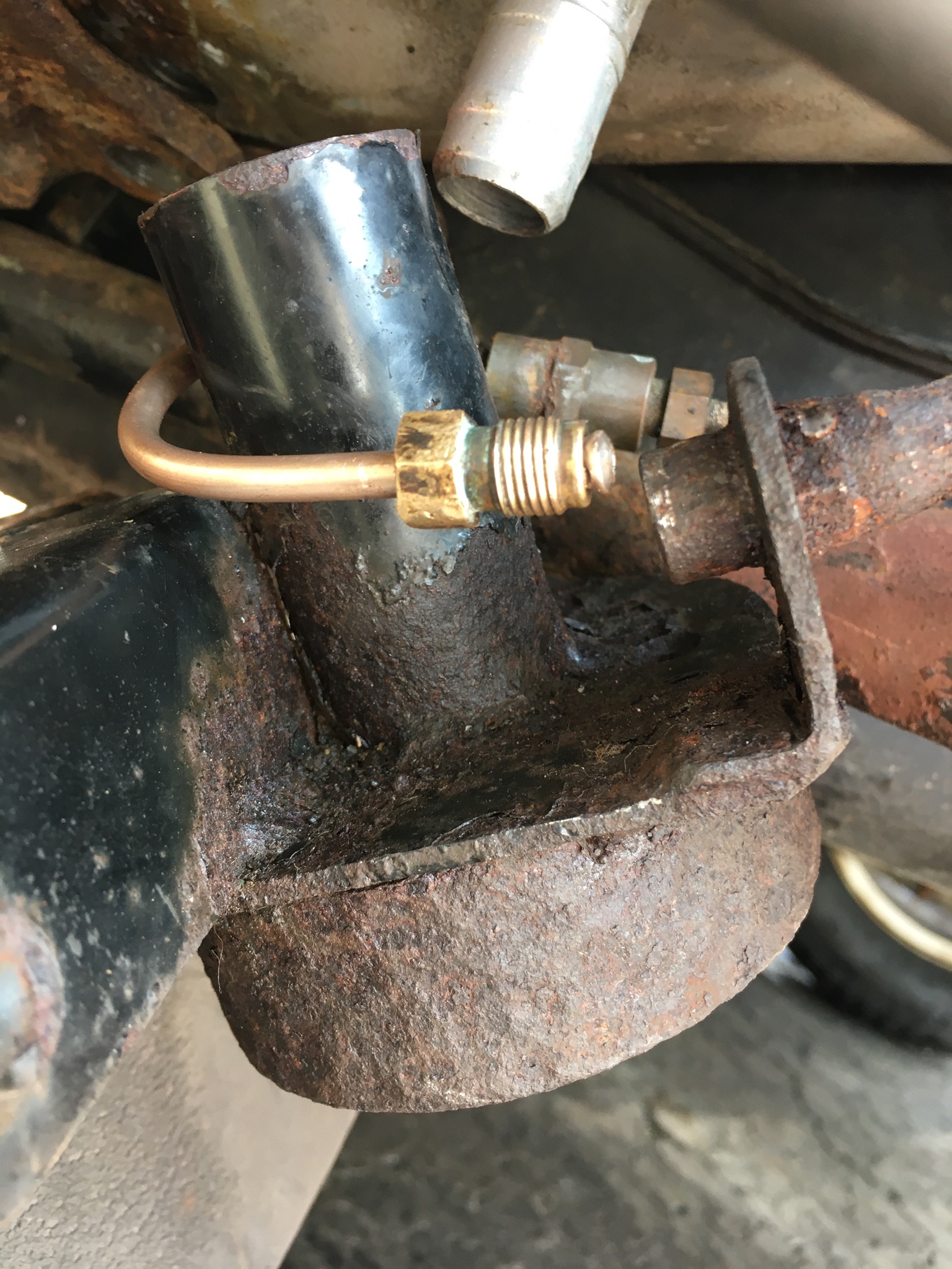

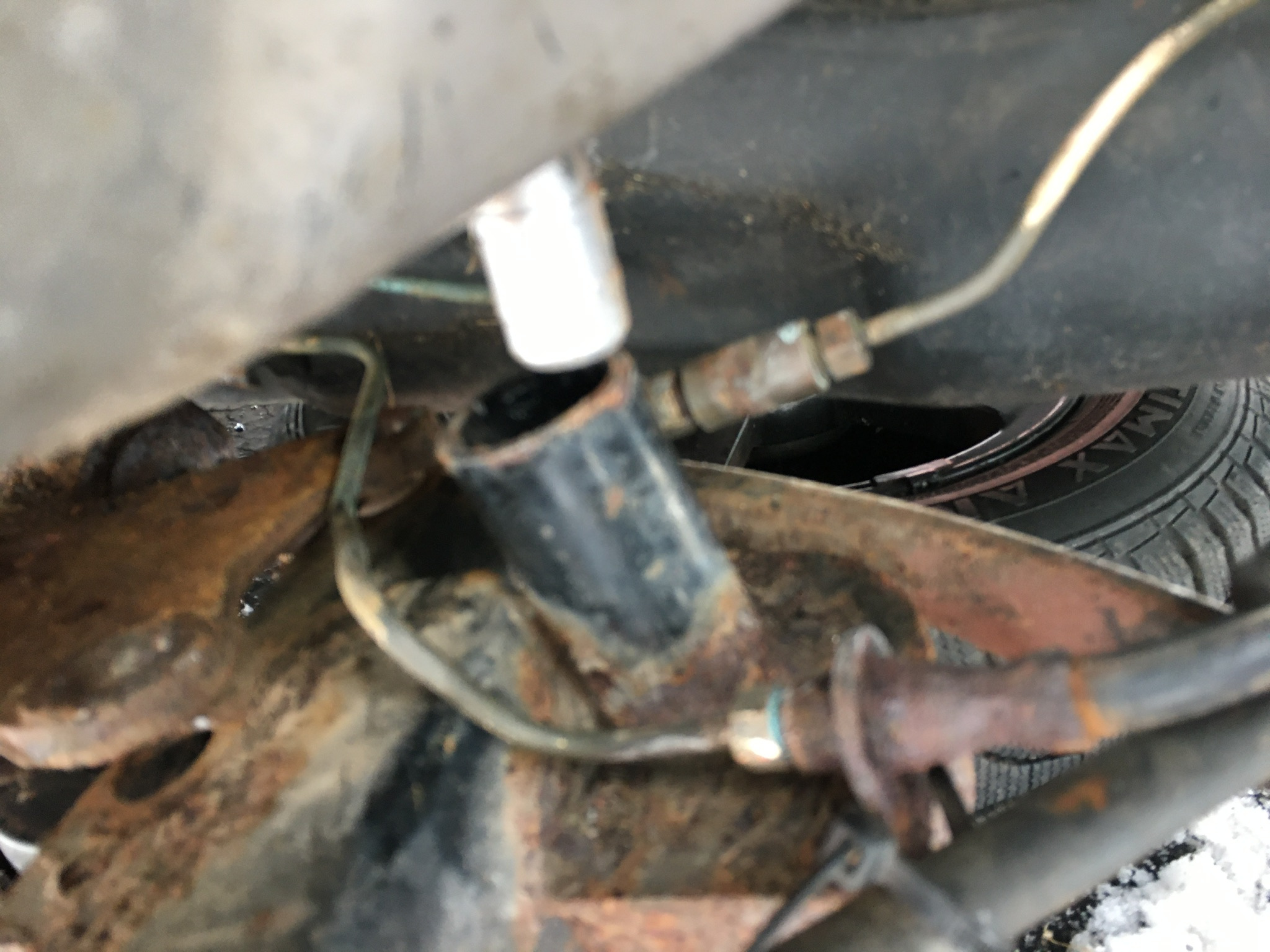

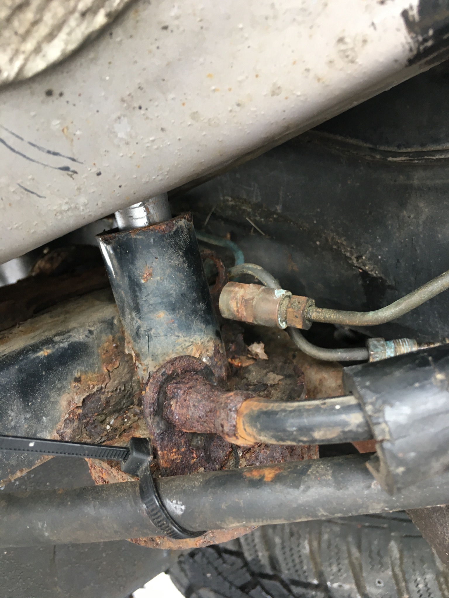

First, get the brake lines in the right place. See pictures. The hard lines go outboard of the main big poly and snout, the cross over brake line to the right side goes onboard.
The big snout bolt is easy to put in , but the plate and jack point bolts are tensioned inboard and are hard to lineup.
Find your self a long M14 and out the snout bolt in loosely. Now take the long bolt and get it in one of the plate bolts. Now use a screwdriver to pull the plate into position and get the bolts started. Once you have one in, run it down hard while prying the plate into position, the start the other two.

P80 AWD rear suspension control arm 9157302 installation tips

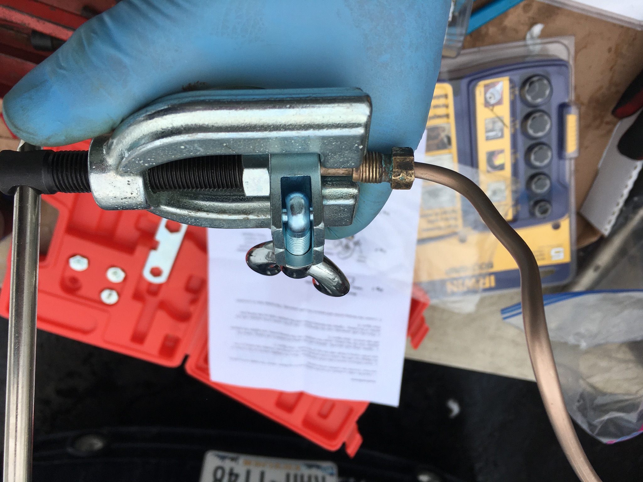

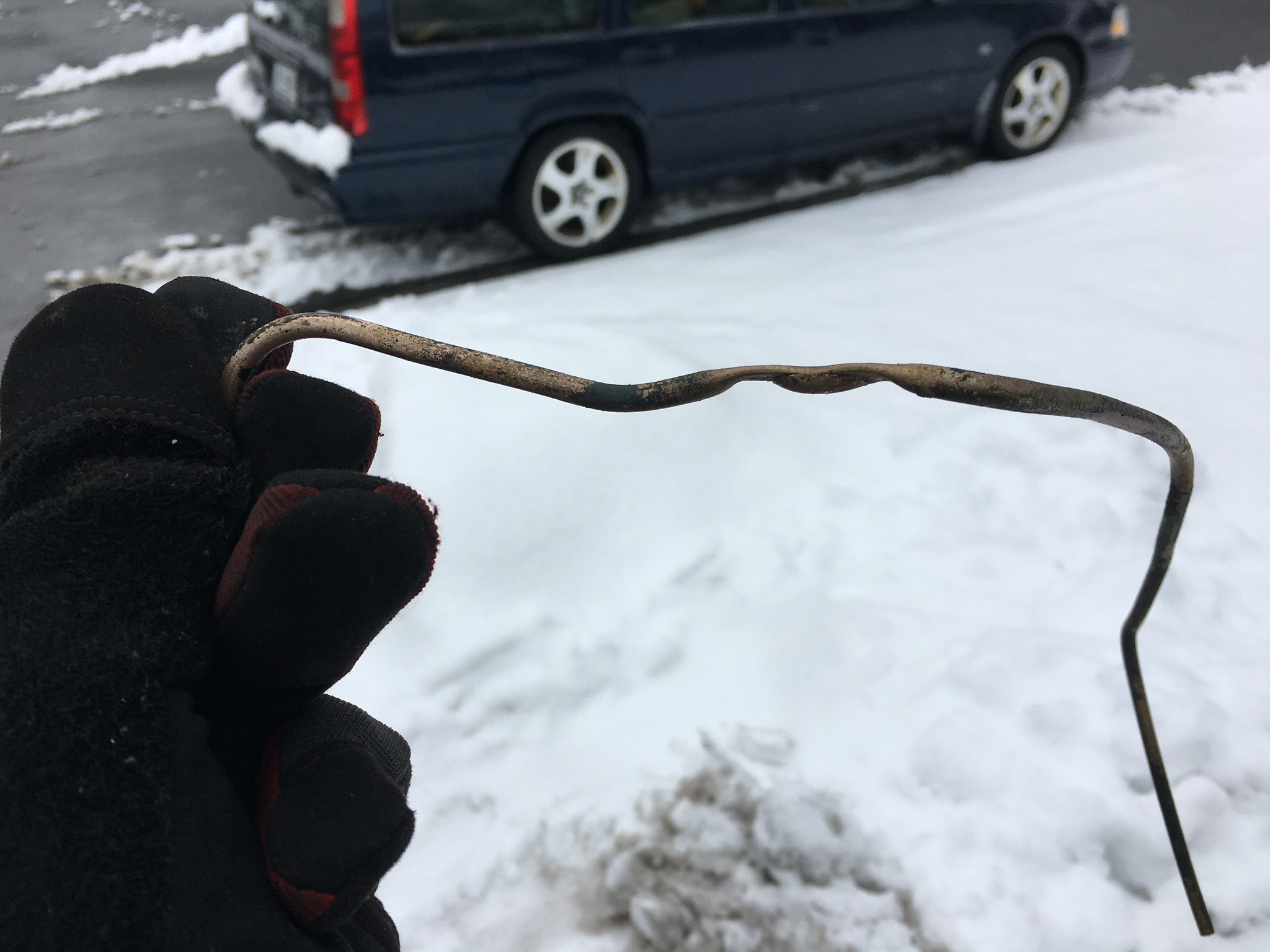

It’s even more important to not pinch the brake line between the torsion arm and body as you won’t be able to bleed the brakes. My cost per use of my new Neiko bubble flare kit just dropped again
New brake pipe 9438280 $85 from Volvo
2 feet CuNiFe brake line and fitting, $5 and free instant shipping!
The outboard swage is a bit tough to make up. You have to drop it that ugly 1/2-2cm, always a tough adjustment on a flare fitting as it has to
Line up perfectly. You can grab about 4-8 mm of bend with pliers in CuNiform pipe easily though
I had the thread referenced suspension parts off three times today fitting the brake line. If you fit the long bolt and the outboard bolt first, that seems to be the easiest combo to line up the other two

Ah, yes. Crimping the brake line. I believe that our friend bmdubya did a similar thing when swapping his rear suspension from AWD to FWD. It does tend to make the make brake bleeding a bit more challenging! Glad you found the issue and solution!

I had forgotten all the lessons of flaring lines but here is an important one
Measure your line length and cut it.
Now put your flare nuts on, right way please , and flare your ends. Now tape the nuts so they stay near the flared end
Once you start your bends , the nut will end up captive behind any bend and you have to start over
