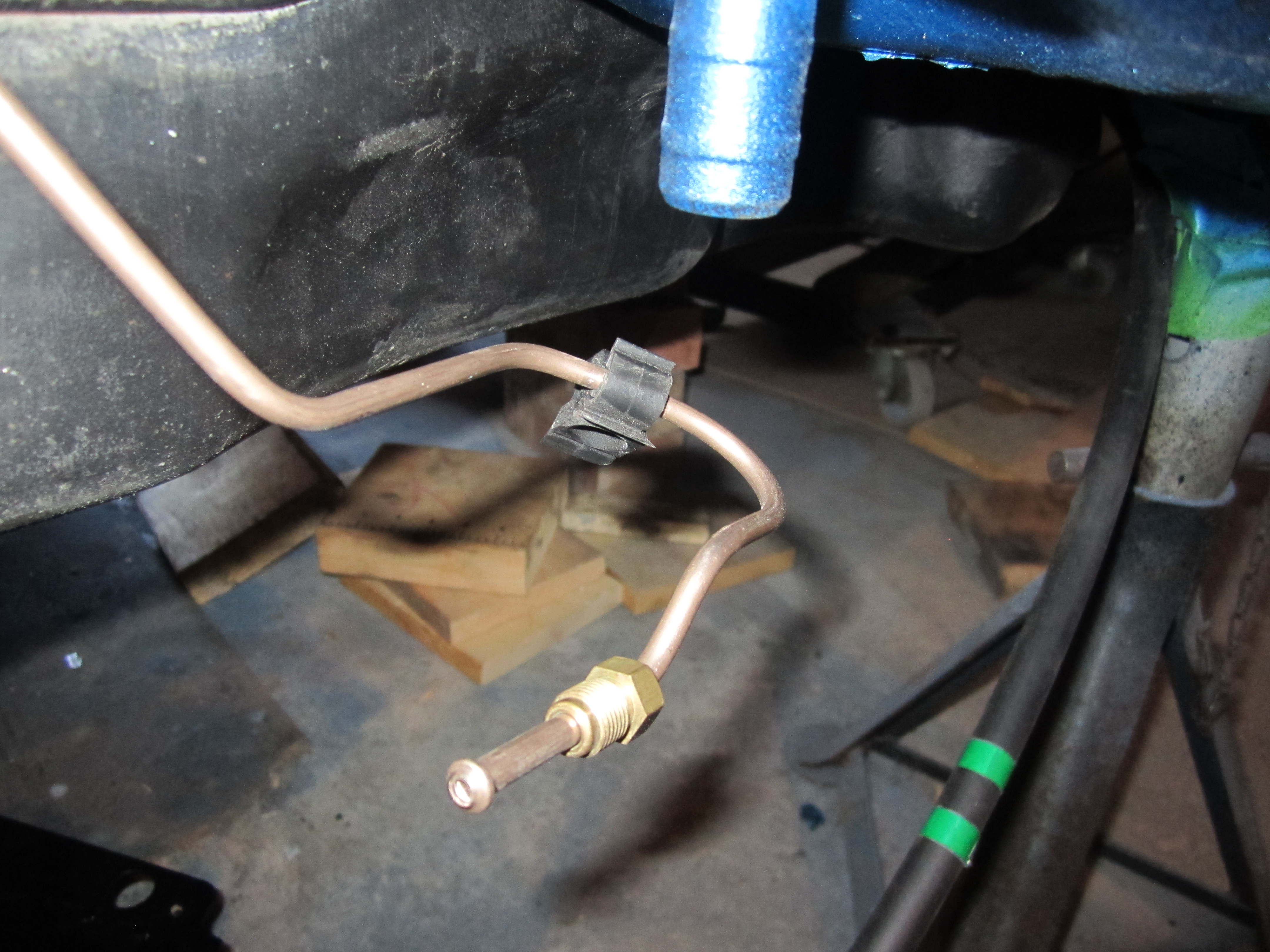

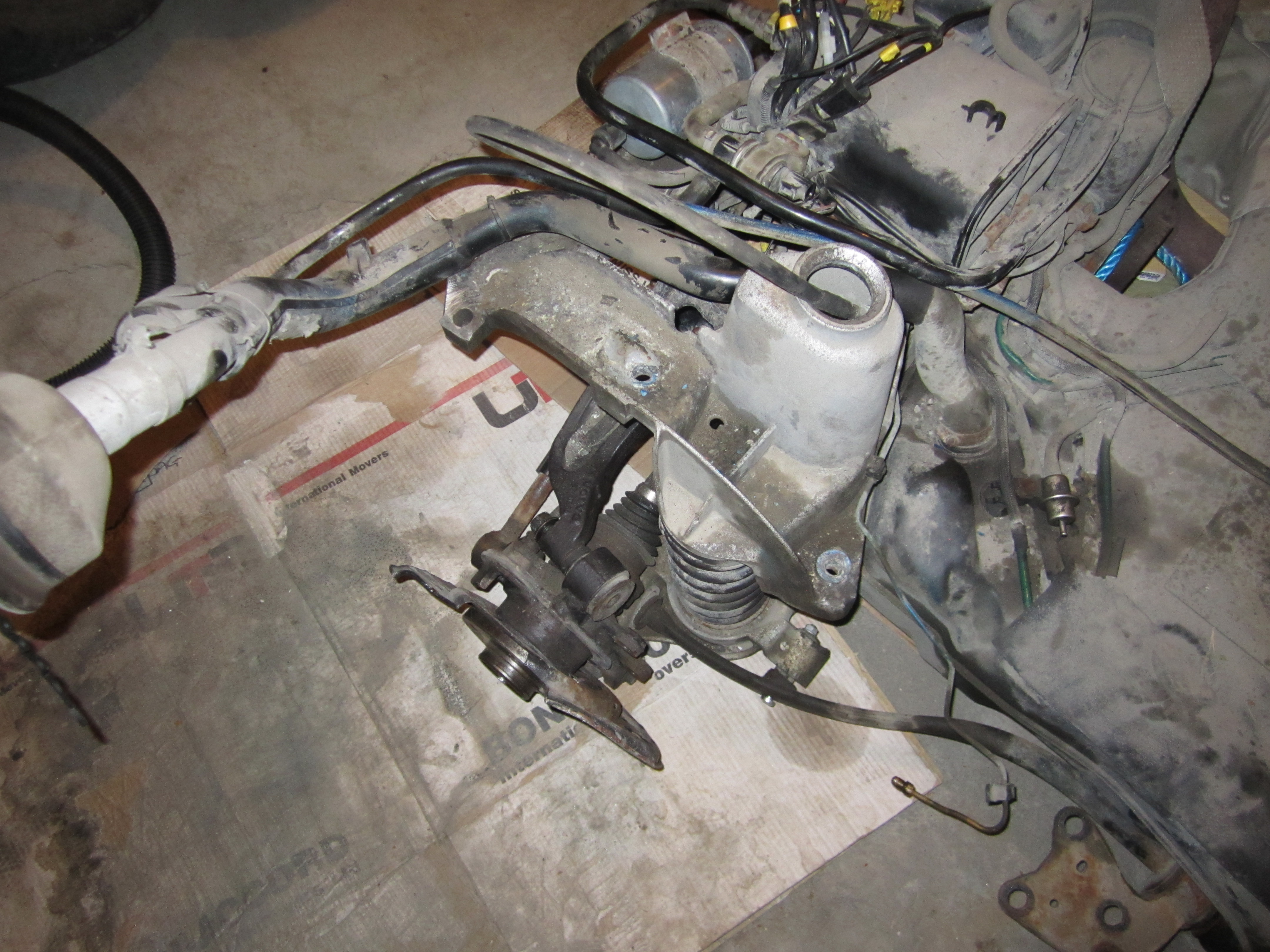

Just adding a couple of pictures to this thread as it may help down the line, Don't have any LHR pictures currently, I'll try to take some when I do the summer tire swap.
The pipe tales quite the journey from the LH side to the RH side along the front (inaccessible side) of the rear sub-frame. It is totally hidden by the rear of the fuel tank and it's hanger straps. When I had my sub-frame out I took a precaution and replaced this hard-line pipe due to the amount of corrosion we suffer from here in the winter.
AWD RR brake hard line
RH rear brake hard line 001.JPG (2.6 MiB) Viewed 332 times
AWD RR brake hard line (2)
Sub-frame out of 2000 V70R 005.JPG (3.05 MiB) Viewed 332 times
