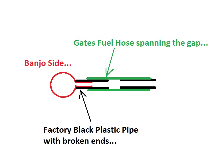

- Just broke the hard plastic hose on the 2007 S60 with 115K. I think during removal of the 17-mm banjo bolt,
the banjo side was twisted and broke, otherwise that hard plastic pipe seems to be fine.
- For now, I am using a Gates 4219XL (I.D. = 6.0 mm) fuel hose and slide over the broken ends. It is a tight fit and seems to be fine.
Anyway, this Gates hose is a Godsend. It fits perfectly.
And it is very thick-walled, I don't think it will collapse or blow under pressure.
- Does anyone know the highest pressure that a Turbo can generate for this hose?
- Here is a sketch of my current setup:

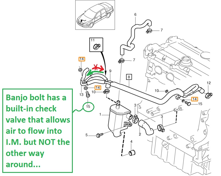

abscate wrote:...That line will be under pressure when boost is on, and under vacuum when the car is on overrun - just like the Purge system, Volvo designed a way to clear the PCV box under both conditions...
Hi @abscate,
I just want to clarify this point. I believe the plastic pipe only sees vacuum, not pressure.
I have a brand-new banjo bolt, so...
- The banjo bolt with check-valve. Some early versions had no check valve: not good bc boost can increase
crankcase pressure, which itself should be negative (under some vacuum), not positive pressure.
- The check valve is just a piece of steel that falls by gravity. Testing the new banjo bolt: when I suck
on the threaded end of the banjo bolt (the I.M. side), it allows me to suck air in. When I blow air into the threaded
end, it blocks the air flow bc the check valve falls down by gravity and blocks the air flow.
- To summarize it:
1. During normal operation or deceleration: the I.M. is under vacuum and it sucks air from crankcase
into I.M.
2. During boost, the I.M. pressure is positive, the check valve prevents air from entering the crankcase,
which makes perfect sense.
Anyway, this proves the point that a thick-wall fuel hose should be fine for the repair of broken plastic pipe.
I will use the fuel hose as a repair with some clamps over the broken ends of the plastic pipe.
This is a photo I sketched to show the flow of air in the PCV system: GREEN = normal flow; RED = boost phase ---> there is no air blowing back into crankcase.
HTH...

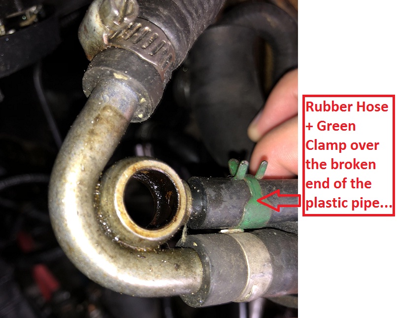

I borrowed a photo from Swedespeed forum to show the way people fix this problem:
- A hose spanning the broken ends of the hard plastic pipe.
- Here you can see a rubber hose + green clamp...
- For those who want to do this patch work of broken plastic pipe using fuel hose...
1. Gates 4219XL (look for hose with I.D. = 6.0 mm) is the ticket or any fuel hose with I.D. = 1/4 inches or ~ 6mm is fine. The O.D. of this hose will be ~ 12 mm.
2. The spring clamp you see in the photo below is available at Ace Hardware for $0.49/ea.
Look for "spring clamp for 7/16-inch hose" (which is designed for hose with O.D. = 11 mm).
The actual diameter of this spring clamp from the store is 10 mm, so it can clamp a hose with O.D. = 11 mm or 12 mm.
I tried and it works perfectly.

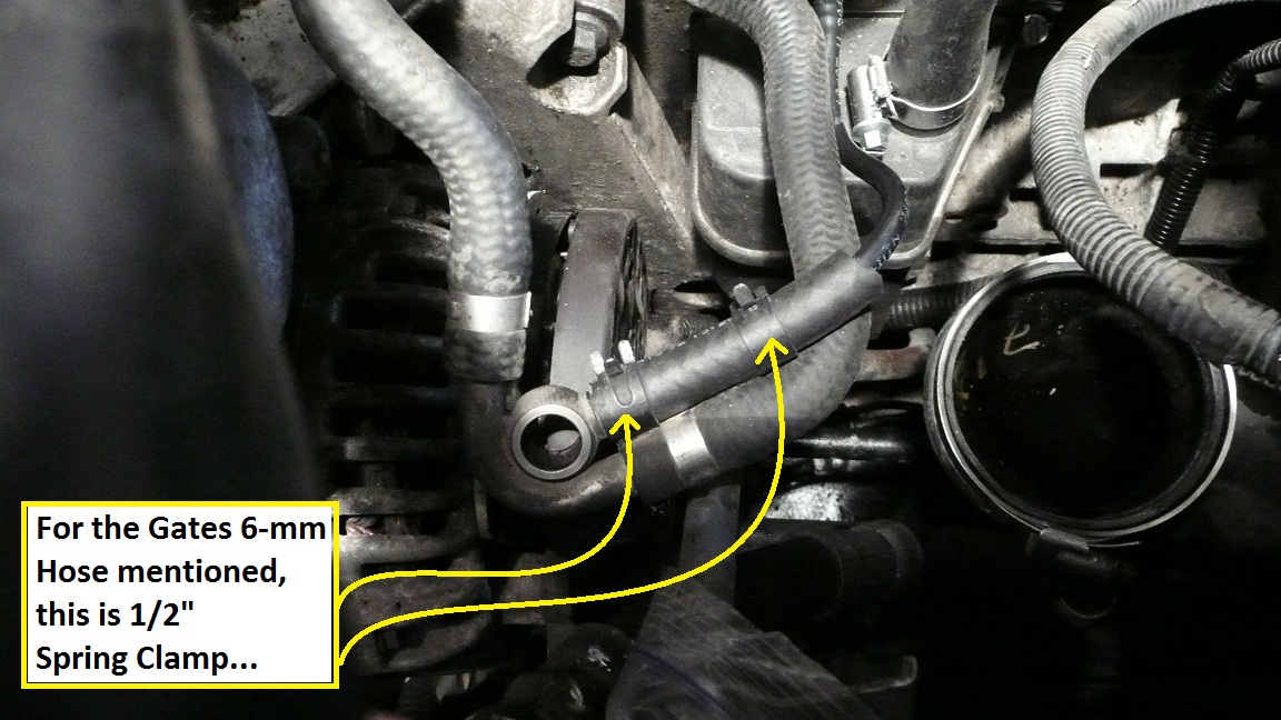

Minor update,
For the Gates Fuel Hose I mentioned above: Gates 4219XL with I.D. = 1/4" (~ 6 mm), the
spring clamp that works perfectly is 1/2-inch spring clamp as shown below.
Anyway, the size of the spring clamp depends on the O.D. of the fuel hose.
If the O.D. of your fuel hose is smaller, then use smaller spring clamp such as 7/16" type.
