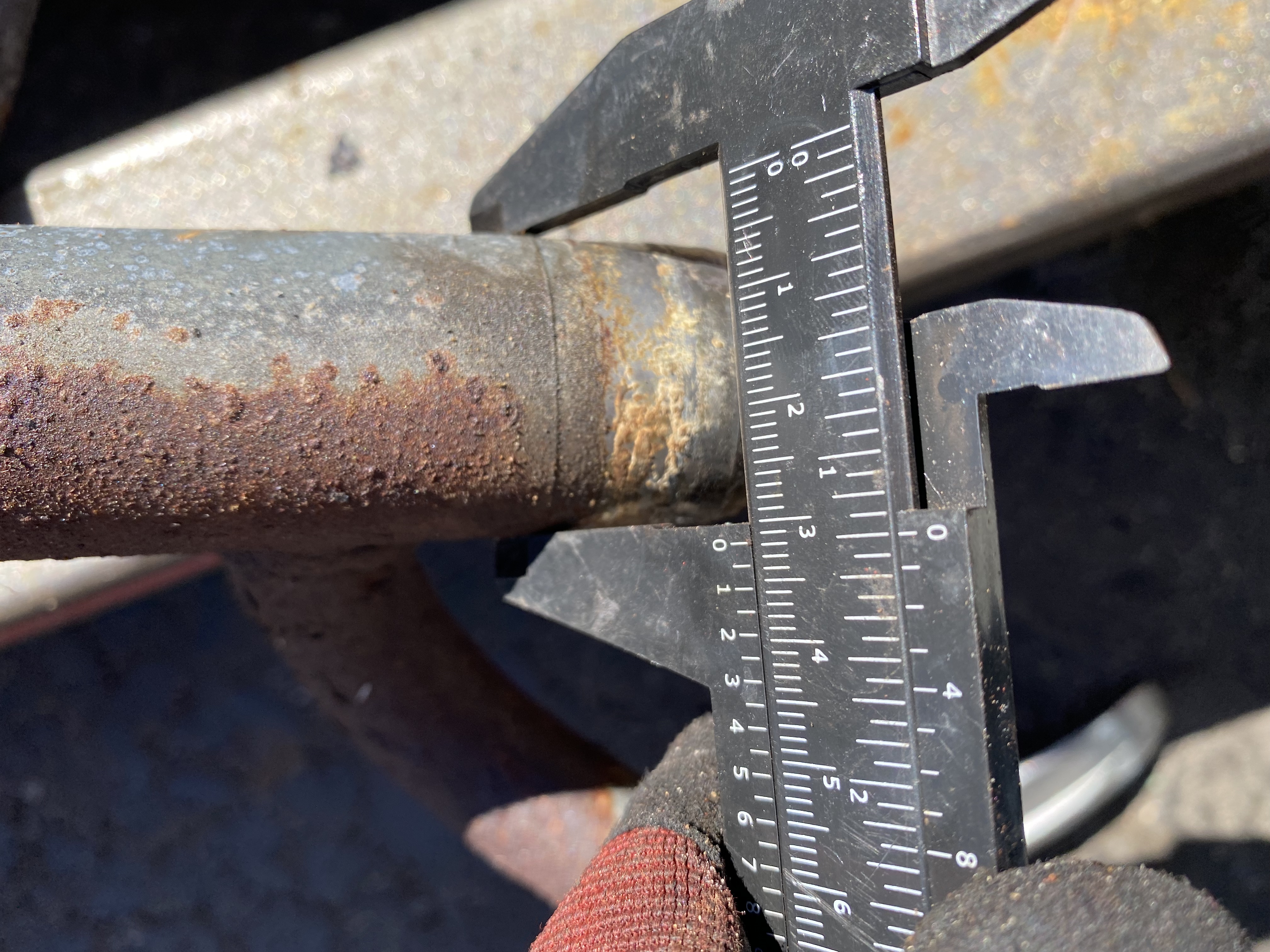

Just documenting the taper and chamfer on the water pipe here
- 575D6FD4-3542-461B-AEEB-588AF35E8077.jpeg (4.18 MiB) Viewed 430 times
- A07C12F9-10C8-4FAC-BC03-D931E050BE87.jpeg (3.49 MiB) Viewed 430 times
