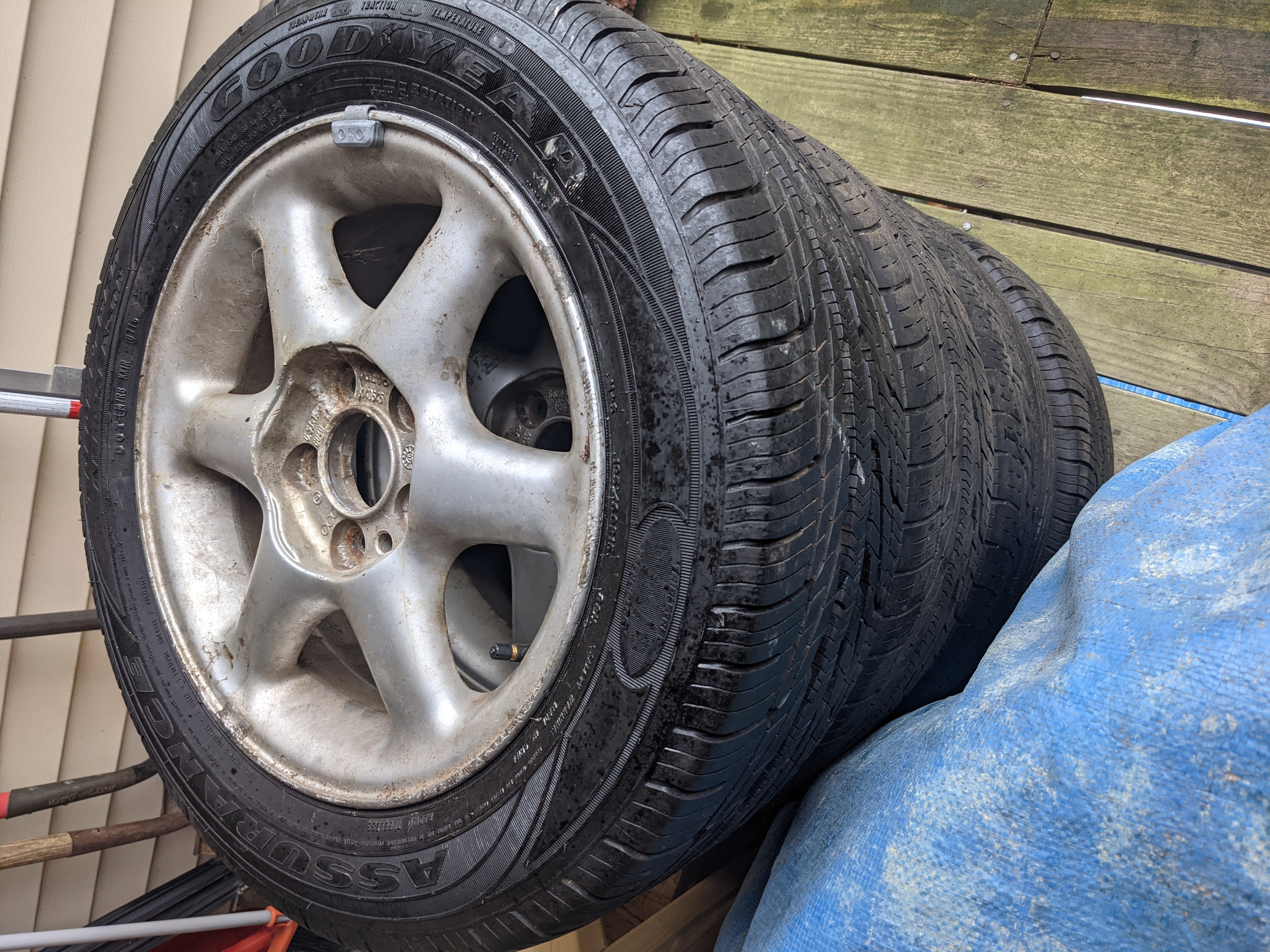

I just got a nice set of Cetus wheels for Geronimo and had its all-season tires mounted. The owner can leave the awesome Nokian studded snow tires on the original, beat up Antlia wheels. That will save $100 twice a year to swap tires on wheels, allowing that money to go toward improving the car.
When I started working on the car, the original Antlia wheel mating surfaces were terribly rusty from rusty wheel hubs (I spent hours cleaning those hubs). Thankfully the tire shop cleaned them up before mounting the Nokians (they probably had to in order to put them on the balancer). Still, the mating surface of one wheel was not level, allowing me to rock the wheel if not fully tightened. I'm glad to have these Cetus wheels since the seller pointed out that he had cleaned the mating surfaces. I'll install them in a few days and hope they fit well.
I'm proactively in the market for spare Cetus center caps. Though I have four for this set, I fear some will fall off.

off topic: who designes the cetus wheels? they are roundish, would fit a mazda 323f or a ford contour/mondeo. but a boxy 850?

In Europe around the early 90's that style of wheel was fairly common. I had something similar fitted to my Vauxhall Carlton 3000 GSi as aftermarket wheels to replace the horrid OE wheels: This is what the car looked like, but not the wheels. They were a 6 spoke rounded spoke wheel like the Cetus:
