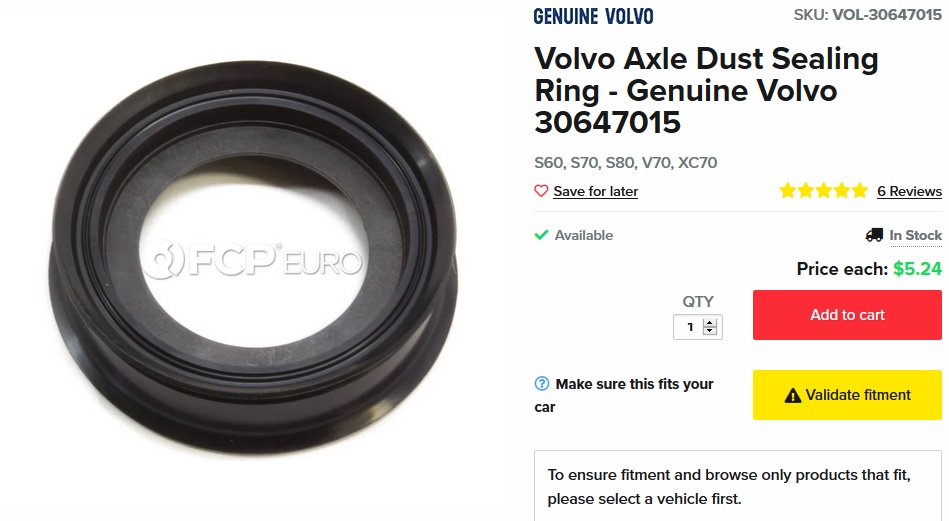

Thought bringing back this thread, this is the seal in question, it actually keeps dirt from getting at the wheel bearing - the bearing is sealed but if this dust seal is missing, the bearing will wear prematurely (not a fun job). I believe it goes with the larger side on the CV joint - it should fit tight over the side of the CV joint any way, not loose.
https://www.fcpeuro.com/products/volvo- ... 15#reviews

I believe the P80s didn’t come with the seal but you should add it whenever the axle is off

My 2000 V70XC has them.

I just changed this on my 2000 v70 R. I removed the axle when doing my engine rebuild and never replaced the seal, now this wheel bearing went bad. Not sure if its due to the missing seal or just 160k miles.
Anyways I bought the seal on europarts.com along with my wheel bearing. It was 5$, part number is 9492980. I'm sure it will help protect the bearing and the splines on the axle where the abs wire reads.

The wheel bearing dust shield fits over the end of the axle. The attached picture shows the orientation on a 2000 V70 NA automatic front right axle. It can only fit on the axle one way because only one side's opening is big enough.
On rusty, neglected Geronimo, a hard and cracked dust boot still kept the inner surface of the wheel hub clean enough that I could read the manufacturer name and country of origin. That hub still failed, but the car has 357k miles and I have no idea how old it was. On the other hand, a bearing I took from a junkyard with maybe 130k miles did not have a seal. The inner surface was dirty enough that I could barely see the manufacturer and country. However, that hub worked fine once installed.
For $5, it seems like cheap insurance to help protect this expensive and important part.
