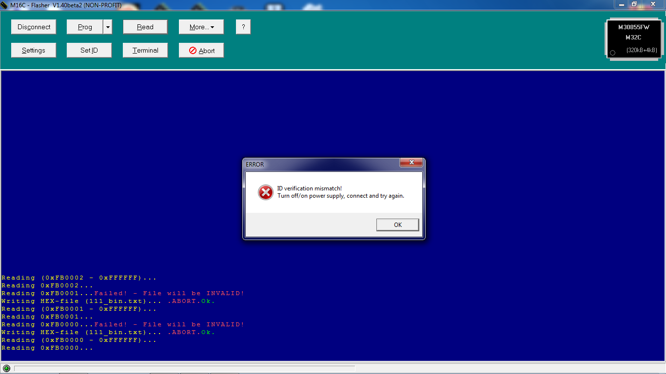

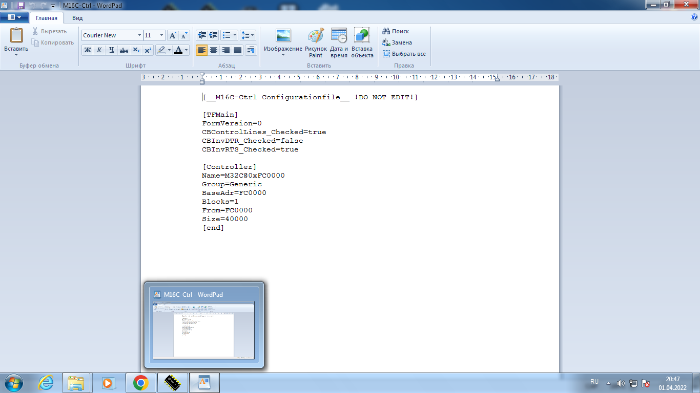

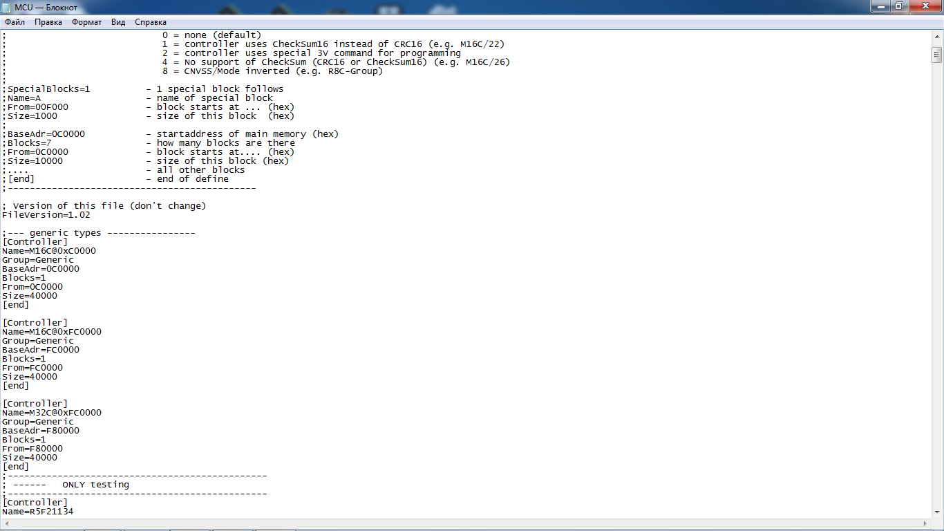

Of course, I don’t understand much, but I already admit the option that the program allows you to read a 256kb processor, and in my case a 320kb processor M30855FW
MAX389
Posts: 7
Joined: 1 April 2022
Year and Model: XC90 2006
Location: TUMEN
Post by MAX389 »
and according to the table it turns out to change only the starting address, the volume remains unchanged
MAX389
Posts: 7
Location: TUMEN
Post by MAX389 »
Sorry, I made a mistake with the file size, it can be changed

I changed it, and there's no point. I noticed that when reading, the program always shifts all addresses by one bit.
[Controller]
Name=M30855FW
Group=M32C
BaseAdr=FB0000
SpecialBlocks=1
Name=A
From=00F000
Size=1000
Blocks=10
From=FB0000
Size=10000
From=FC0000
Size=10000
From=FD0000
Size=10000
From=FE0000
Size=10000
From=FF0000
Size=8000
From=FF8000
Size=2000
From=FFA000
Size=2000
From=FFC000
Size=2000
From=FFE000
Size=1000
From=FFF000
Size=1000
[end]
