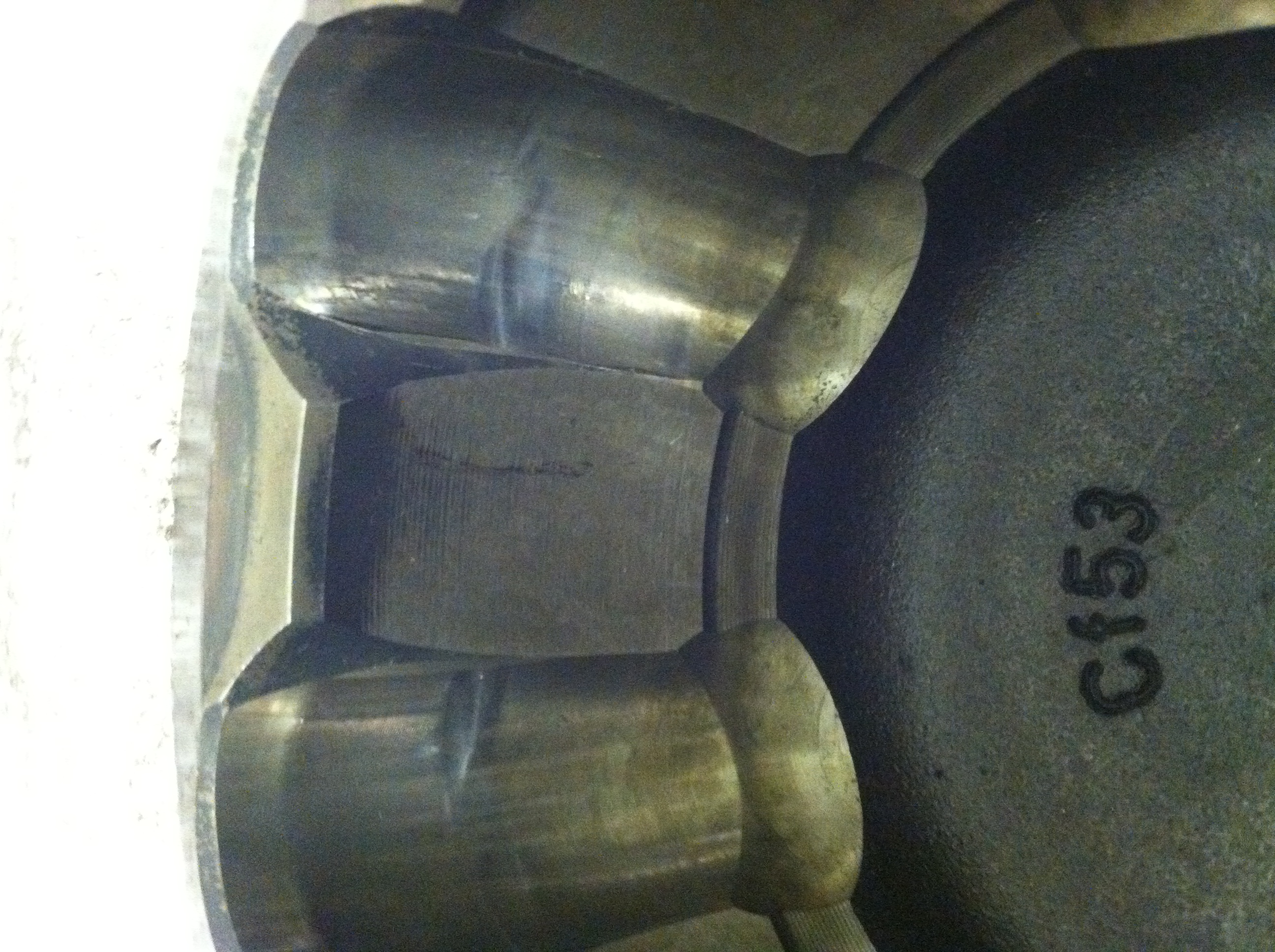

Never judge a book...
What a shame.
It still has a white Volvo part label on it, the rest of the shaft is perfect. The previous owners just didn't fix the boot when it failed.

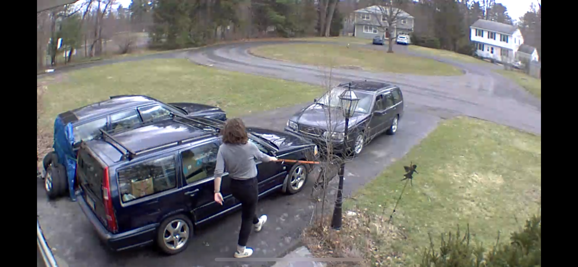

Hosted the Nautic Blue P80 convention….
- Posts: 15499
- Has thanked: 2205 times
There is way too much empty space on that driveway that could be filled with more nautic blue cars!!

Right? That's what I was thinking!scot850 wrote: 02 Apr 2022, 10:03 There is way too much empty space on that driveway that could be filled with more nautic blue cars!!![]()
