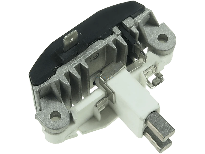

I was finally able to improve the charging on the S70 / V70 / 850.
The original
Original regulator
Original regulator

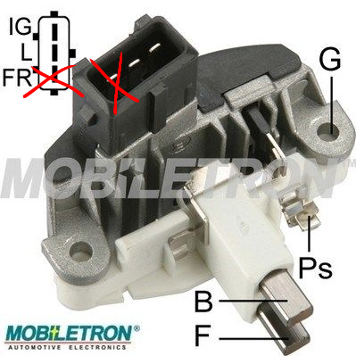

regulator charged max 14.1V on the battery, but on average below 14V. I used a regulator from BMW, which looks similar to the factory Volvo.
BMW regulator
BMW regulator
It differs in the connection, so you need to add one wire from the ignition supply to the first pin marked "IG". Of course, the original excitation "L" cable is connected to the second pin marked "L". The third "FR" is not connected (it is the output from the regulator informing about the alternator load). Of course, because of the plug, you have to enlarge the hole in the plastic cover.

radek93 wrote: 02 Apr 2022, 13:15 I was finally able to improve the charging on the S70 / V70 / 850.
The original Untitled7_20220402210811.png regulator charged max 14.1V on the battery, but on average below 14V. I used a regulator from BMW, which looks similar to the factory Volvo. Untitled6_20220402203836.png It differs in the connection, so you need to add one wire from the ignition supply to the first pin marked "IG". Of course, the original excitation "L" cable is connected to the second pin marked "L". The third "FR" is not connected (it is the output from the regulator informing about the alternator load). Of course, because of the plug, you have to enlarge the hole in the plastic cover.

You need to remove the rear plastic cover of the alternator. Then you will see the original regulator as in the first photo. You assemble the regulator from BMW and add the cable as described. Unfortunately, it is impossible to convert the original regulator so that it charges more. Adding a diode to the ground circuit causes only no charging. It is a regulator with 8 bit IC. I don't know where he gets the test voltage. With the regulator from BMW, you can theoretically regulate the charging voltage up by the voltage drop on the cable you add as described. I just don't know why if it is around 14.5V on the battery.

radek93 wrote: 02 Apr 2022, 13:15 differs in the connection, so you need to add one wire from the ignition supply to the first pin marked "IG". Of
I’m really bad with electrics. Does anyone know what wire from the ignition supply this is?
