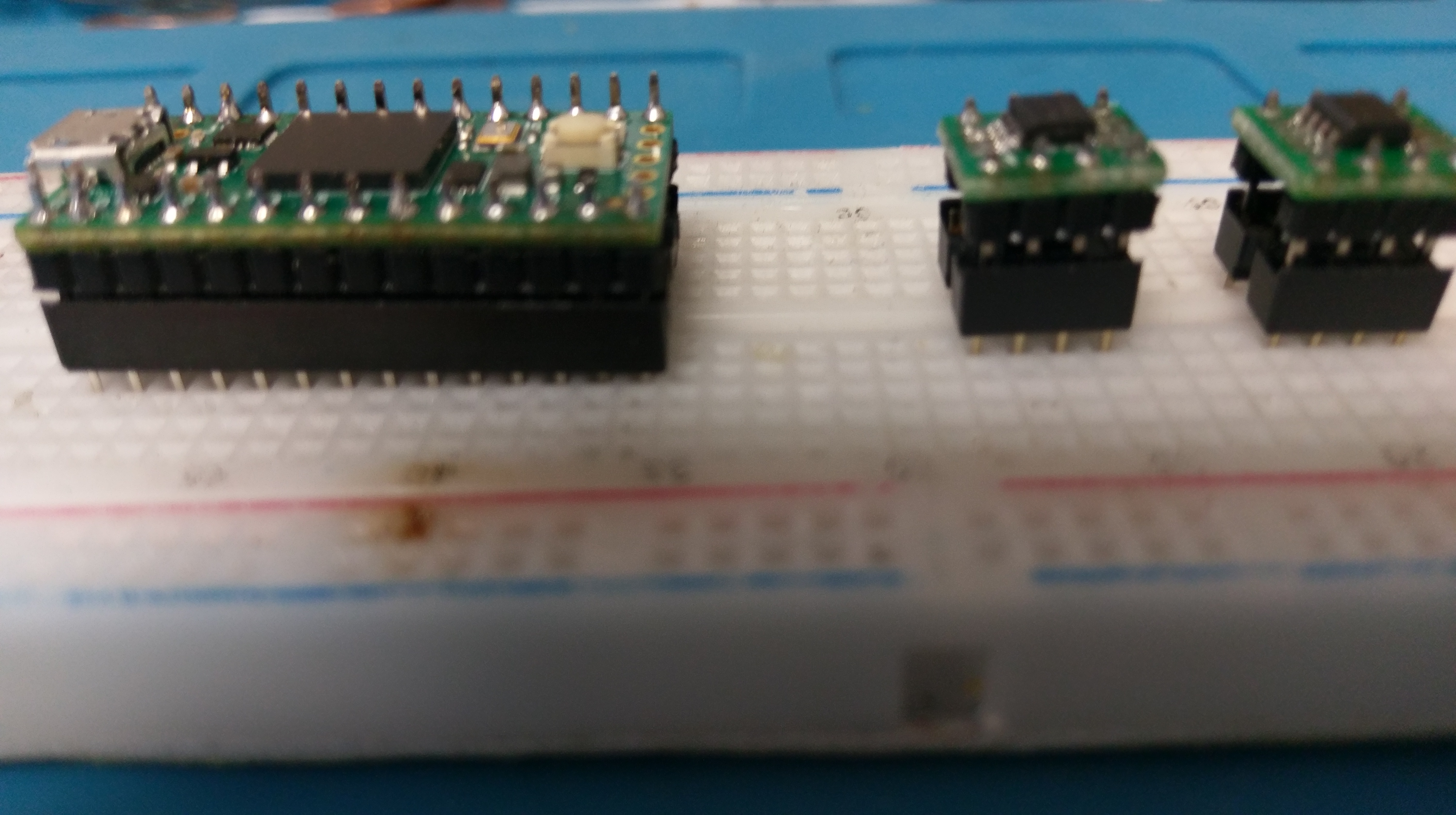

Just realized the Teensy 4.0 fits a Wide 28 Pin DIP socket. Useful if you want to reuse the Teensy 4.0 for other projects.

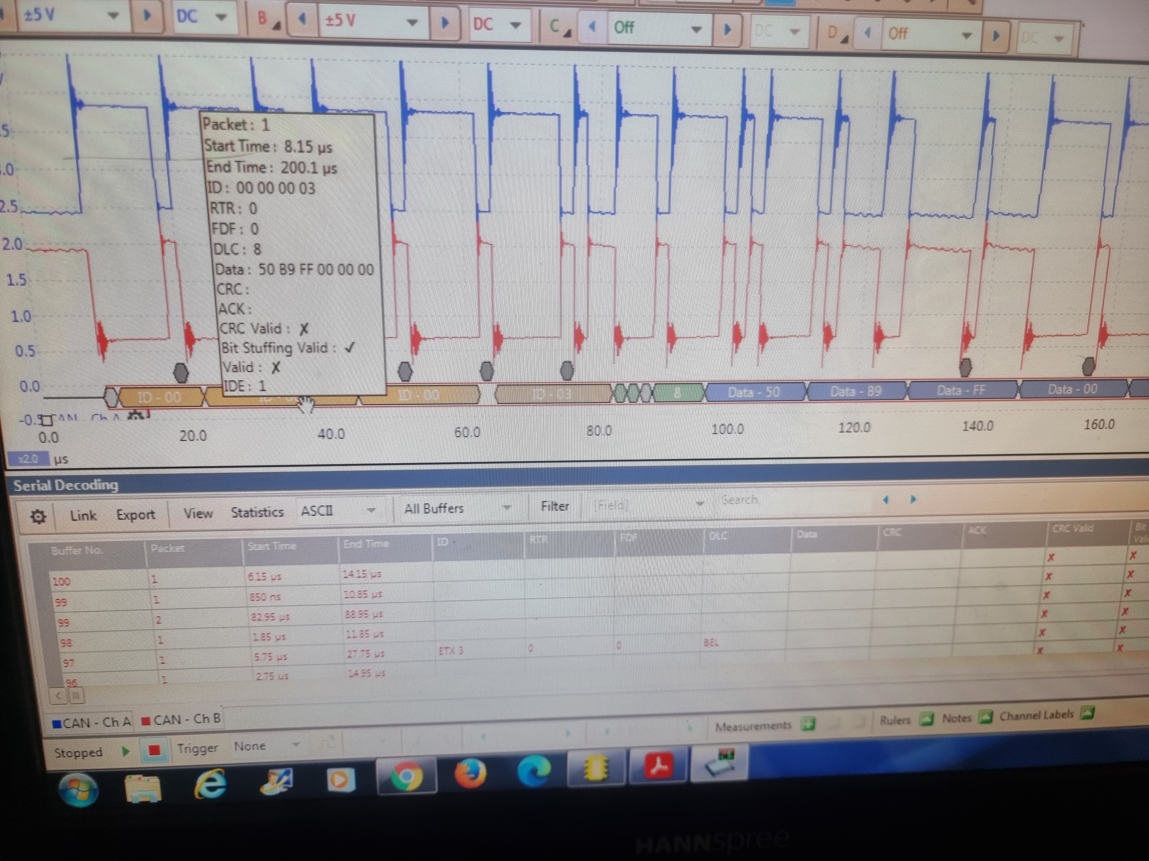

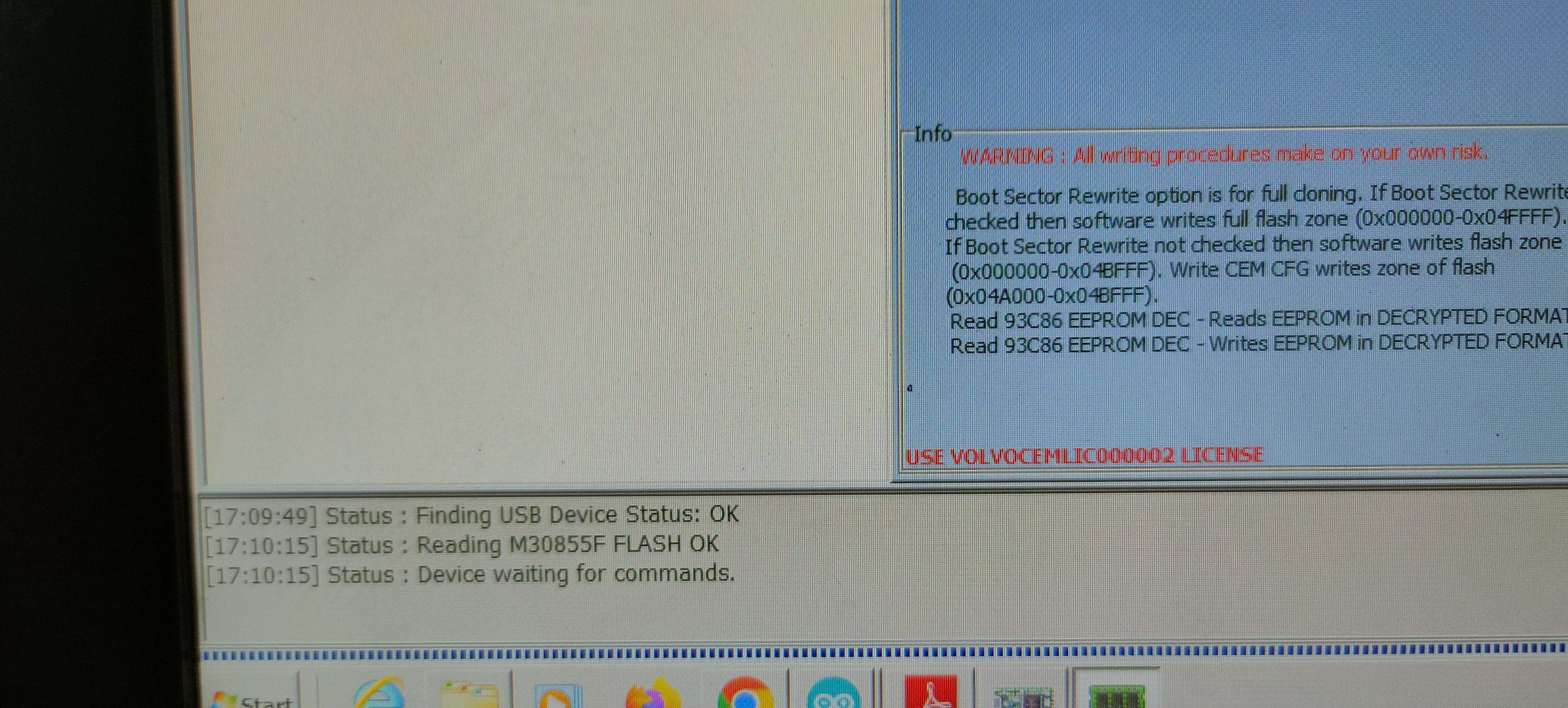

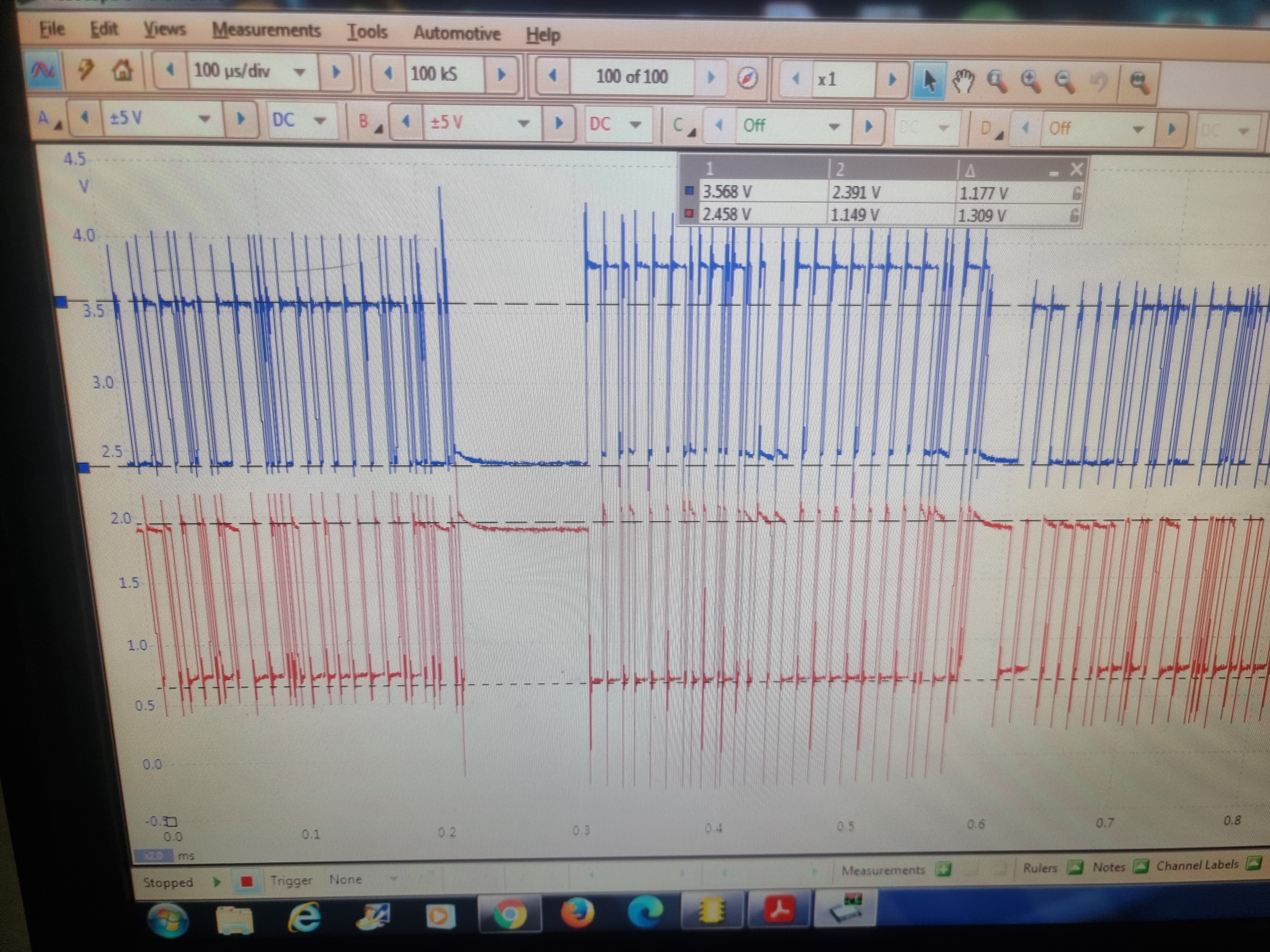

Update:
The transceivers I ordered finally arrived yesterday and I managed to have another try this morning. Both CEM cracked successfully using HS and LS CAN both connected on the vehicle and just HS on the bench (with the 120 ohm resistors still fitted to the transceiver board for CAN (which I was going to remove, but forgot in my rush to try it))
My original 10kohm jumper connection wasn’t great and the transceiver that I was using from an old pcm was a 4.5 volt minimum voltage, so the Teensy may not have been driving it correctly? Although it did decode the part number previously each time and got the first two bytes correct a few times too, so it was probably just my poor connections and maybe the lack of LS CAN not being connected and silencing it.
Thank you vtl and RickHaleParker for your hard work

The two CEM-L I have been using both seem to stay ready to communicate whenever. In the vehicle I could just connect and the programme would start identify and run without any ignition key input and even with the door switch state not changing. I know some vehicles wake the CAN up as soon as a door is opened or a proximity remote is detected.
I left the one on the bench this morning and forgot to turn off power to it and it connected straight away as soon as the programme started when I reconnected to take the scope captures.
The part numbers of the ones I have are 30728542.
