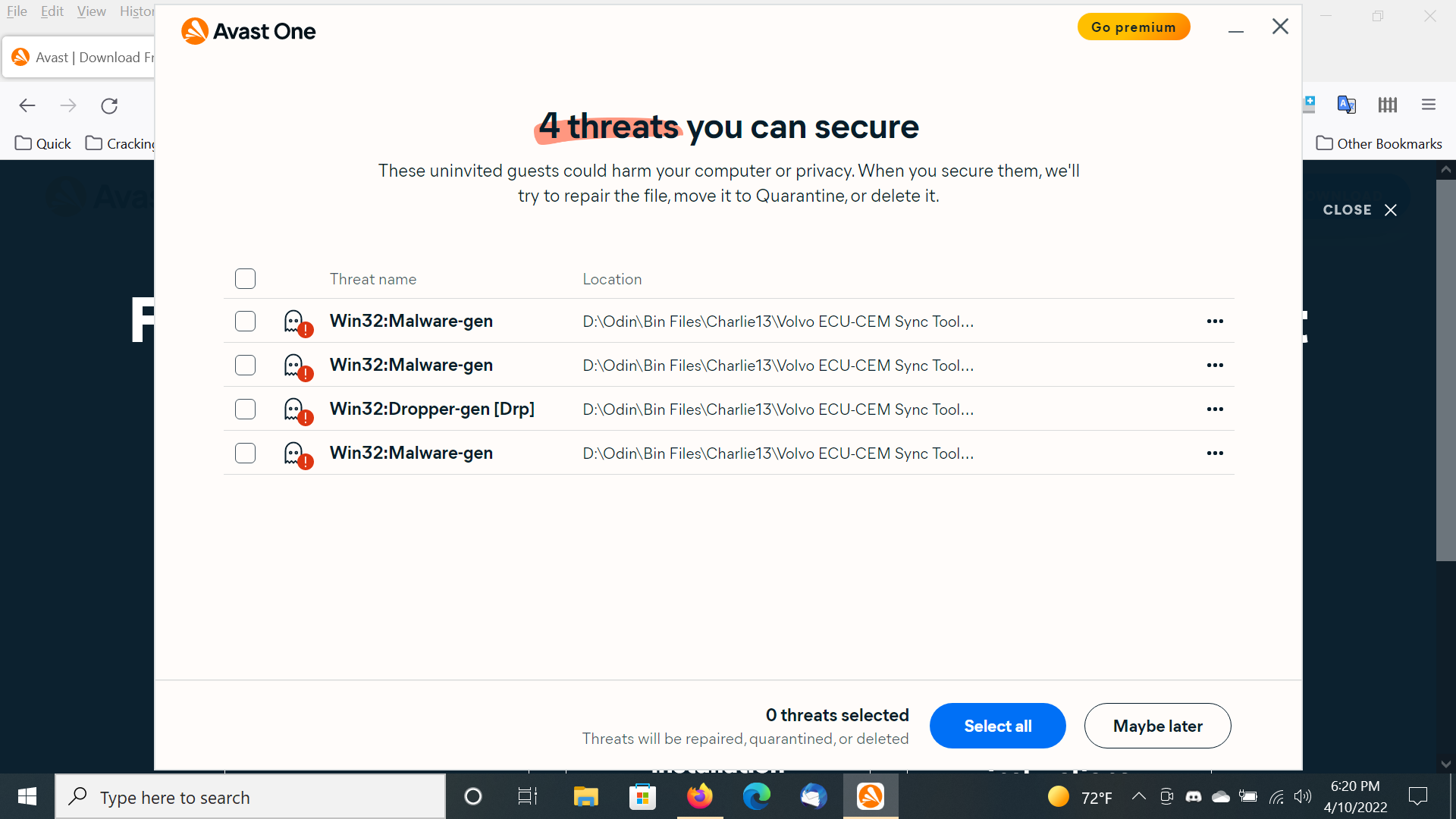

Ran it through three different virus checkers all three say it is infected.
My checkers pick then up after the file is unpacked.

I'm sure there are no viruses there. I've been using these programs for a long time. The crack that was used to unlock the software is detected by the antivirus as a threat. Run the system in a virtual machine and check if anything gets infected.RickHaleParker wrote: ↑10 Apr 2022, 17:23Ran it through three different virus checkers all three say it is infected.
