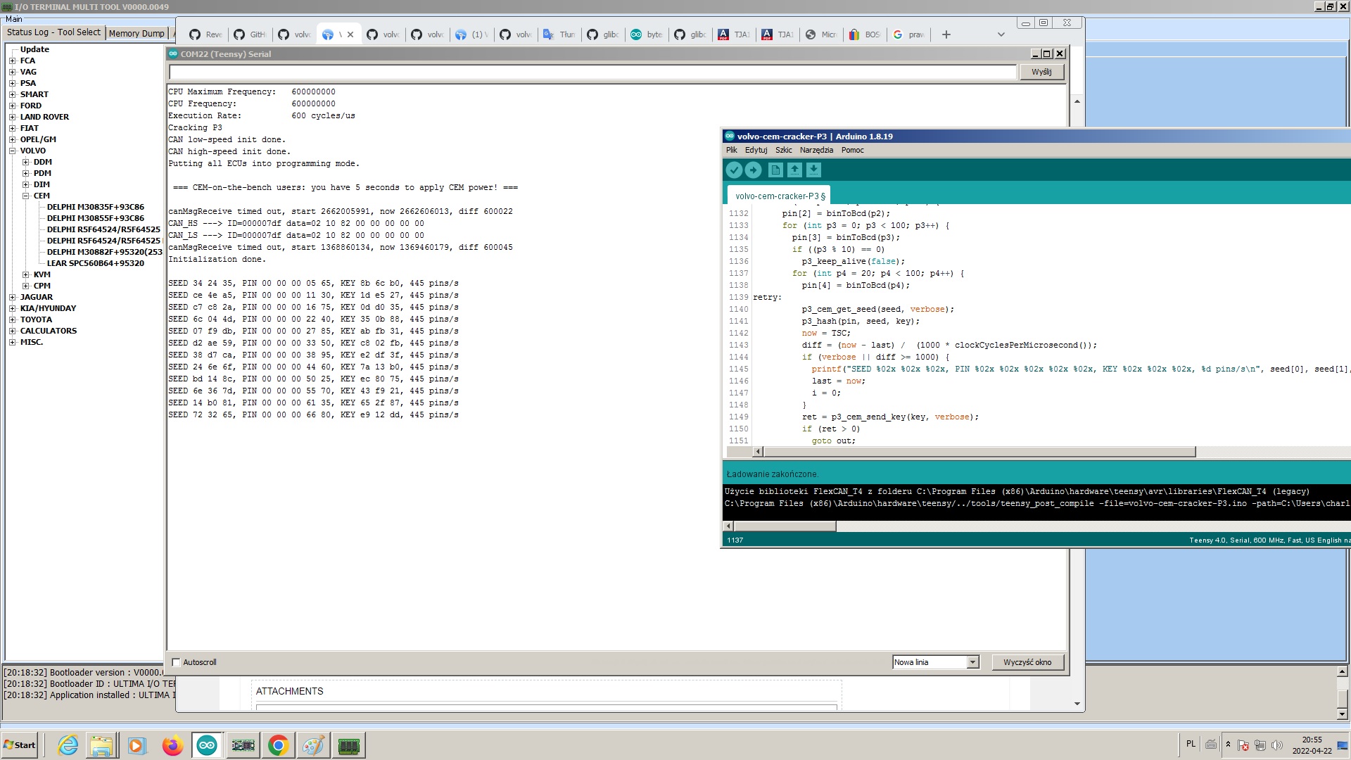

You don't need that tool unless you are investigating ways of speeding up the P3 hash collision.charlie13 wrote: 22 Apr 2022, 07:58 Thank you for your answer. I have all the diagnostics on windows. I don't have linux.

I have 11 hours and nothingcharlie13 wrote: 22 Apr 2022, 03:29Yes. I need a pin for I/0 but SMOK has limited functions. For this, teensy 4.0 complements the I/0 functionalityurosm wrote: 22 Apr 2022, 01:15But with I/O Terminal you don't have a crack CEM PIN, right?charlie13 wrote: 21 Apr 2022, 06:12
Still counts. I have a UHDS and an I / 0 terminal. UHDS counts slowly, I / 0 terminal does all CEM P1, P2, P3, SPA. That's why I / 0 is the better tool for me.
Just use it to read CEM flash and eeprom thru OBD, but first, you must find the PIN...

The worst case would be a hit with pin 00 99 99 99 99, which would take almost 63 hours at your speed.charlie13 wrote: 22 Apr 2022, 10:20 I have 11 hours and nothing

Murphy's Law
Such events are normal?

canMsgReceive timed out, start 3301685844, now 3901685895, diff 600000051
p3_cem_get_seed: ugh...
CAN_HS ---> ID=00000726 data=ff ff ff ff ff ff ff ff
CAN_HS <--- ID=0000072e data=05 67 01 7a f2 ad 00 00
SEED 7a f2 ad, PIN 00 20 34 48 00, KEY a0 4c 3e, 386 pins/s

reply: 02 67 02 00 00 00 00 00
hash collision found
SEED 6a f4 bb, PIN 00 21 86 28 06, KEY 63 44 9a, 111 pins/s
Resetting all ECUs.
CAN_HS ---> ID=000ffffe data=ff c8 00 00 00 00 00 00
CAN_LS ---> ID=000ffffe data=ff c8 00 00 00 00 00 00
GAME OVER !

Sort of. Ugh is ughcharlie13 wrote: 22 Apr 2022, 11:09 Murphy's Law
SEED ce 21 ca, PIN 00 20 34 35 24, KEY 1b ab eb, 445 pins/s
SEED 7c 11 48, PIN 00 20 34 39 69, KEY 86 2a 9b, 445 pins/s
SEED 2e c3 c8, PIN 00 20 34 44 14, KEY 29 6a 32, 445 pins/s
You can start with PIN 00 20 ..., set p4 iterating from 20 here: https://github.com/vtl/volvo-cem-cracke ... .ino#L1137

CEM with us are cheap from $ 8 to $ 150. I can send. I think I am doing something wrong because it starts from the beginningvtl wrote: 22 Apr 2022, 11:33Sort of. Ugh is ughcharlie13 wrote: 22 Apr 2022, 11:09 Murphy's Law
p3_cem_get_seed: ugh...I haven't played much with P3. They (CEMs) are expensive, and it looks like I have to buy all those varieties in order to bullet proof the code.
