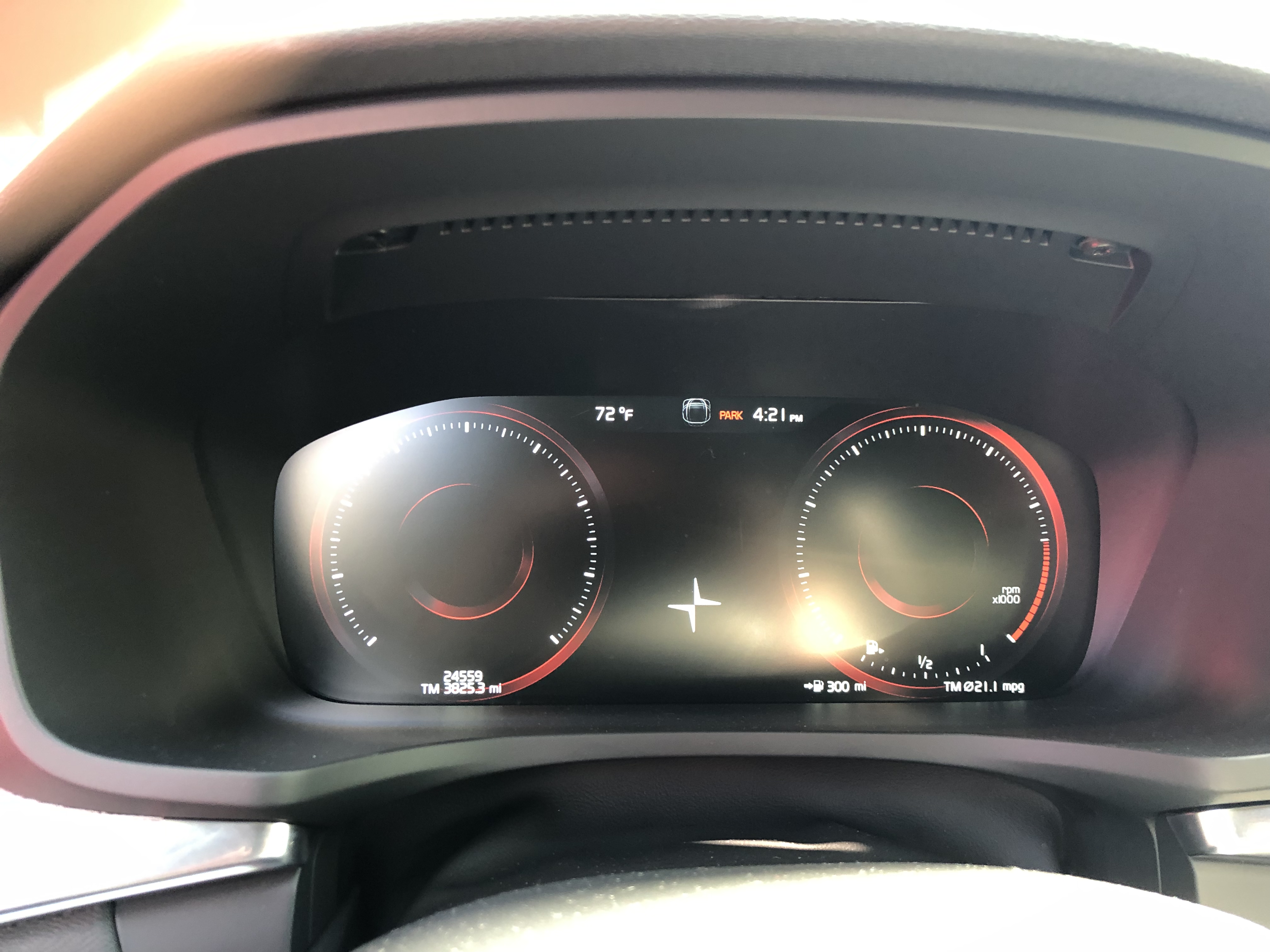

vtl wrote: 24 Apr 2022, 09:11 Couple of example of the real pin from flash and seed/key from the real session.
Got you. One thing I don't have is the PIN from flash, have not read the CEM, not a hardware guy ;-) So what I don't know is what Volvo has set the CEM 01 PIN to. I've been using the cracked PINs to test and program the car with.
Code: Select all
0x1A01 - 6657 - CEM000 - brute force PIN 4C4C1934B4
09 C1 FF/14 10 EF - 01/02
BD FA 1A/4C 0E 2B - 01/02
Thanks to Rick for getting us started with the algorithm. I built a tool to take the VIDA log and decrypt the lines with the seed/key exchange, then it brute forces a PIN. That PIN I have used to load CARCFG software files on the car. I have been using Volvo DSA to program the car while I work out the process but would like to build a tool now. I'm not seeing the programming seed/key exchange in DSA logs, but it works. All I got is a shot of my dash display, changed the logo to Polestar ;-) as well as various other tweaks that are now opened up. We've got multiple folks already cracked PINs from VIDA logs and able to load software on the CEM now.
2022-04-22 16.21.15.jpg (4.1 MiB) Viewed 644 times
