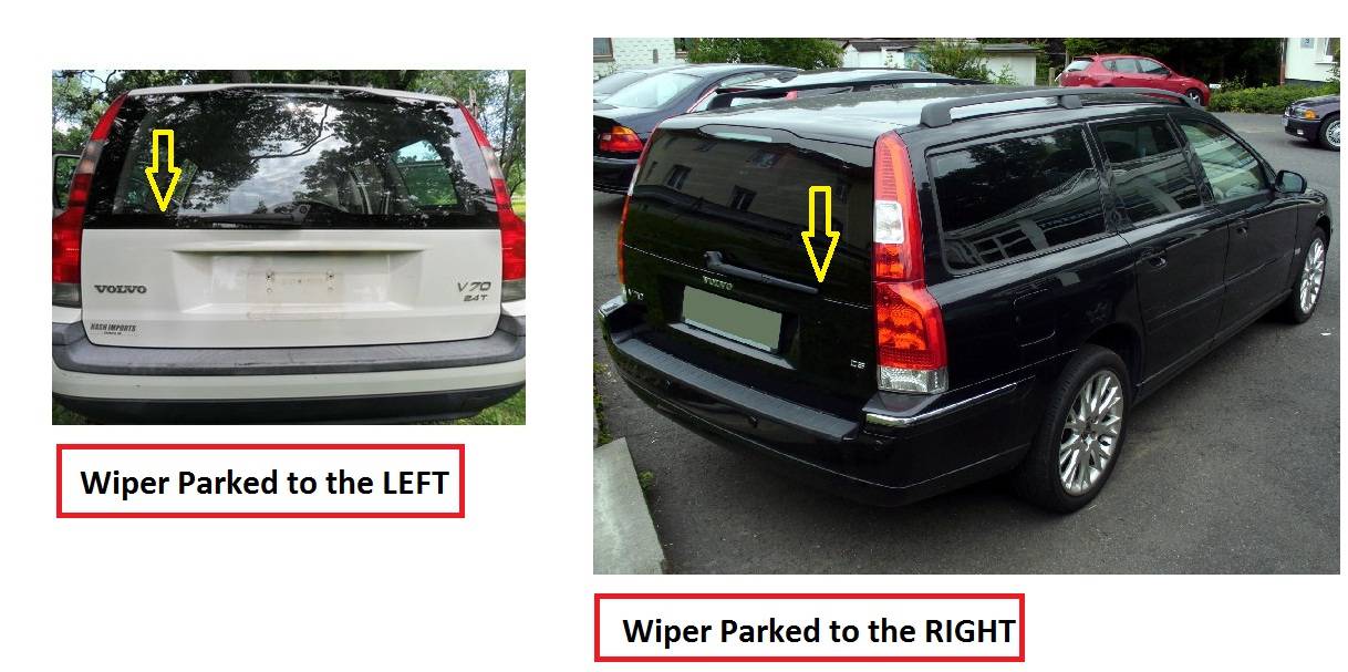

- My 2004 V70 2.5T REAR Wiper Motor is dead. My wiper blade parked to the RIGHT.
I took some random photos from the web to show some V70 up to mid-2003 parked to the LEFT.
After mid-2003, it is parked to the RIGHT.
