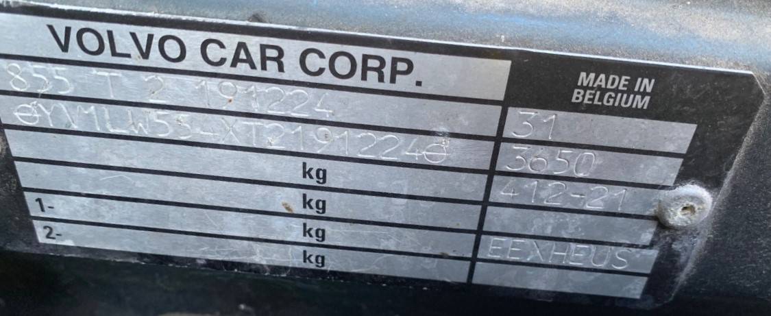

I don't know exactly how long this has been occurring, I've only recently noticed the drops on the driveway. I haven't added any fluid yet, but the dipstick is in the ADD area at this time, so I need to top it off. Do these PS units use the same ATF as the transmissions for these cars? I've got Castrol Transmax Import (which I think is Dex/Merc III compatible) in the transmission now, and I have some remaining fluid I could use to top off.
My chassis tag doesn't have some of the rows filled in. Regardless of what the car had in the beginning, when the mechanic did the front suspension work last year I had determined that TRW was the right type of tie rod ends, and looking back at my big suspension order from FCP last year, I used TRW tie rod ends and they are still in the car. So, it looks like TRW is the rack I need to get at this point.

Look at bottom of the steering valve, the vertical round piece the steering shaft sticks into.
TRW has a round cap
SMI Has a hexagon cap
Definitely try the stop leak product.
I use Valvoline maxlife synthetic ATF in all my P80 power steering systems to keep my fluid inventory simple
