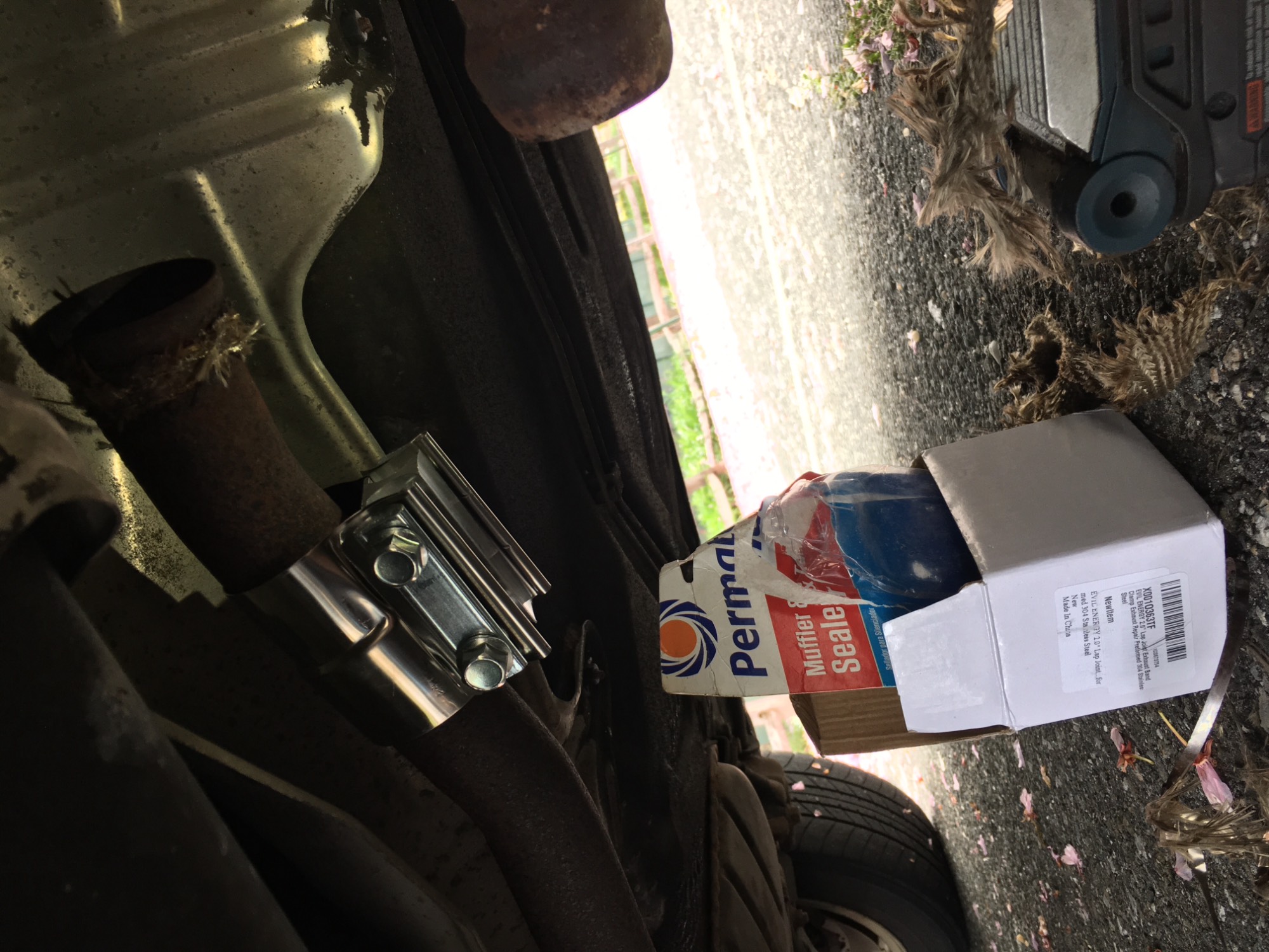

Finally got around to reclamping Abby’s exhaust junction on Evita. Car up on one side with ramps , 2 inch band clamp over ball and socket joint held into position with tipped jack stand. Used permeatex exhaust glue to help seal, idle for ten minutes to warm it up.
Much quieter.

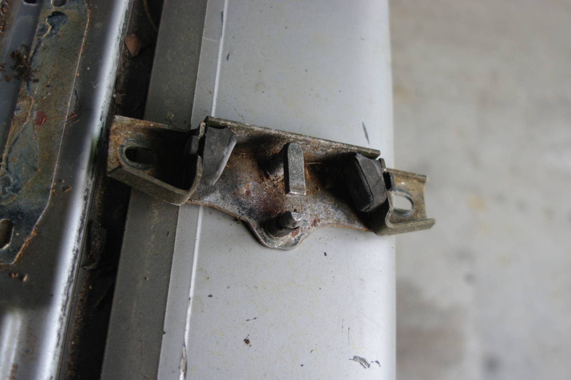

Exhaust plate 4x M8 bolts, 12 mm hex
Band clamp 2 inch SS , 14 mm hex bolts, deep socket

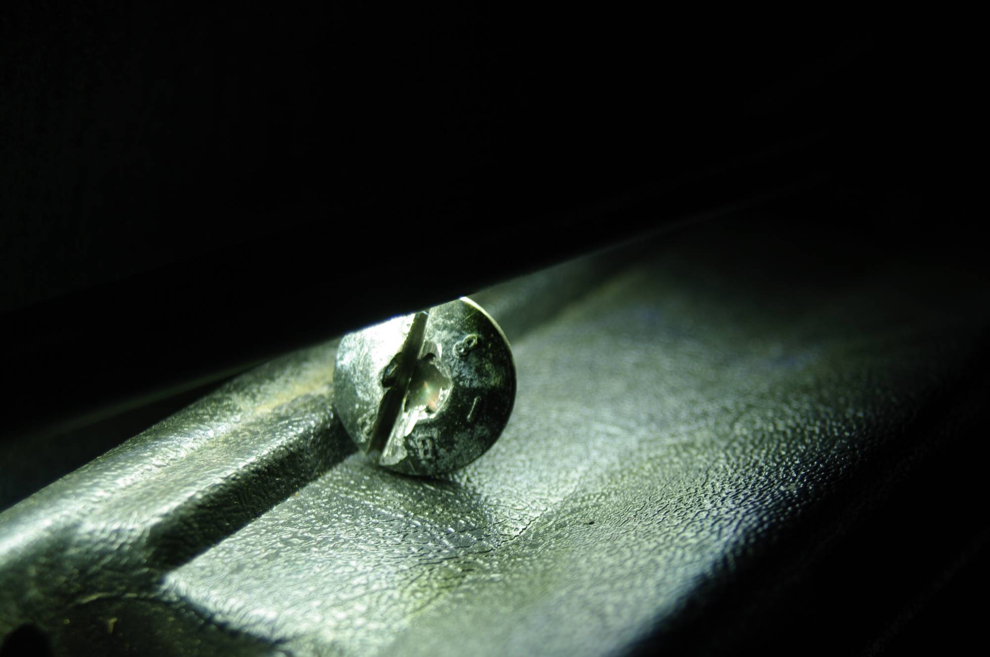

There were eight (8) very nice, long sheet metal screws involved. Undetermined if it will be salvageable. The top rear screw was also stripped. Both Dremels, several hammers, and a stout sacrificial screwdriver later, Fortunately Poor Old Blue has been harvested again.
