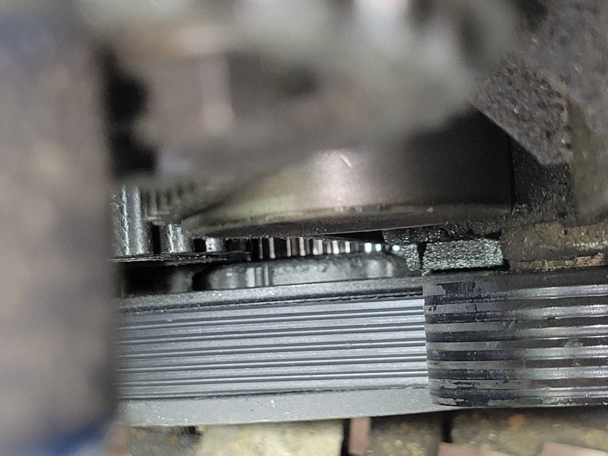

So now I'm trying to get the light off. I have placed pictures here to show that I set the crank at TDC against the marking. Kinda hard to see I know.

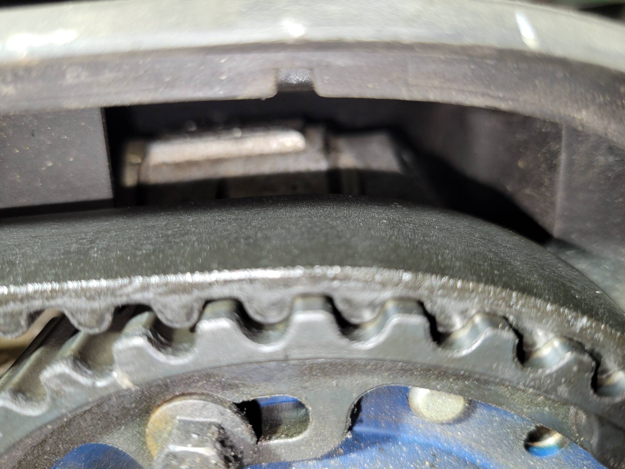

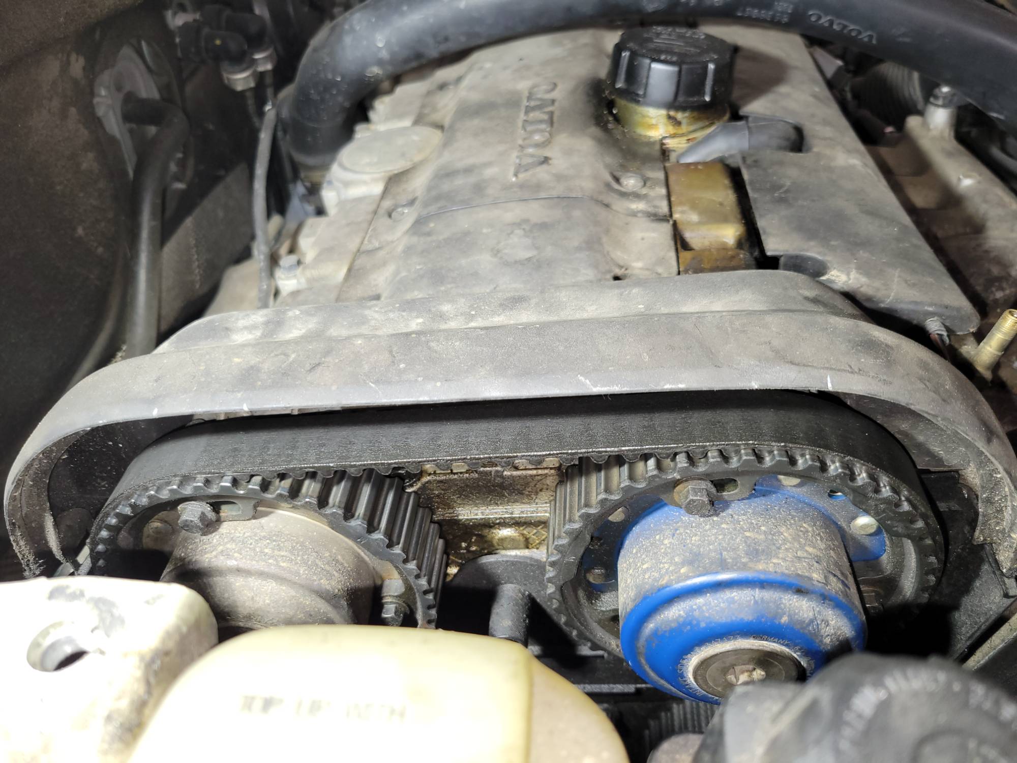

On the cam sprockets I marked with white where I'm currently at sitting TDC and where the timing marks are on the sprockets. And it seems absurdly far. 2-3 teeth away from where they should be. My brain is telling me the car should run horribly being this far off, if at all. So this part is throwing me off from what I need to do. Will this much distance really barely affect the driving? I can drive the car how it is and be perfectly fine for the most part. It idles a tad rough (barely noticeable) and it sometimes sputters a bit at high rpm.
Still my brain is saying it's not off as much as it's showing and if I "go back" on it to the timing marks it's really going to mess it up lol. Is this normal? Even being 2-3 teeth off only have a slightly negative effect on it?
Also, the exhaust sprocket is off by about a full tooth more. In attempting to move it CCW (after removing the belt by releasing tension on the tensioner), I could not get the timing mark all the way back. It only moves about 1 1/2teeth back before I can no longer turn it by hand. I don't wanna take a tool to it prematurely but I also have a weird fear of turning it CW a full 360 to get it to line up as well.

its still filthy , PO didn't clean it up, I would go back in there and replace everything, belt, tensioner, idler.
It will probably require removing the cam hubs again to re set them, need the cam shaft locking tool.

You need set these marks ( which are not TDC marks) by rotating the crank past the marks by 90 degrees , then turning the crankshaft backwards to return the crank mark to alignment.
After this , take a picture of both intake and exhaust cam and see where they are relative to the notches on the cover. Use a straightedge to mark them so we don’t have a parallax problem inthe photo
These cars need to be within one tooth or else the ECU will shutoff cam adjustment, set the code, and run rough.Still my brain is saying it's not off as much as it's showing and if I "go back" on it to the timing marks it's really going to mess it up lol. Is this normal? Even being 2-3 teeth off only have a slightly negative effect on it?

Look carefully at the photos you posted, the TB , despite the fact that it is only 1 yr old, already showed frayed edges.
I'd replace with Conti kit.

Ok I've got all marks lined up and it's still throwing code. Someone suggested it may take 25 miles of driving for the code to go away, for the cars computer to calibrate to the new timing? Completely unsure if this is true, but I can't figure out why the check engine light is still on otherwise. Still getting the p0017.
Car seems to be running fine as well.
Sorry about the pics, hard to take closeups with phone to get the notch and plastics setting. On the crank you can see the line on the harmonic balancer since I can't see the notches on the sprocket.
