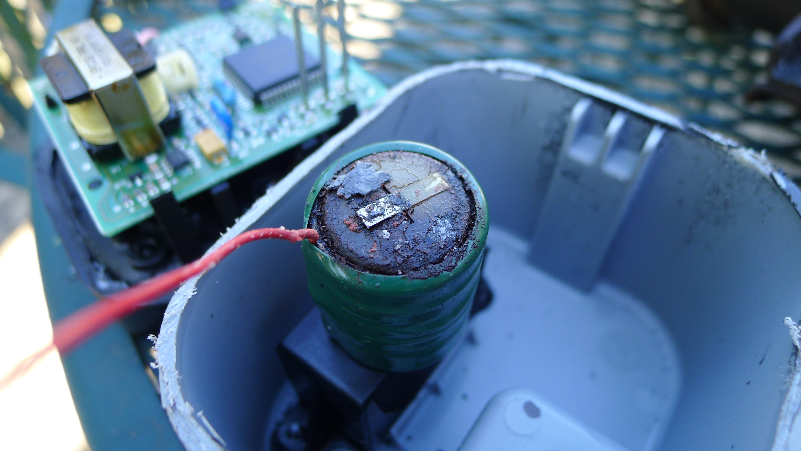

UPDATE on 2004 V70 2.5T with 128,600 miles, with "Alarm System Servicing" message intermittent on the dash...
- Of course the factory battery is all corroded and kaput, glad I caught this before the acid from the battery
damages the circuit board. My circuit board is still good. At least the factory battery lasted some 18 yrs!
- Bought a 7.2 V 320mAh Ni-Mh battery on ebay for $10.95.

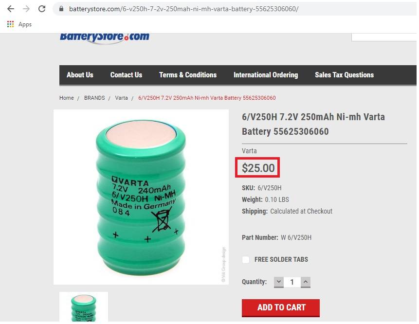

- The ebay battery is $10.95 vs Varta ($25-$30 or so), per @oragex, Varta is better but it
is difficult to find. Once I already cut open the factory unit, subsequent servicing is easy bc I used silicone caulk
(the stuff you use the caulk window/door at home) to seal it with zip tie to help it cure in place.

- Anyway, some photos, so you can see what is going on.
- Not difficult but a tedious process. Once done, next job is easier...

If anyone has done this mod (relocating the battery to engine compartment), please share some photos...
then battery swap is a snap lol!
PS: If I ever do this job again (hope not), I'd definitely :
1. Run 2 wires into engine compartment.
2. Find a small plastic juice bottle (of course clean and dry it first).
3. Drill a tiny hole in the bottle cap for the wires and seal with silicone caulk.
4. Store the new battery inside the juice bottle for protection against element.
5. Zip tie the bottle to something nearby to prevent it from moving around.
Now you can see with this setup with juice bottle, changing battery is < 1 min job lol!!!
