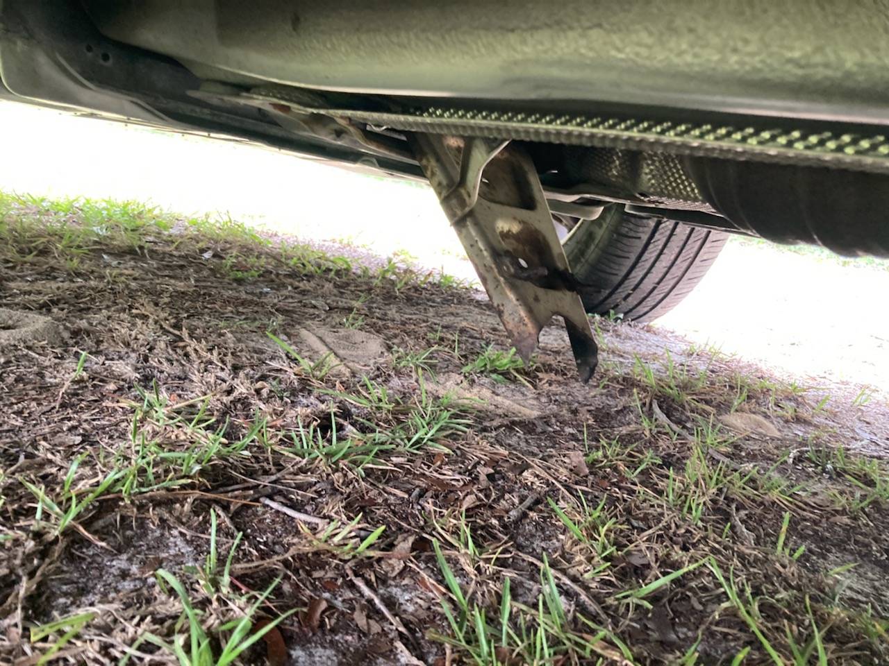

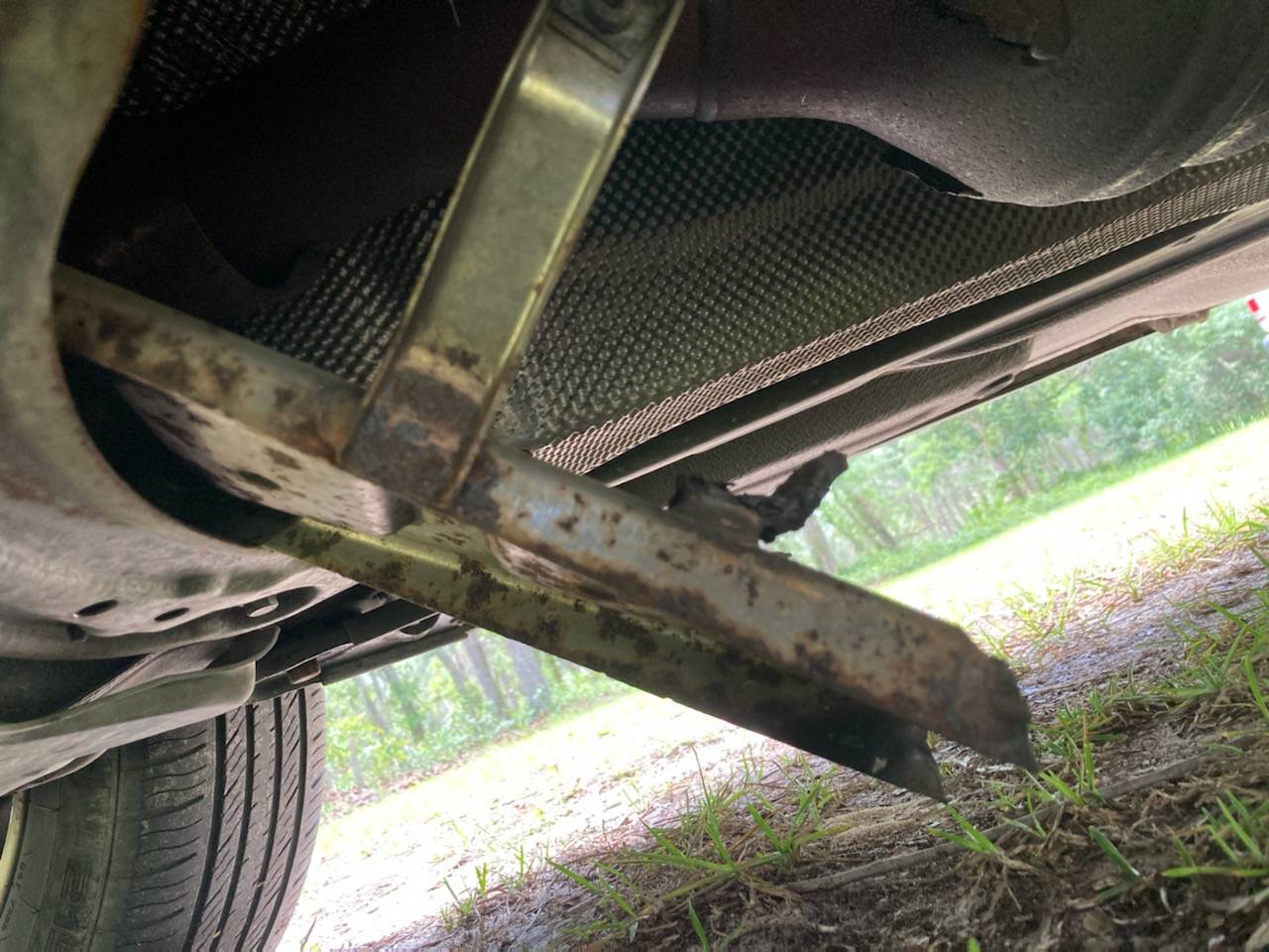

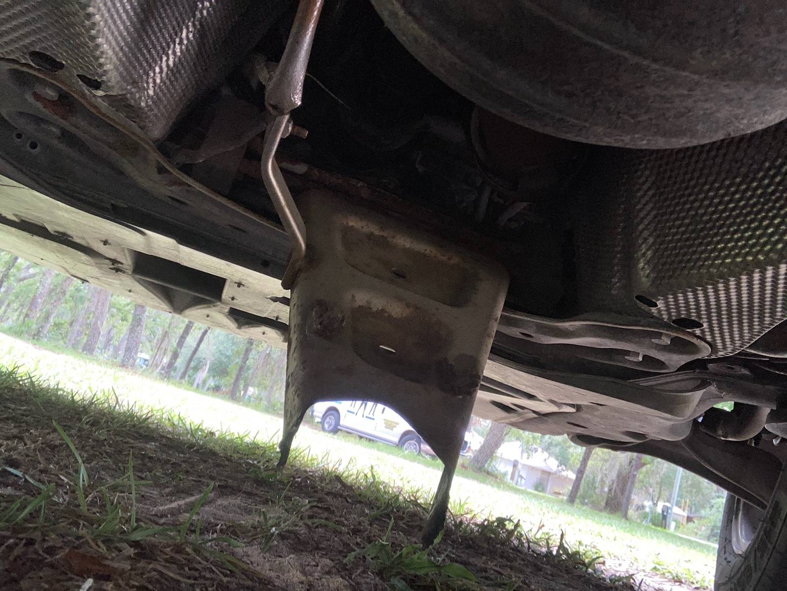

Hi all - Helping my stepson out here - If anyone can give us some insight, see photos and his description below:
"I had gotten home & I was backing up into my spot when I suddenly started hearing a scraping noise under me, so I parked in, checked to see the problem and I found a rusted latch in the mid-front section of the car. I have no idea how it broke or what it is, I just noticed when I parked. I have no idea whether it's an important piece or not, but now I can’t back up or drive without worrying it might break and break the car further"
My questions for you all:
- What is it?
- Can it be driven as is for short trips? for the time being?
- Can it be fixed (relatively inexpensively)?
Many thanks in advance

First question -
Is this in the wrong forum? Are those pics from an XC wagon?
I don’t have mine home to go out and look, and I’m not finding that shape in the parts diagrams, but it looks like either an exhaust or cat support, or a chassis brace that fits across the bottom of the driveline tunnel. Appears to be just aft of the front subframe.
Did this rust and fall off, or did you drag bottom and tear it off?

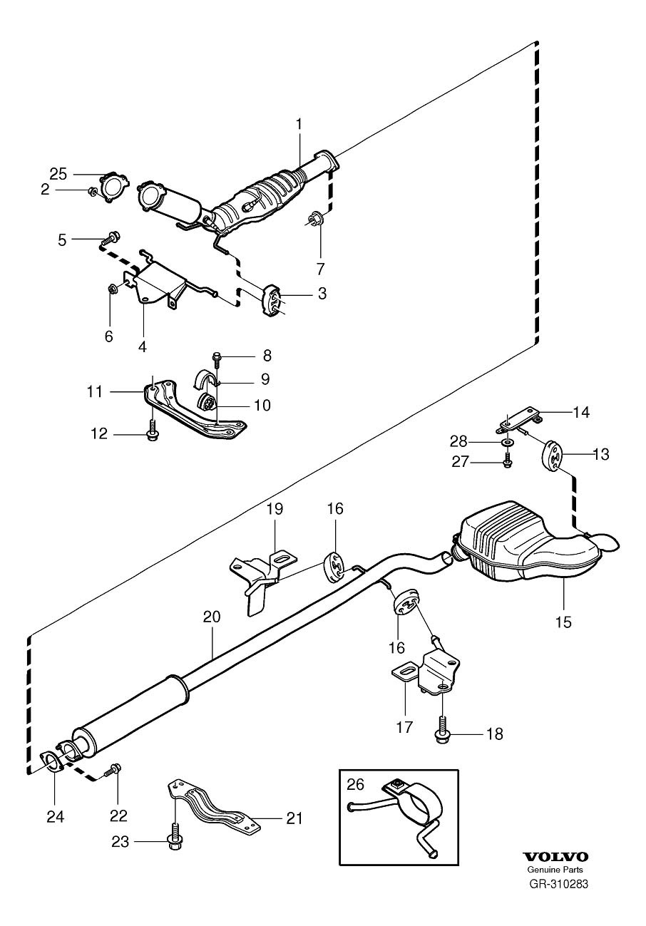

Here's the exhaust on an '04 XC. It doesn't look like 4, 11, or 21.
04 XC70 exhaust parts.jpg (125.35 KiB) Viewed 3209 times

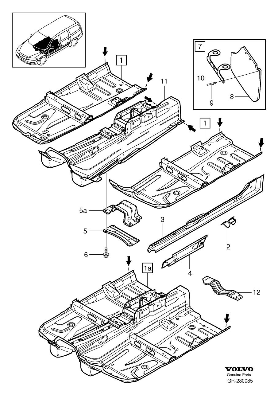

Here's the forward floor assembly....?.....It's not 5, 5a, or 12.
04 XC floor assembly.jpg (267.16 KiB) Viewed 3209 times
