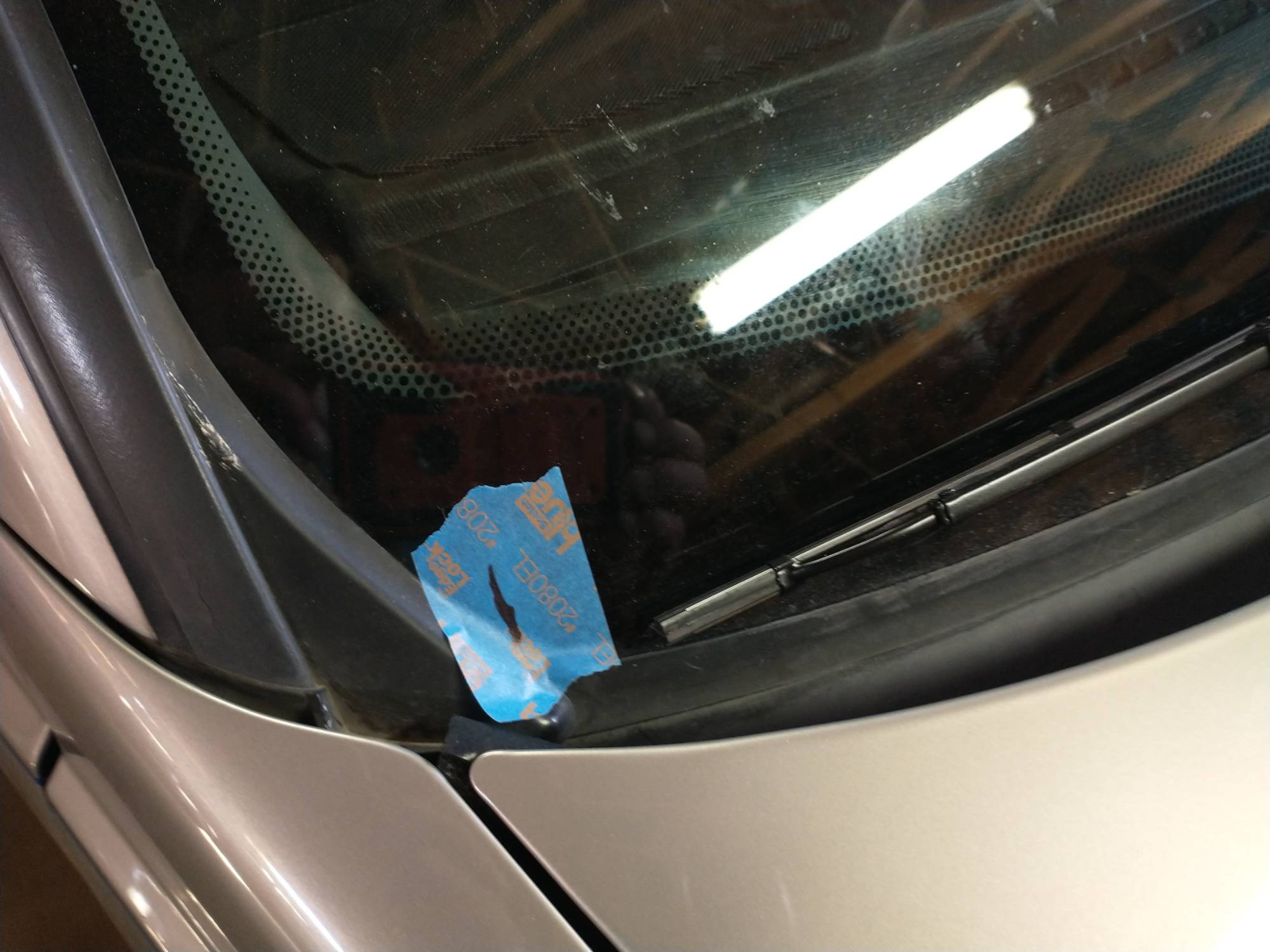

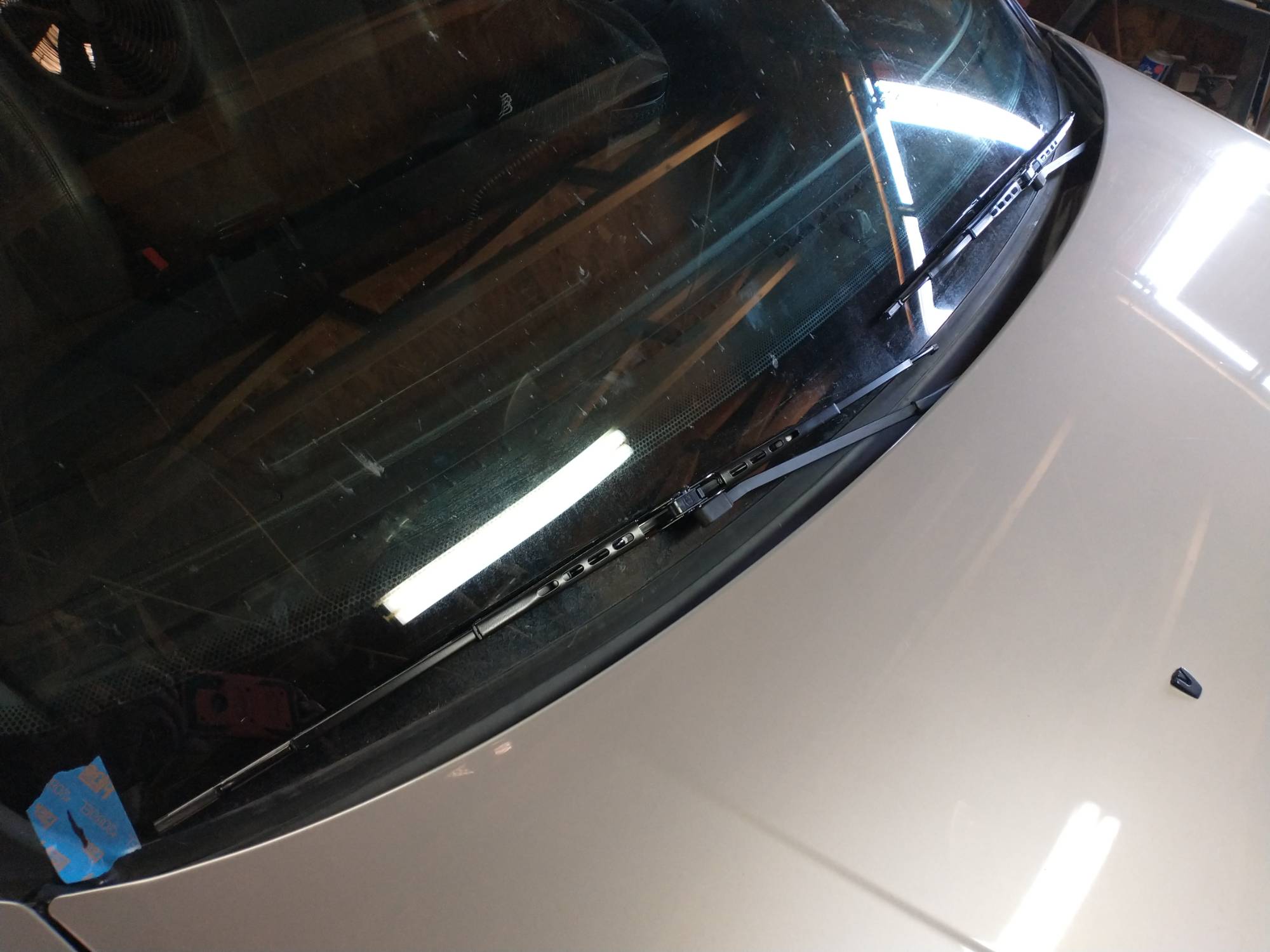

Well the wiper arm replacement went pretty well. As expected, the wiper pattern is a little different than stock, but not wildly.
I went with Bosch 24" on the drivers side, and 26" on the passenger side.
The pic with the blue tape shows the difference between the stock ( sharpy mark ) and the new ones. I guess some of that could be taken up with a longer blade, but considering the amount of times that I have to use them, I'll deal with it for now. Around here your blades dry out in about 2 years anyway.
But inside view is greatly improved.
