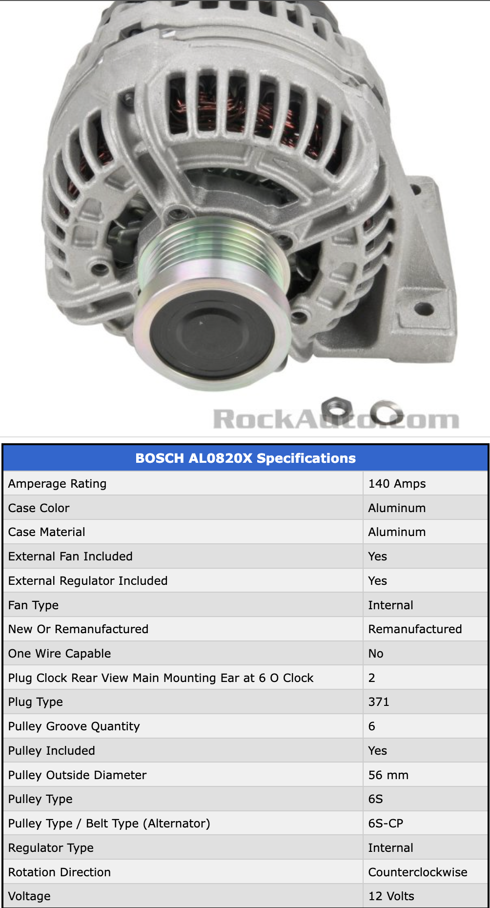

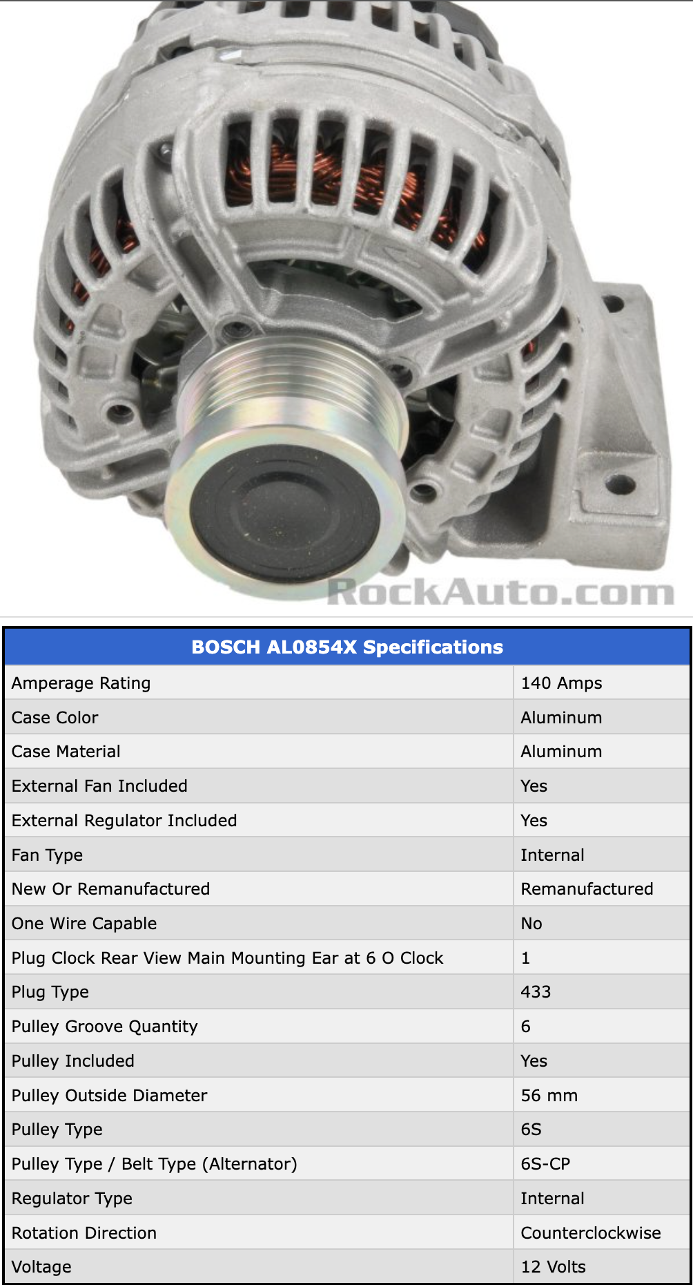

I have the opportunity to buy a 140A Bosch AL0854X for a really good price because of a customer that backed out. Only issue is, it's made for 05+ cars with the ECU controlled voltage regulator... If I remove that ecu controlled voltage regulator and install my original 140A self regulating bosch voltage regulator, would I technically make a AL0820X Frankenstein (140A for 04 and under)? Would that cause any issues? I do not see any other differences when it comes to specs.
AL0820X specs (04 and under, self regulating)

AL0854X specs (05+ ecu controlled)
Screen Shot 2022-06-19 at 11.38.10 AM.png (1.09 MiB) Viewed 329 times

Will not cause any issues (besides that Bosch rebuild can fail sooner than you expect).
