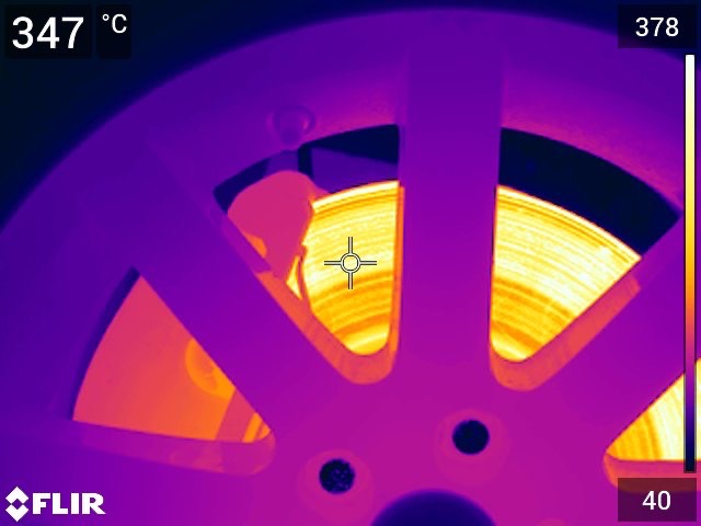

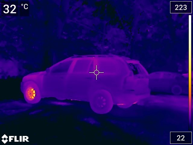

Recently I noticed a burning smell and a departure from the usual brake feel. Just by feeling the heat given off, it was clear the left front calliper was stuck. I happened to have a thermal camera I use for work, which illustrates the issue nicely:
Closer inspection of the affected rotor shows it was getting really hot! (this was a few minutes after ten minutes of driving):
That's over 650 degrees F.

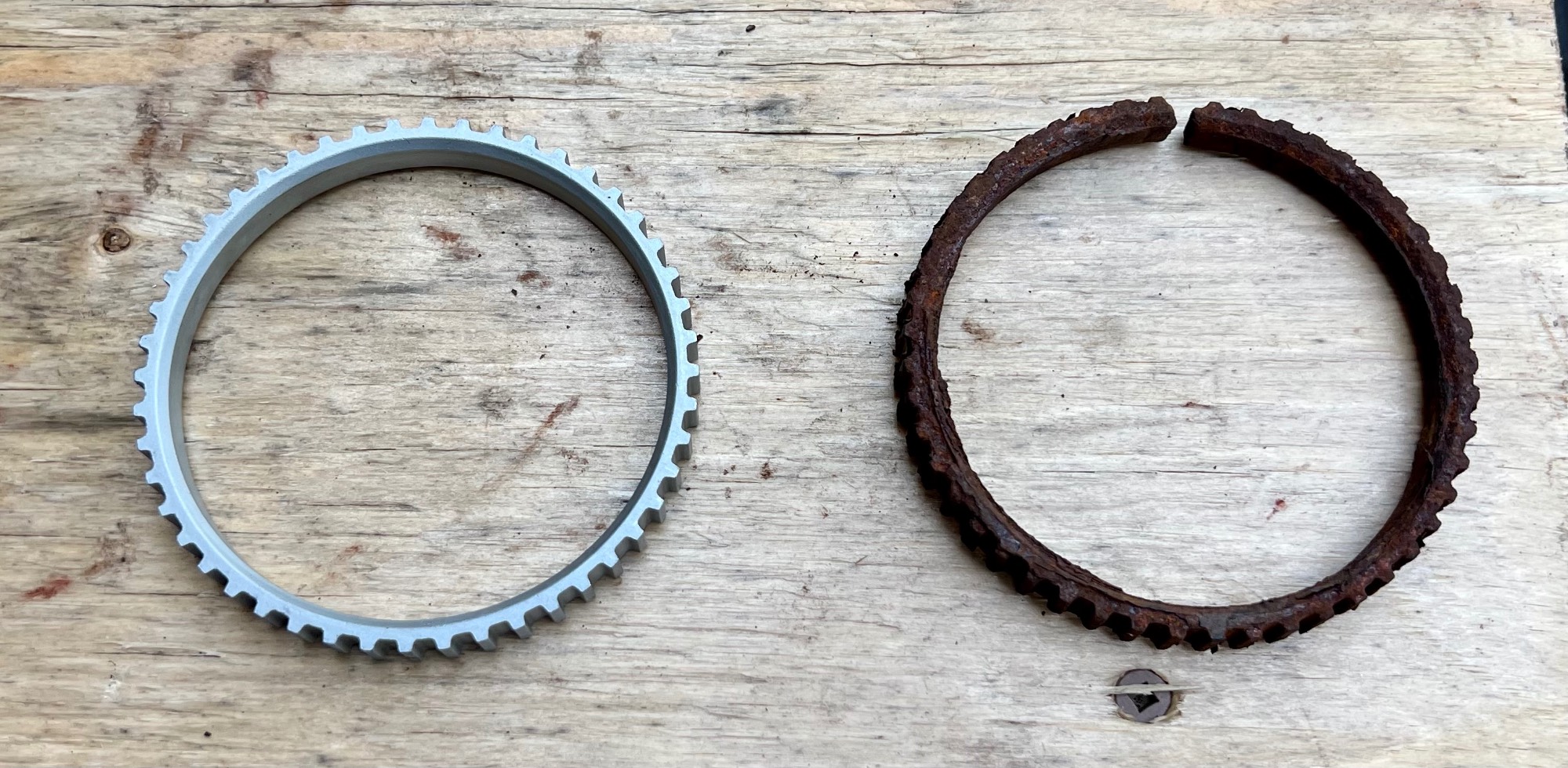

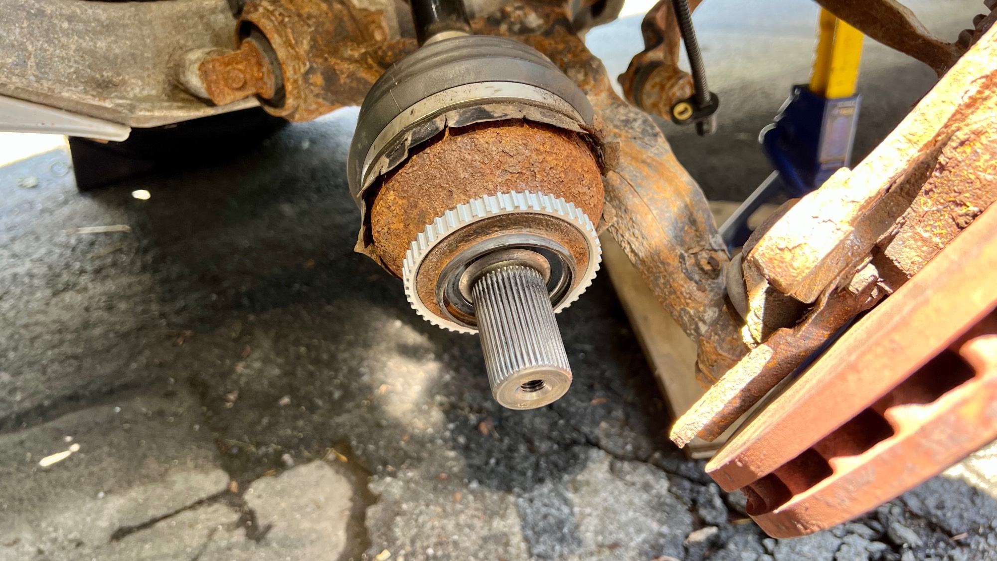

As suspected, the tone wheel was broken. The end of the ABS sensor was gouged as well, so I replaced both the sensor and the wheel. Each part was around $80CAD.
Before fitting the new tone wheel, I took off all rust on the mating surfaces with a wire wheel. It was not necessary to pull the axle out of the transmission to do this. The tone wheel went on without too much difficulty, probably due to erosion of the mating surface due to corrosion. It was still quite snug. If the fit of the new tone ring onto the axle was tighter, I might have had to pull the axle out to use bench top tools or a press to install it. In my case it just took patience and careful tapping in a star pattern (and I did not have them impression that the axle would have parted easily from the engine/transmission).
Despite all the rust, the axle joints moved very smoothly and the rubber seals were intact. The hub bearing also seemed in very good shape. The hardest thing was loosening the lower bolt on the steering knuckle - in addition to penetrating oil this required heating the nut with a torch and the highest setting on my impact driver. I used a couple of flame protector sheets, when applying the torch, to shield the plastic ABS clip above the nut and the rubber seal below.
