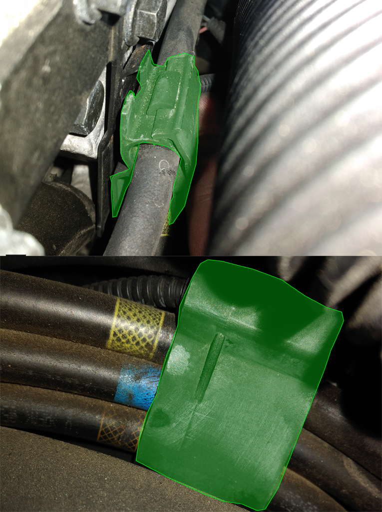

While reconnoitering my way around and under the intake manifold to the throttlebody, I figured the EVAP emissions hoses could do with replacing. I managed to find hose sizes and part numbers for everything except two plastic bracket/holder pieces. This is a 2004 V70 2.5T. Emission code V
1st is driver side front of the engine block, just under the aluminum crankcase breather pipe. it holds one of the EVAP emission hose sections, the smaller bypass valve hose, and electrical wiring. Highlighted in green. Above is breather pipe, bypass valve hose passes over it. and EVAP Emissions hose under it.

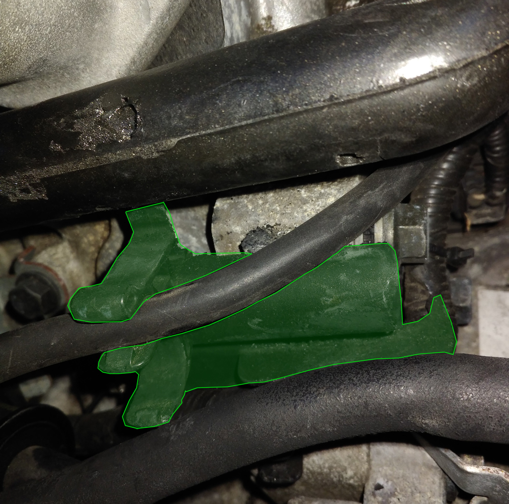

2nd piece I'm searching for is on the side of the engine, driver side. crammed between Airfilter->Turbo intake tube. Two angles from above and side. Above you can see the EVAP emission hose going to the Intake tube. From the side you can see the three color coded turbo control hoses.
No markings on either piece that I can see, I doubt they would hold together after I remove them as they look pretty deteriorated. No luck finding anything that looks close to these pieces in VIDA or Volvopartswebstore diagrams
any ideas?

I went to the junkyard for some other parts and ran into a 04 S80 with identical 2.5T engine. it had the 1st piece in decent shape, pulled that, Volvo PN08651051. Only site I find selling it is Russian. 2nd one still a mystery. The one from the S70 has no markings, no markings on the metal brackets that's bolted to the engine.
I can live with it.

Just coming across this today in search of the same part. I found the part in VIDA by removing the leading 0 from the part number, so it would be 8651051.

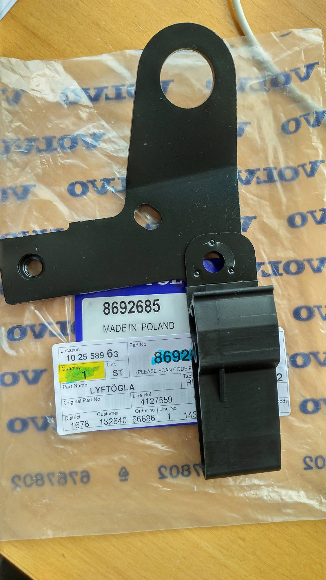

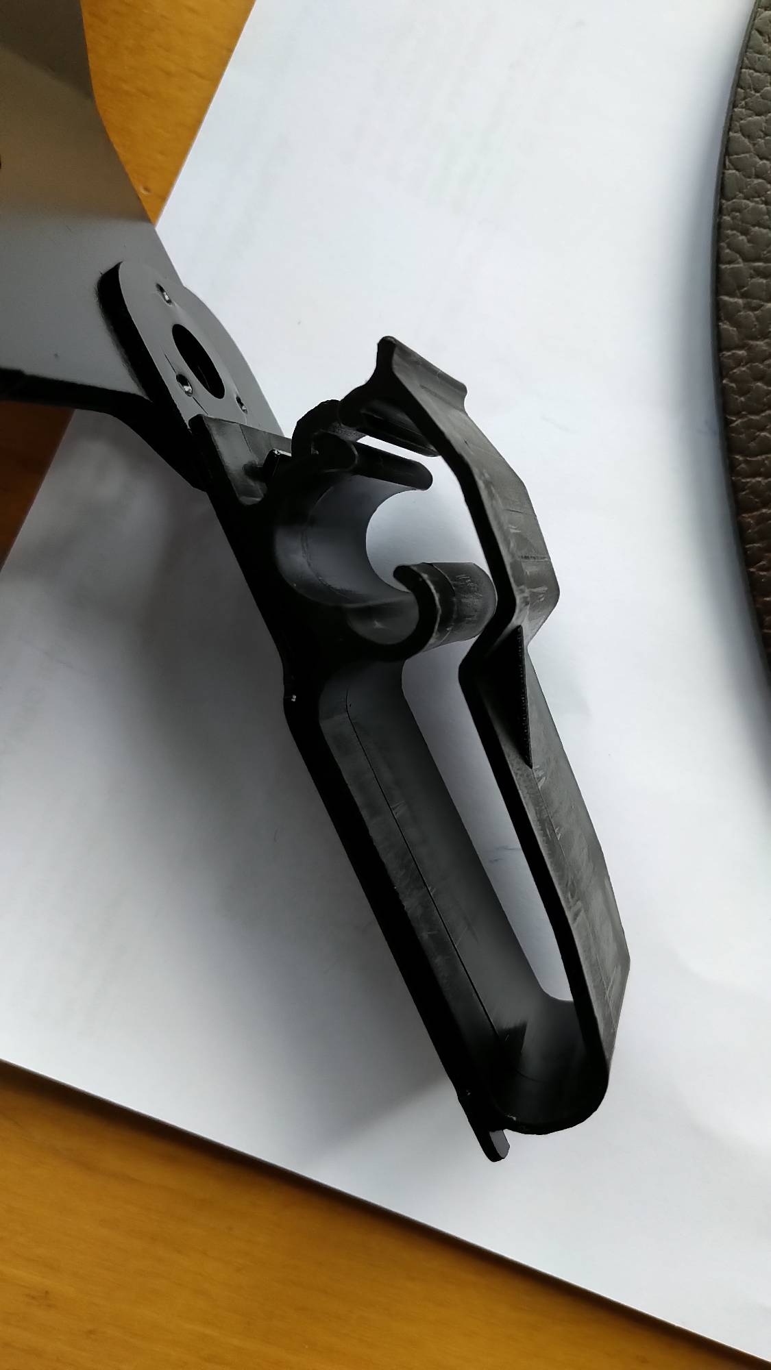

In the 2nd part, the bracket belongs to the whole piece. It is named "Lift eye". PN is 8692685.
