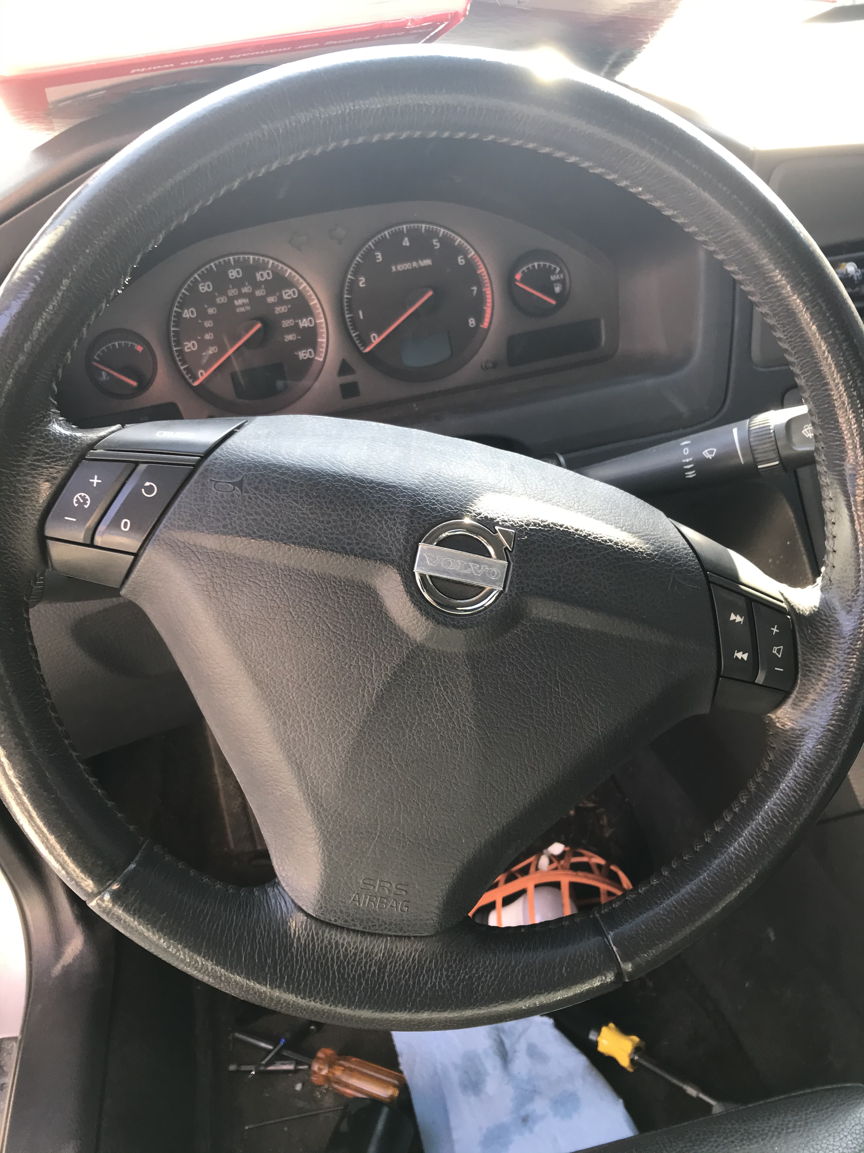

Issue #1 - The steering wheel is stuck in a weird position and won't move or budge at all. This is bad because I might need to remove the airbag and steering wheel to get to a resolution to Issue #2 but don't know what to do here. I'm 100% certain the plastic piece is just stuck in the lock position.

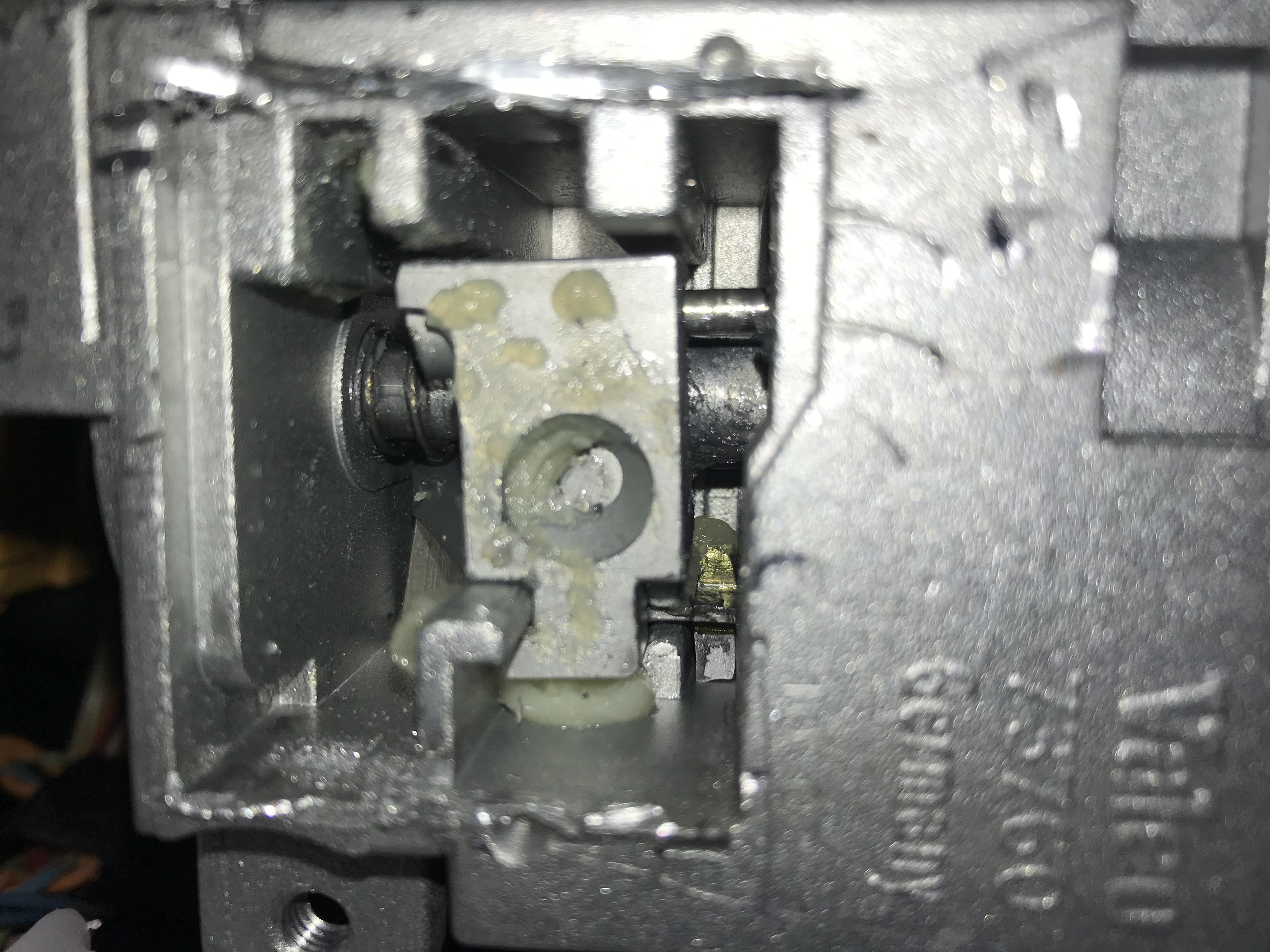

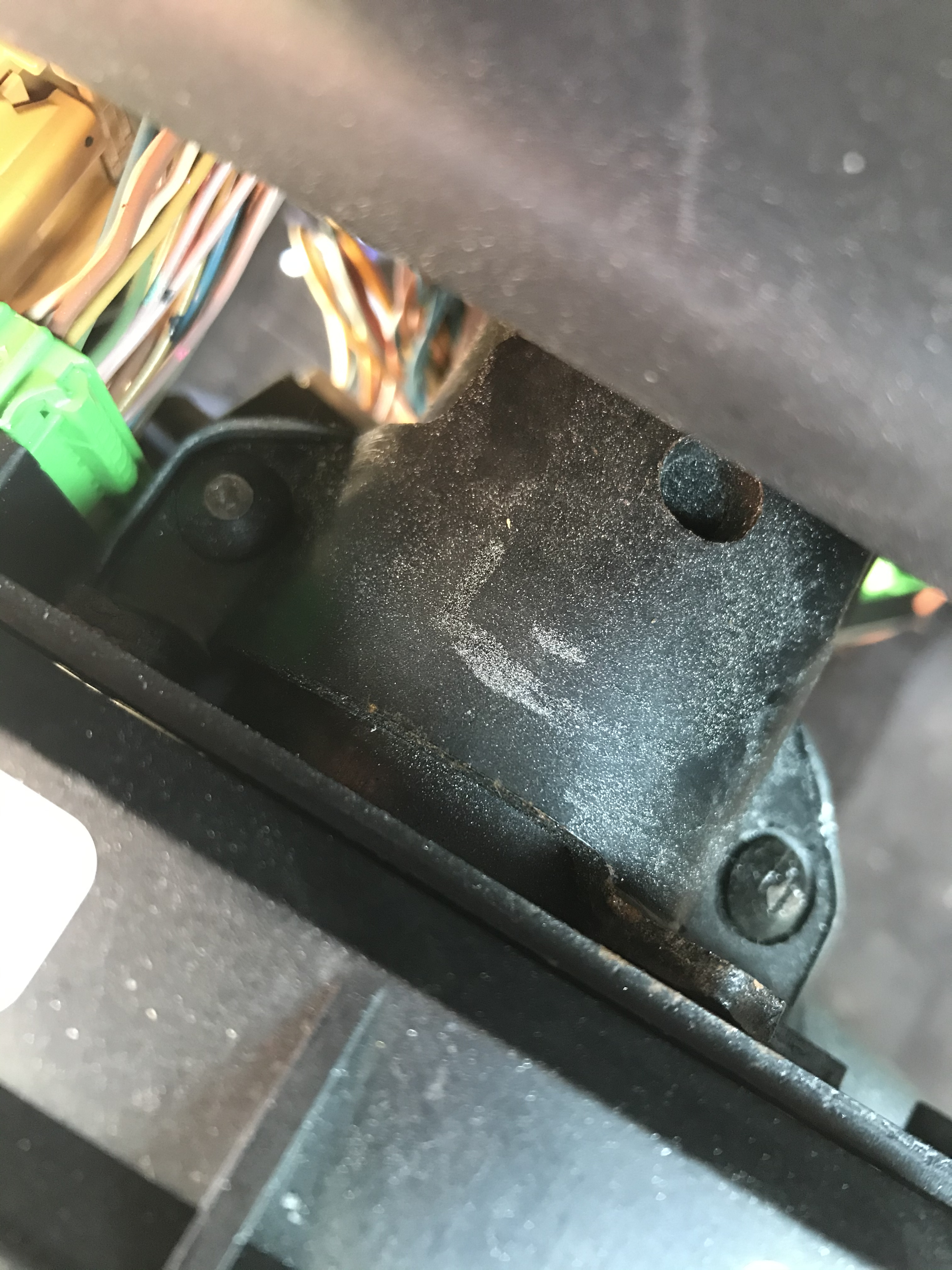

What I've done so far? I've read a forum post by member cn90 who mentioned there would be a broken metal piece stuck in the tumbler and he was right. You'll see in my video of what I did per his instructions sort of helped (wish it was the answer!) - https://youtu.be/OZTbEw79byM. I have already disconnected the battery just in case. The steering lock mechanism is not driven by electronics like the XC series (I believe). I also am struggling to get the security bolts removed so I can take the ignition mechanism off to replace it with a new one.
Please shed upon me your guidance! So far I know it looks like I'm going to have to replace the steering wheel lock mechanism since that's broken. The ignition tumbler is probably busted so I'll have to get a new one. I'm hoping that the key just needs to be matched up with a new tumbler and it should still work with the electronics (hoping that works still?).

Ive removed those headless bolts, got 3 out by drilling a hole and using an easy out. 4th one broke the easy out and i used a chisel.

The p2 lock tumbler assembly is different than p80. There is a bulletin out that reports failure to advance to KPI is usually the key tumbler jamming
Unlike the p80s, the lock assembly bolts into a welded steel me,beer on top of the steering column, but it has the same snapped off security torx , 2x
It’s tough drill because you can’t get a drill straight down due to the lip of the dashboard cowl around the instruments.
