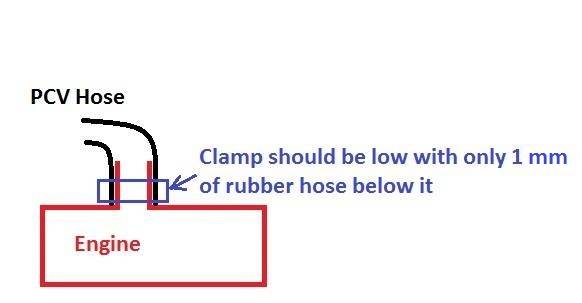

Back to the original issue (broken PCV hose).
Installed a brand-new PCV Hose (Genuine Volvo) 1K miles ago, but used clamp instead of Oetiker clamp.
After 1K miles, the hose popped off.
As it turned out: if using screw clamp, ROTATE the clamp so it can go down almost flushed with the metal surface.
There should be only 1mm of rubber sticking out below the clamp. This is bc this engineering setup is no good:
the metal nipple has no snub, and it is itself short, so the hose has a tendency to slip off...
