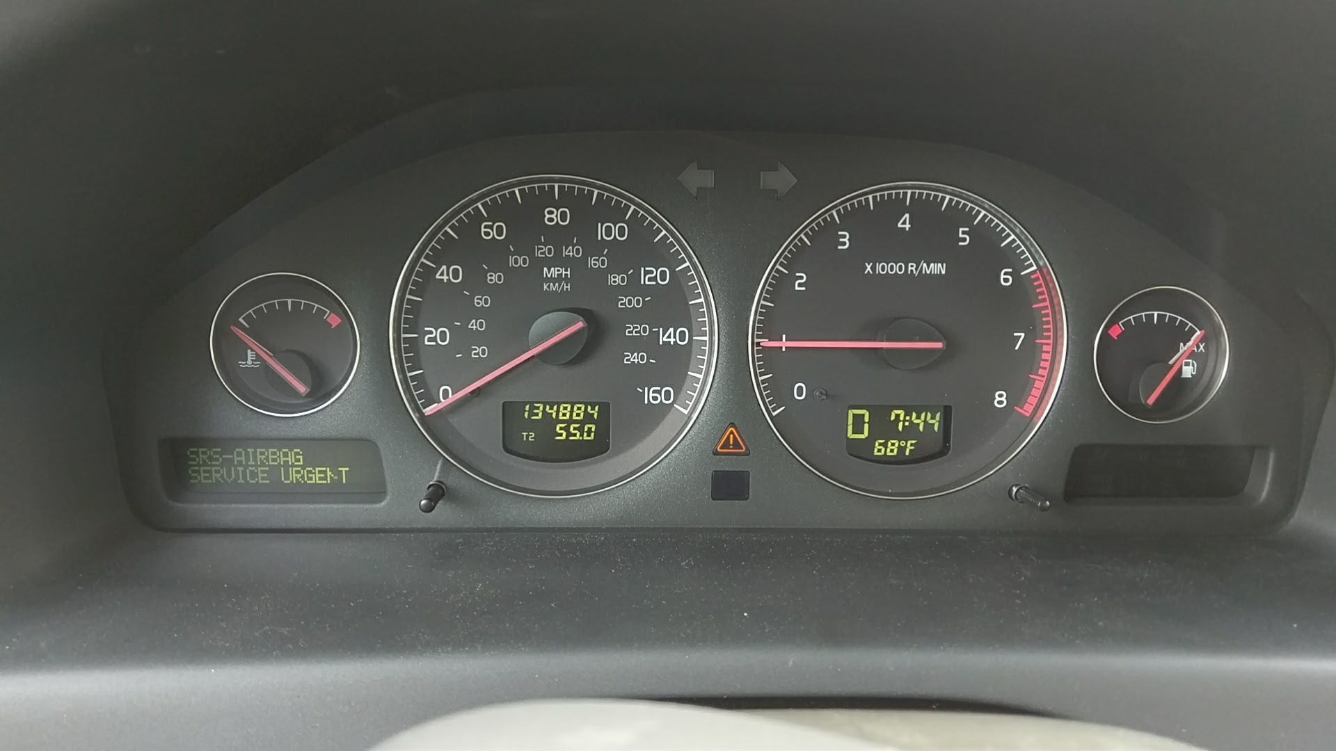

With the car off, I pulled the cluster to replace a bunch of bad bulbs. I disconnected the cluster. Replaced the needed bulbs. Reinstalled the cluster. Turned on the car and "SRS-Airbag Service URGENT" pops up in the display and the Yellow ! is on? Hmmmm I thought if you did it with the car off it wouldn't do that, but whatever... Volvos!! :?

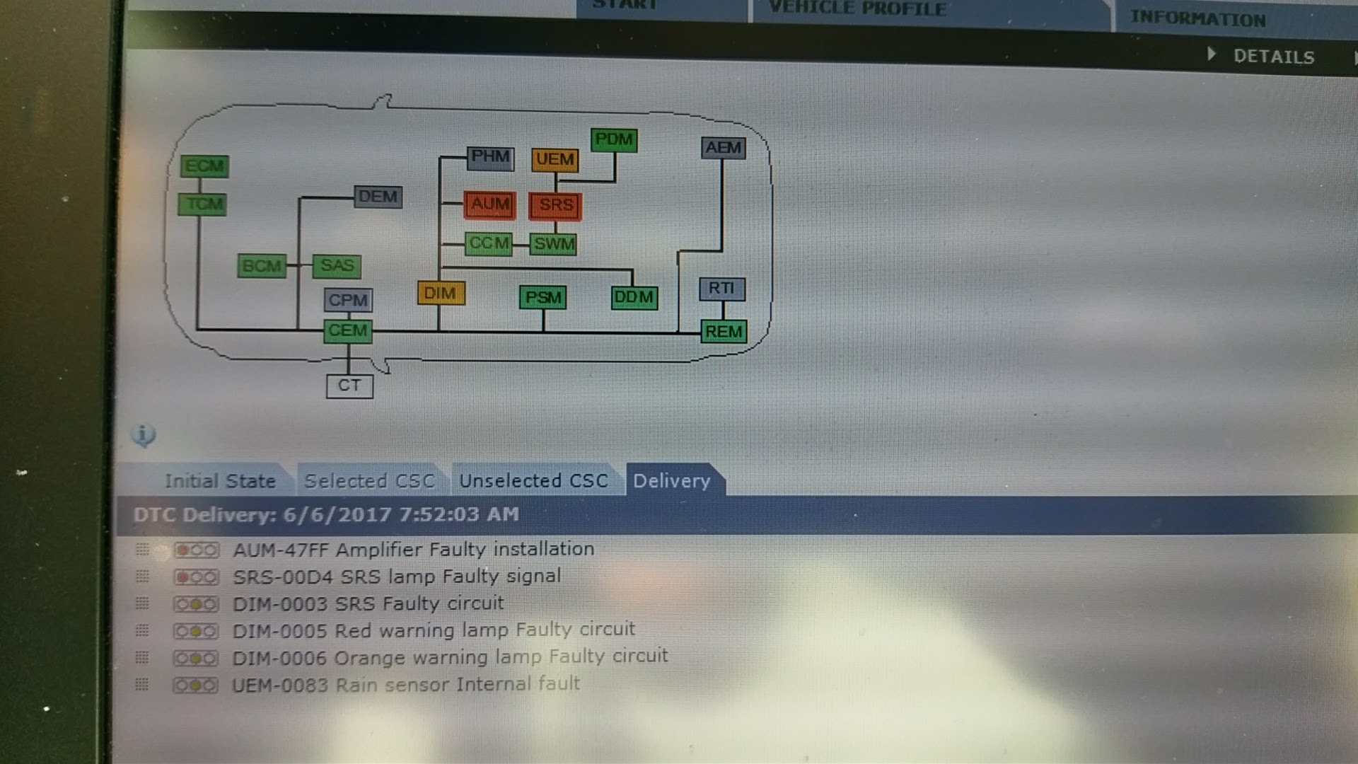

So I grab the laptop and cable. Reset the errors. Gone. Follow the prompts to restart the car and Poof.... errors reappears.
Listing of errors
Listing of errors

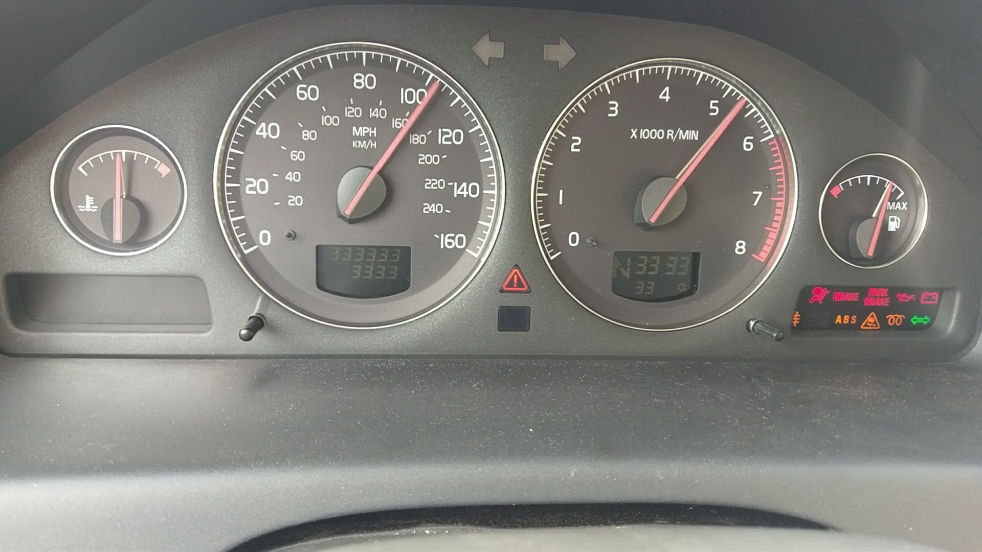

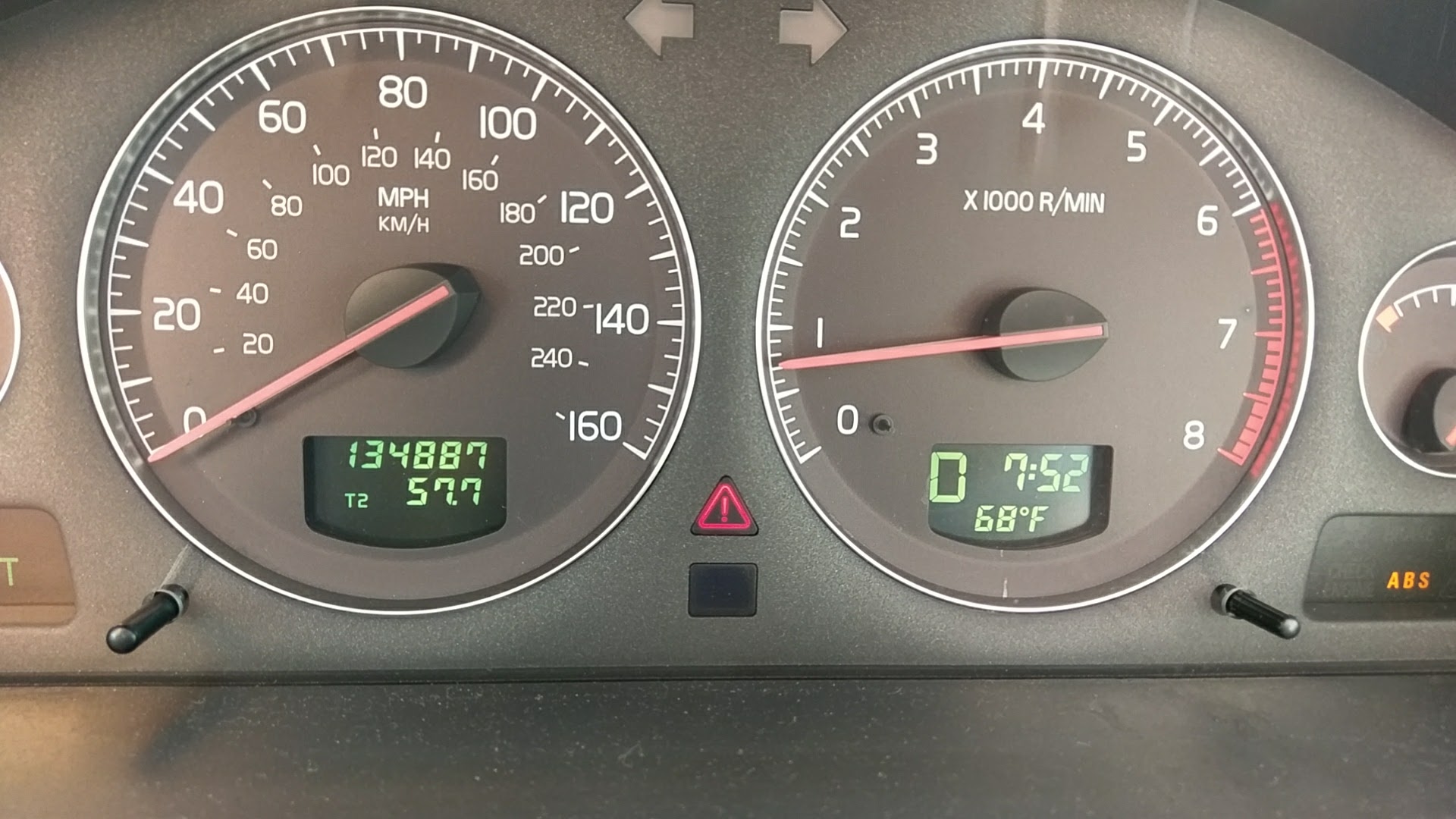

OK, now I am pissed. Quick search says that it's failures at the SRS Lamp, Red, Orange and Yellow LED are bad. Hmmmm Didn't I just see all those? So I ran a cluster test...
Red and Yellow make orange + SRS All On!
Definitely RED!!!
Definitely RED!!!
Definitely Yellow!!!
OK, I'm stumped and that doesn't happen too often. So a bit more digging says Air Bag connectors can cause this. Not buying, but I check the under seat ones. Both OK. I did nothing besides pull the DIM to change the bulbs.
There was one reference to similar set of errors here on MVS and no resolution was ever posted. I'm not digging into the dash and sides without a good reason to, so here I am!!
Any error gurus out there got a good place to start looking for the solution to this? DIM appears to be working perfectly other than a missing segment in the text display. All lights, LEDs and gauges function perfectly.

The error changes too. Sometimes it's DIM-0003 & DIM-0006... Sometimes DIM-0005 shows up. But the constant is SRS-00D4, which I presume is set by the DIM codes regardless of which ones show.
It goes away till I restart the car, so I don't think it's an actual SRS failure now... it's in the DIM.
