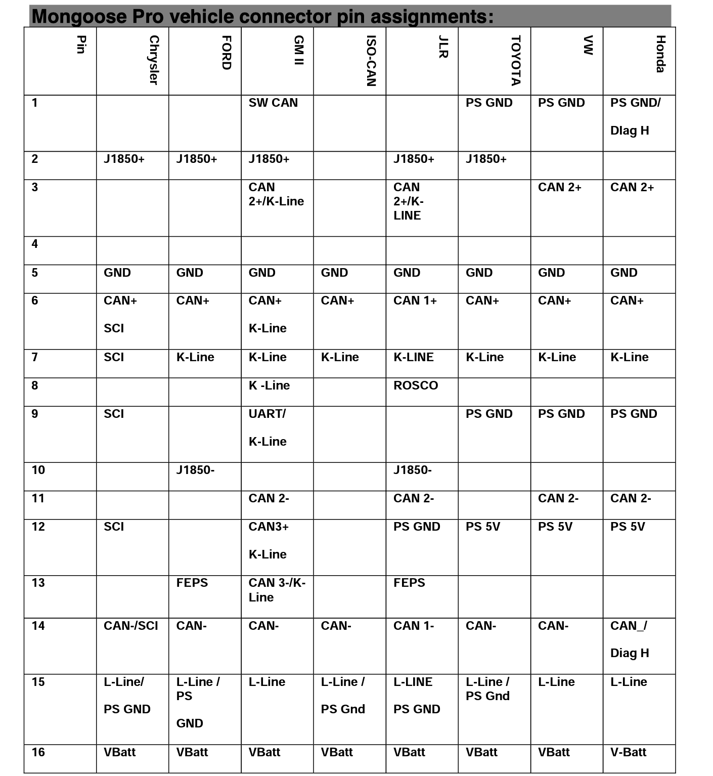

Just found this "ford" mongoose clone and I thought it would be the same as the volvo one but after looking at the ford pinout from drewtech's website, it probably wouldn't work. It would've been cool though, almost half the price of the JLR clone.
