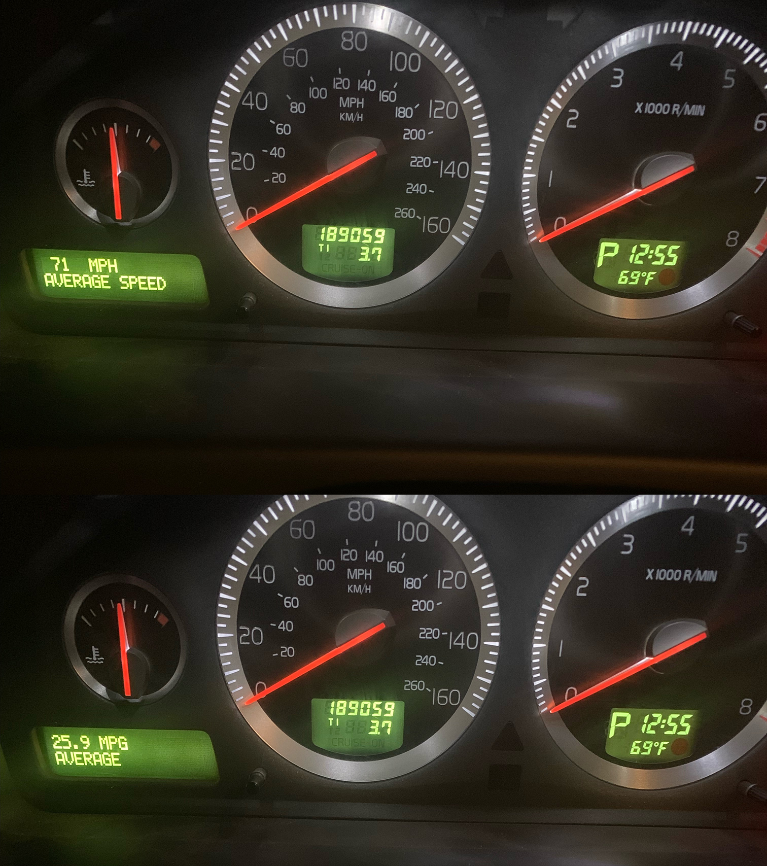

Drove it 1003.7 miles on Tuesday.
Average 71 mph and 25.9 mpg for the trip.

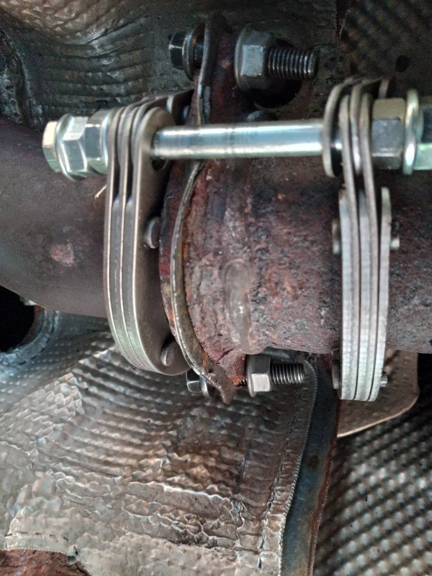

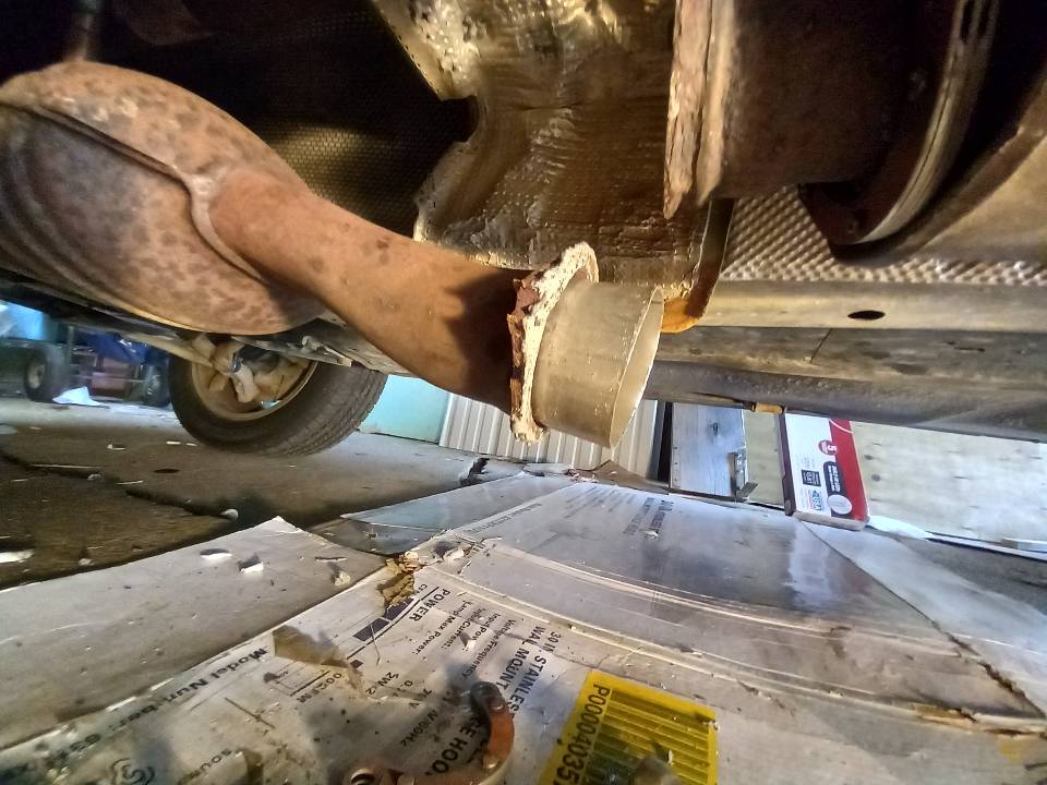

so I finally sealed the leak at the cat to resonator flange. The flange bolt holes were rotted away.
, I put a split coupler on each side of the joint,
a 3 inch section of 63mm pipe inserted (hammered) in the cat side,
resonator side is slightly bigger , the flange bolts drew it together.

Very much doubt for how long this fix will work, without good 4-5 layers of duct tape!
