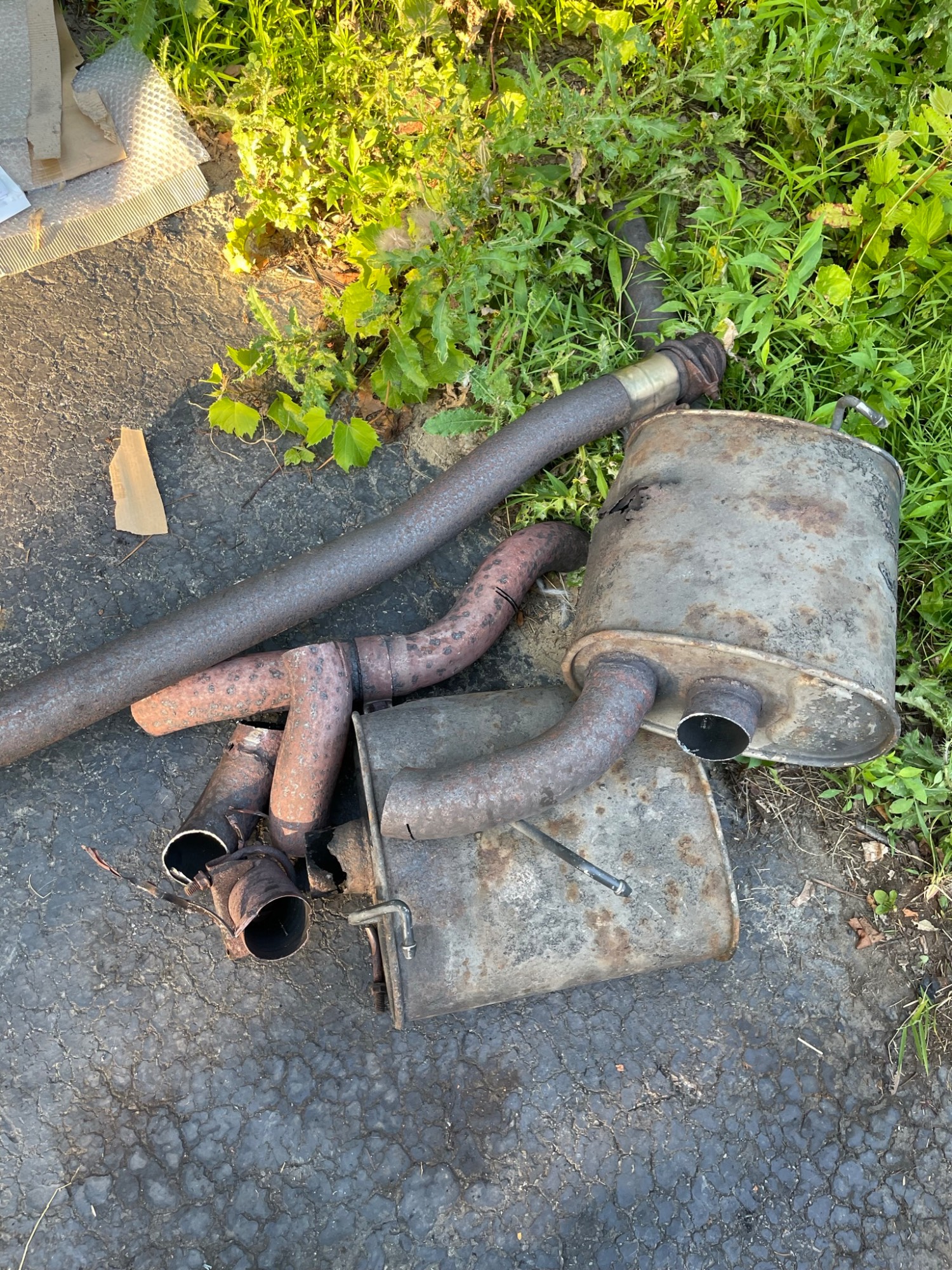

Went into the WwF ring with an XC muffler. Couldn’t get the joint above the axle apart, so had to successively cut pieces off , starting with grinder, finishing with Sawzall. Not too bad labor wise but a lot of obnoxious metal chips.

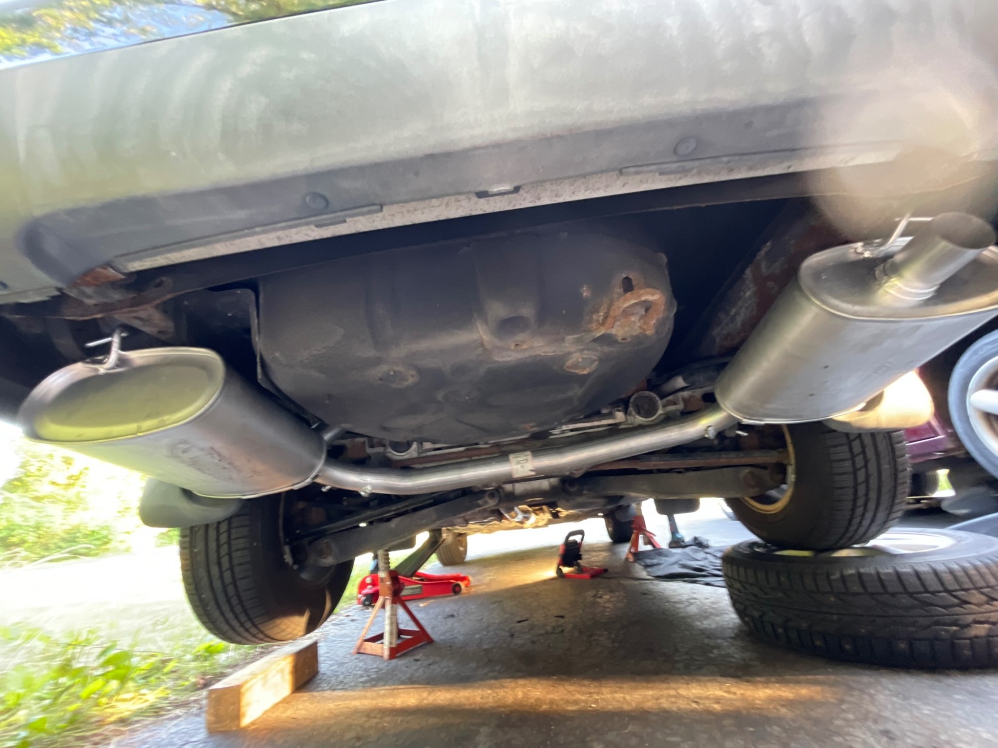

Mounted up the twin mufflers, got hangers on, then puttied and installed rear pipe.
Connected to cat with 21/2 inch band clamp with putty. I like this over the stock Volvo snout connection which is hard to get tight on an old exhaust
Checked fit, then tightened both band clamp and over axle clamp. I might need a bit of tube buffer on the rear right hanger, close to frame.

I had great results using a replacement flange kit for the cat-to-muffler connection. I had tried solutions like yours on Jane for many years and they always quickly failed. This flange kit seems totally solid and worth the $100 parts and labor.

Next time you do this, I have some cinder blocks you can borrow.abscate wrote: ↑19 Jul 2022, 19:11 Went into the WwF ring with an XC muffler. Couldn’t get the joint above the axle apart, so had to successively cut pieces off , starting with grinder, finishing with Sawzall. Not too bad labor wise but a lot of obnoxious metal chips.

Ah... gotta love a seamless removal!

That’s a great piece of kit. I’ll certainly look at that when this puppy fails. It is in 304 steeltoo, so hopefully I’ll get a few years.FireFox31 wrote: ↑19 Jul 2022, 20:27 I had great results using a replacement flange kit for the cat-to-muffler connection. I had tried solutions like yours on Jane for many years and they always quickly failed. This flange kit seems totally solid and worth the $100 parts and labor.
AnLPT exhaust is 60 mm stock OD so I’ll need a 2 3/8 version in worldwide units of inches instead of the esoterica meters

This is definitely nicer looking. I'm a little confused why it has 2 mufflers and 1 actual outlet.

Yeah, I've always been confused by that. The AWDs are weird. Except the 2000 R, which got dual outlets.

I suppose you could always make your own exhaust outlet on that side.bmdubya1198 wrote: ↑20 Jul 2022, 08:56Yeah, I've always been confused by that. The AWDs are weird. Except the 2000 R, which got dual outlets.

Yeah, it's probably not that hard.
