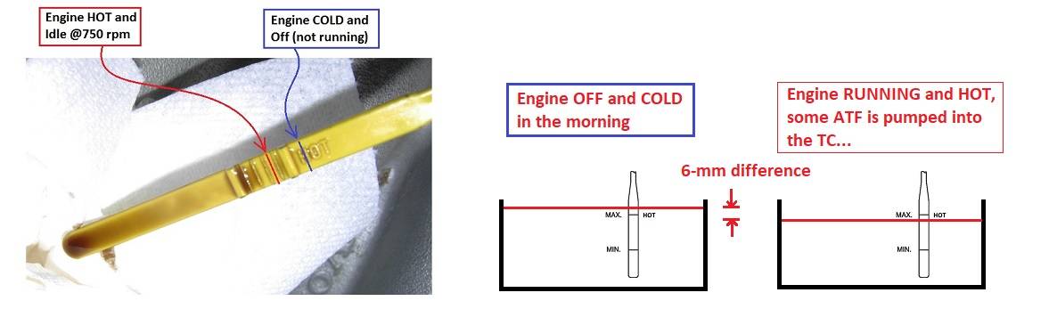

Someone asked me this question recently. I updated with this photo...
As I mentioned before, the P80 checking is easy bc the ATF dipstick is in the front of the engine.
The P2 (2005 XC90 2.5T, S60, V70, S80)...the dipstick is way down and you risk burning your hand if you follow the book.
This trick (checking ATF with engine OFF and COLD) is very useful if you need to check the car in the morning
(engine oil, ATF levels etc.) before a long trip...
So, this photo will serve to illustrate what I said previously.

The 2000 "R" and Base P80's have a plastic yellow dipstick as per your picture as they have the 5 speed auto trans. It is not too terrible to check on an NA but on the 'R' you had better where Teflon gloves if you can even see the dipstick. In both cases you have to remove the cold air intake pipe t get to it if at all!
