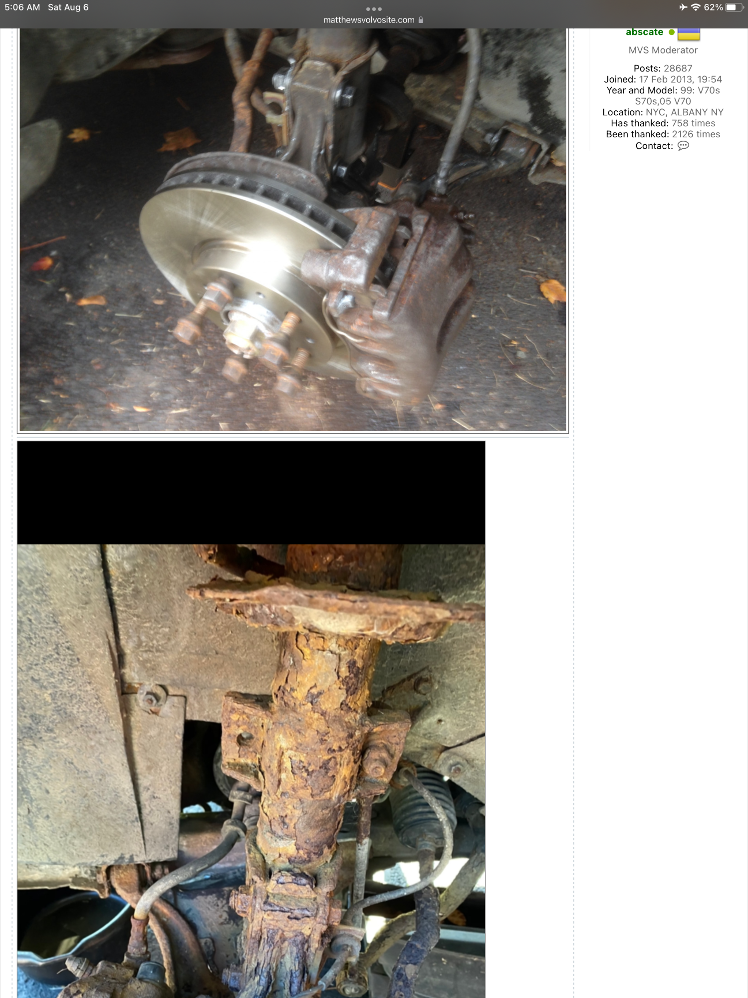

My favourite before/after strut photo is here…..
- E35943E8-BCDC-4D41-A4EE-3E248840E1C7.png (2.99 MiB) Viewed 500 times

Why would you batter and deep fry your struts?
I bet they tasted terrible, even with the "extra crispy" recipe.

Which one is before?
