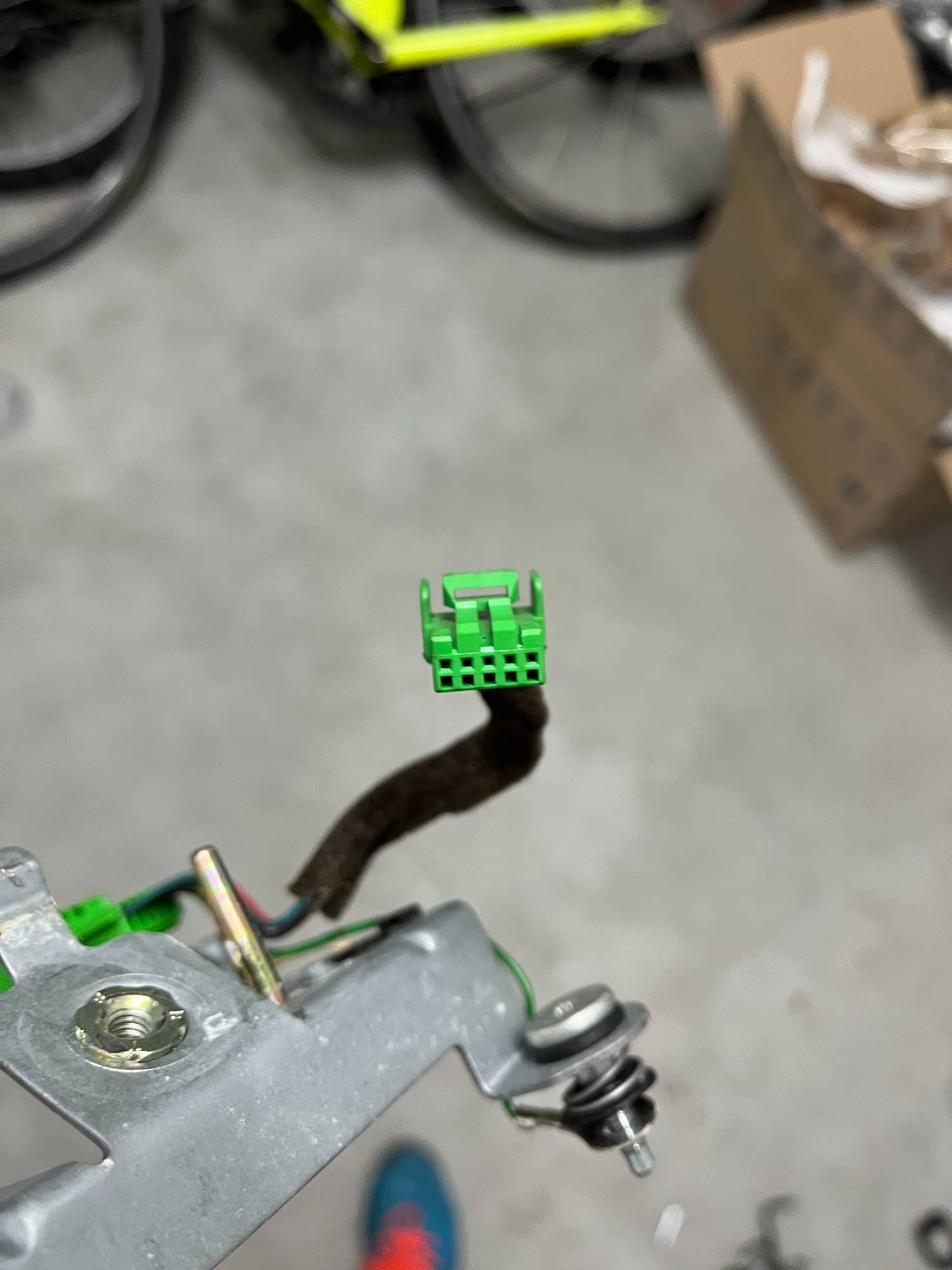

So I have a V70 T5 2001, with a 4-spoke steering wheel, only cruise control fitted by the manufacturer.
I decided as I am happy with the original head unit, and my phone is connected to it with BT, would be useful if I can get the audio control to the other side,
Quick research said the wiring should be there so plug and play. YAY! went on ebay, week later the item is arrived, after struggling to remove the airbag for half an hour, finally i reach the point to change the blank item to the buttons. But no harnes been found?!
Was checking in Vida which got be a harness cable between the cruise control and the audio control, which feels like stupid and even it would not have the same connector as my audio buttons (audio 2x5 pin, harness 9pin)
So im at a question, Do I missing something?
How its should be connected, what cable I would need?
As of now have on the bracket is this connector only, which is goes to the cruise control
The cruise control has 2 sockets only 1 being in use(top)
The audio control has 2 connections, but not sure which one should I use and whit what cable

The audio control lower socket and the cruise control cable, from the original harness can be connected, however, it won't work
