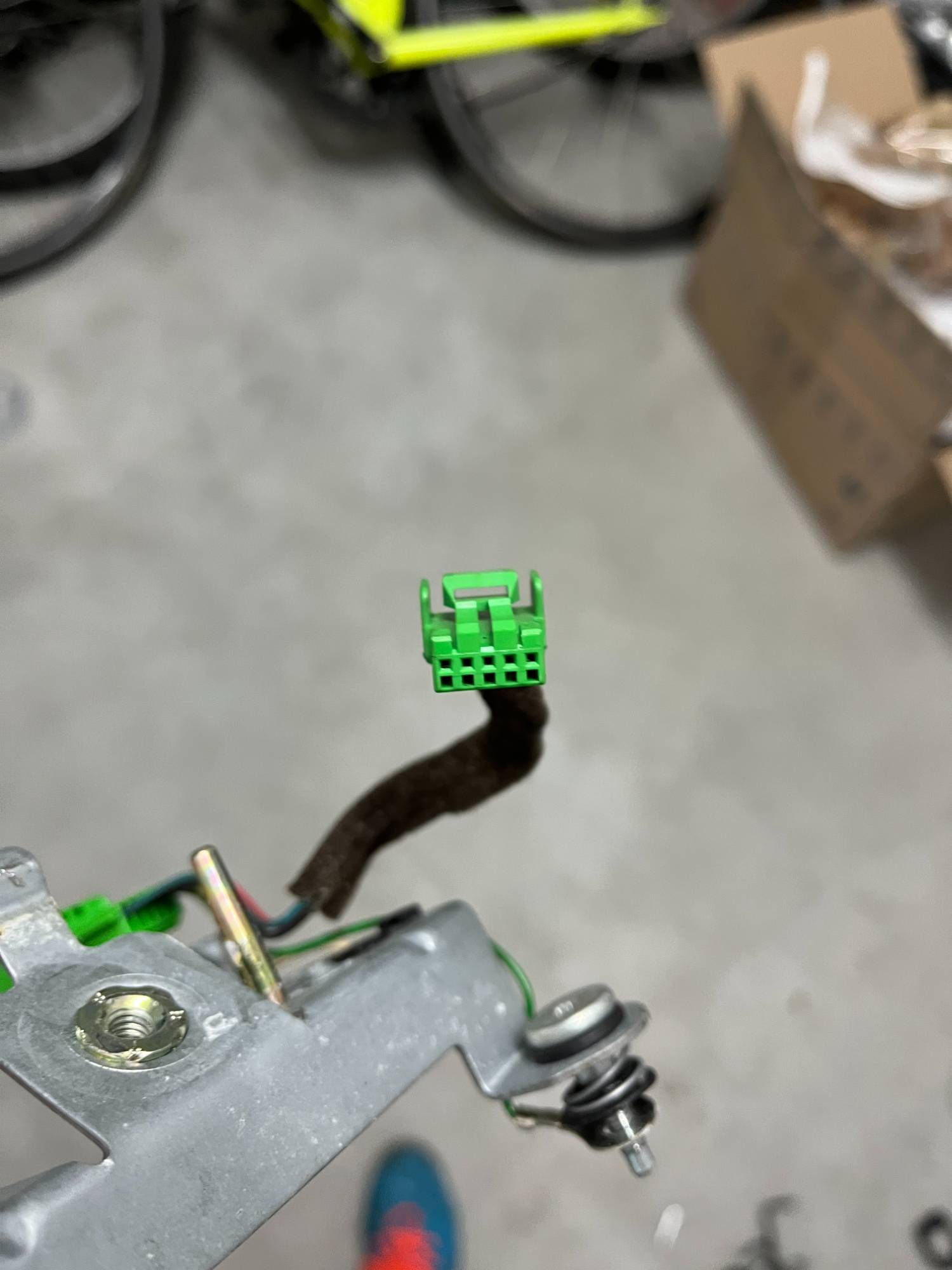

As of know have on the bracket is this connector only, which is goes to the cruise control
The cruise control has 2 sockets only 1 being in use(top)

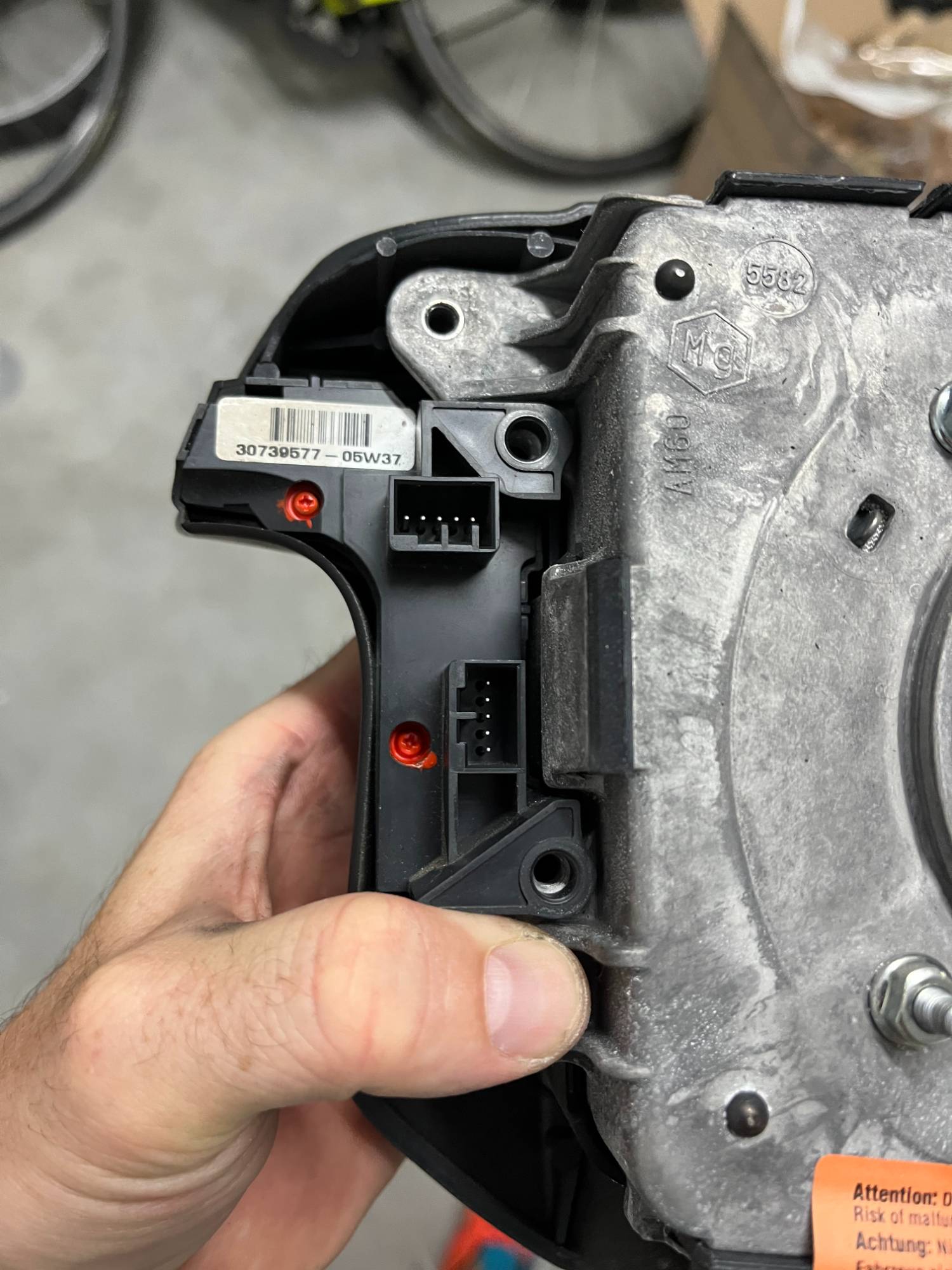

The audio control has 2 connections, but not sure which one should I use and whit what cable
audio control.JPG (265.44 KiB) Viewed 289 times
The audio control lower socket and the cruise control cable can be connected, from the original harness, however, it won't work
The cable harness I found is this:
https://www.volvopartswebstore.com/prod ... 45540.html
It might connect to the cruise control socket, but on the other side? for sure not connect to the audio
