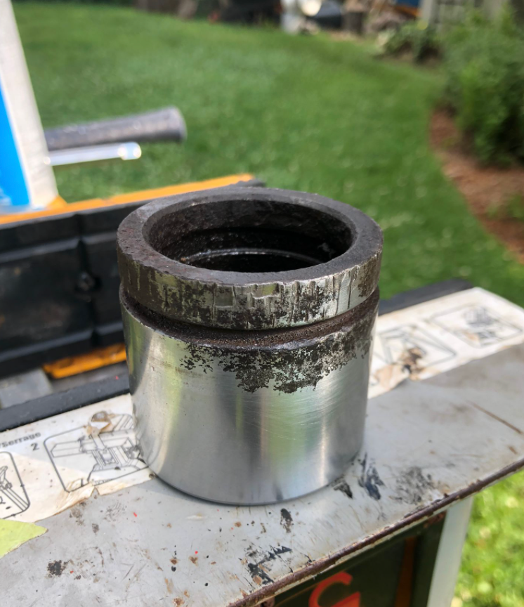

Car is back on the road.
I decided to rebuild my calipers if possible.
The passenger side piston popped out without an issue but the driver's side required a battle with a pipe wrench. The issue was the rubber seal tore or popped out of groove and allowed rust to build up. This was after cleaning up:
The bore of the caliper was fine though. I ordered one rebuild kit with a piston and one rebuild kit with just seals.

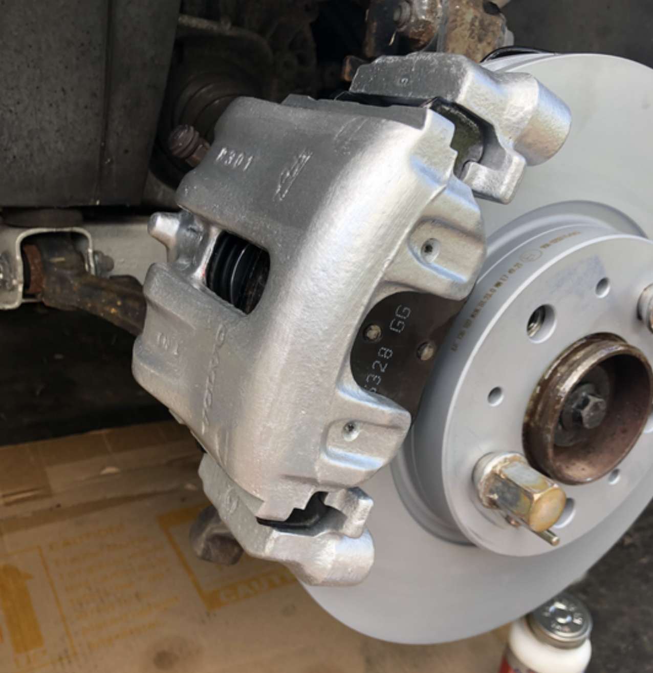

I used electrolysis and elbow grease to get the calipers and brackets back to bare metal.
Then I painted them with G2 epoxy paint. (yes I know I'm missing the spring here. It went on.

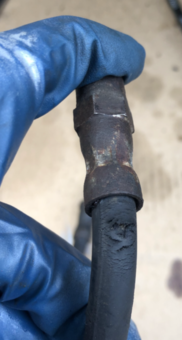

new disks, pads , and brake lines as I discovered a lot of cracking and general deterioration on the hoses.
The hardest part of the job was freeing the hose from the hard brake line but a propane torch and lots of penetrating oil saved the day.

amblerman wrote: 10 Aug 2022, 10:31 I used electrolysis and elbow grease to get the calipers and brackets back to bare metal.
This is really nice.

BlackBart wrote: 10 Aug 2022, 11:20
Thanks,
Part of me was toying with the idea of getting a clear caliper paint as they looked so nice in the bare metal.
But I chickened out and went with silver.
I had also found a nice light blue that approximated the Volvo Polestar color but I wasn't sure I could handle the extra HP that color would have added to my car. ;-)

On at least one rebuilt caliper I bought, the boot was not seated around the entire circumference. From day one, it would let water in to the piston, ultimately causing the damage you had. Thus, I always check new caliper boots extensively before installing, reseating them when necessary.
Amazing results. How did you clean the calipers that well without a sandblasting cabinet? Granted, I'm used to seeing New England calipers "pulled from the lake", as people say. After getting my new four calipers stripped and powder coated, I intend to try and rehabilitate my current ones as spares, like you did.
