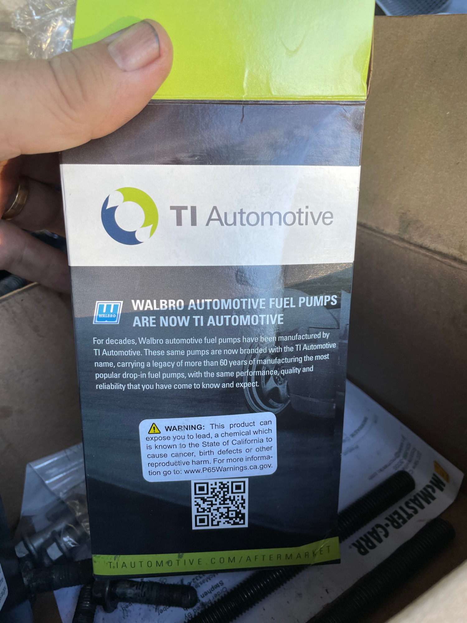

- Posts: 36147
The above link is a more expensive pump, about $110, but it’s actually a Walbro design
- Posts: 15486
- Has thanked: 2199 times
So abscate did you give up on the job lot you got? Did you go out and buy another?
- Posts: 36147
Ebay guy sent me two replacements for the ones that were dead. I was $10 into them.scot850 wrote: 01 Sep 2022, 20:33 So abscate did you give up on the job lot you got? Did you go out and buy another?
The TI pumps above were more expensive but were assembled with the snout all good to go, no fitment issues. $110 but I’m sure feeling better about that with all that Labour
