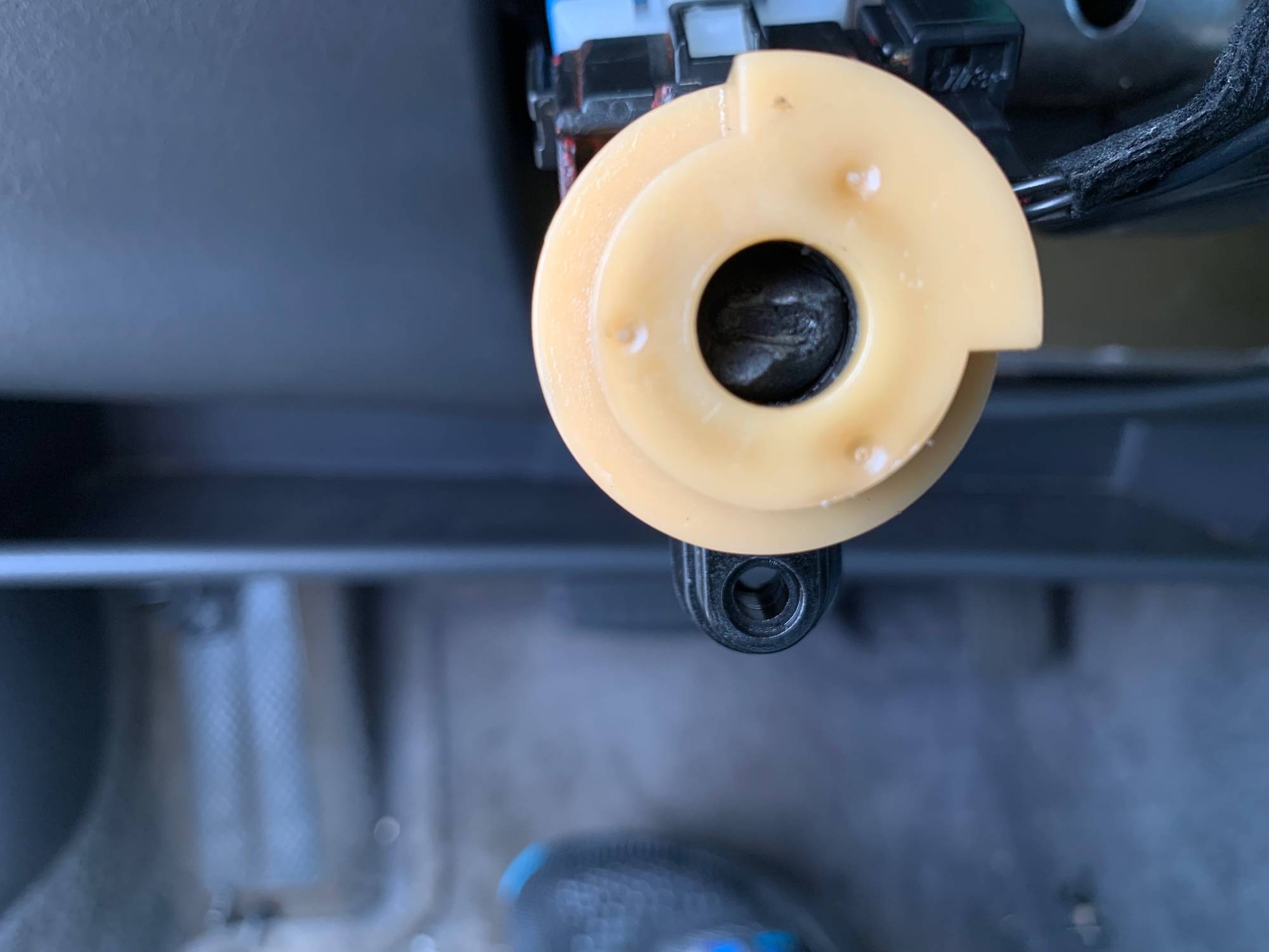

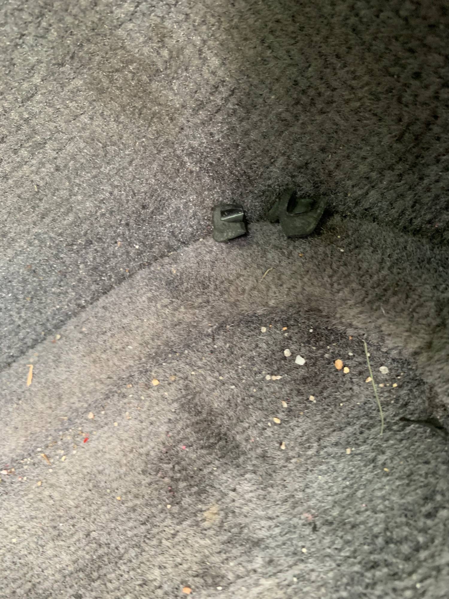

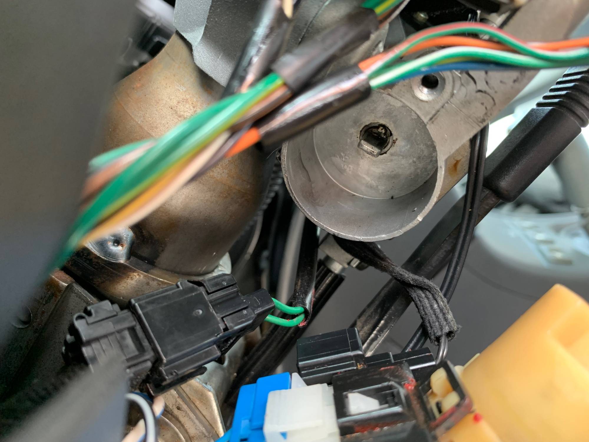

I finally removed the ignition switch from the column lock assembly and noticed that a couple of black plastic bits came out too! I think I know why I was getting a no crack, no start condition, but wanted to see what people with more experience than me thought.

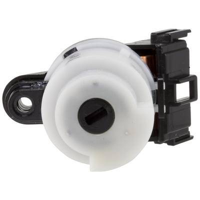

When you put the key in and turn it, the long metal rod that goes inside of the ignition switch also turns a mechanism inside the ignition switch. I'm wondering since my internal plastic bits were essentially crumbs, the metal shaft had nothing grab on and that's why the car would not start? I found a picture on the site where a brand new ignition switch has the plastic, where mine is doesn't exist.
A new switch is in the mail but I'm wondering if anyone could tell for sure? Is the broken plastic the thing I always hear about with respect to the "typical" ignition problem with our cars?

If the new switch does not do the trick. Leave the bolt out of the switch. Turn key to start and turn switch the opposite way. If it starts, it is the Column lock. Which are notorious for going out on the X40 platform.
I wired a push to start button on mine and mounted the switch in a empty slot next to the radio. It was in the middle of a blizzard and there was no way I was going to spend 4+ hours changing out a Column lock in that weather. It works so well I never changed the Column lock.
