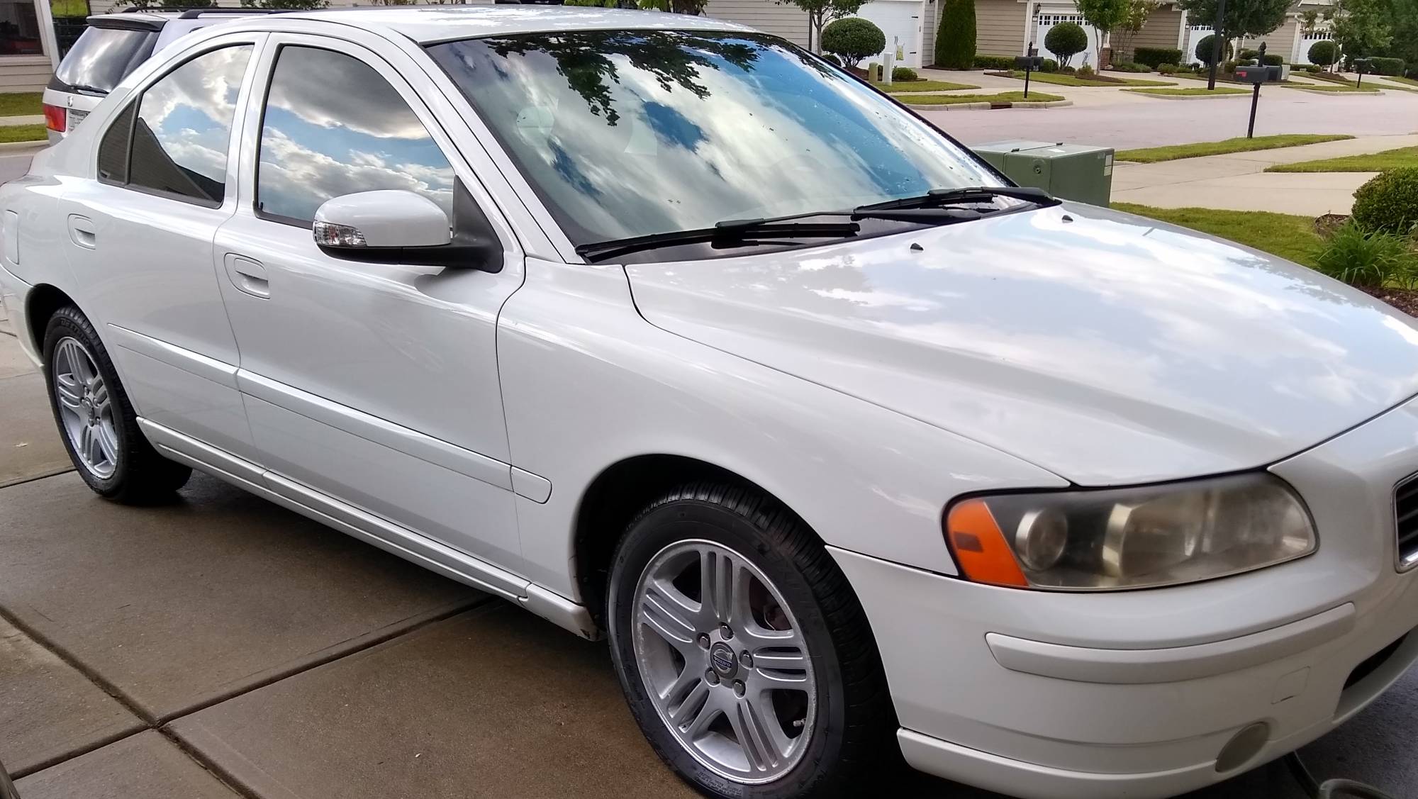

Another project :lol: :? .

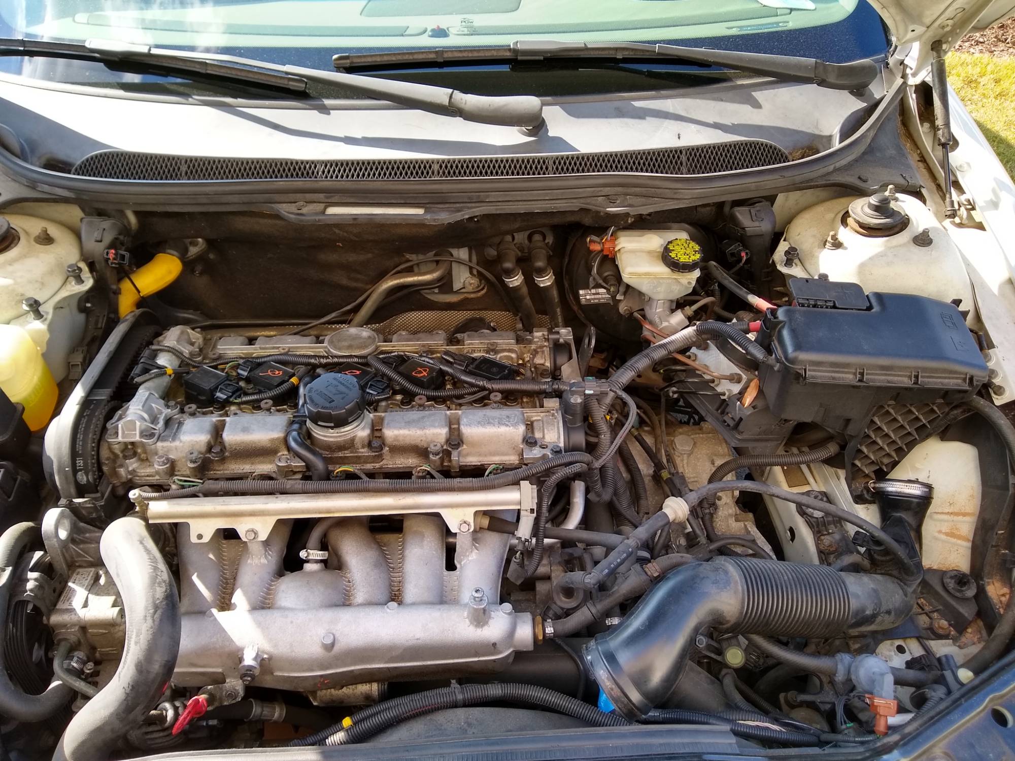

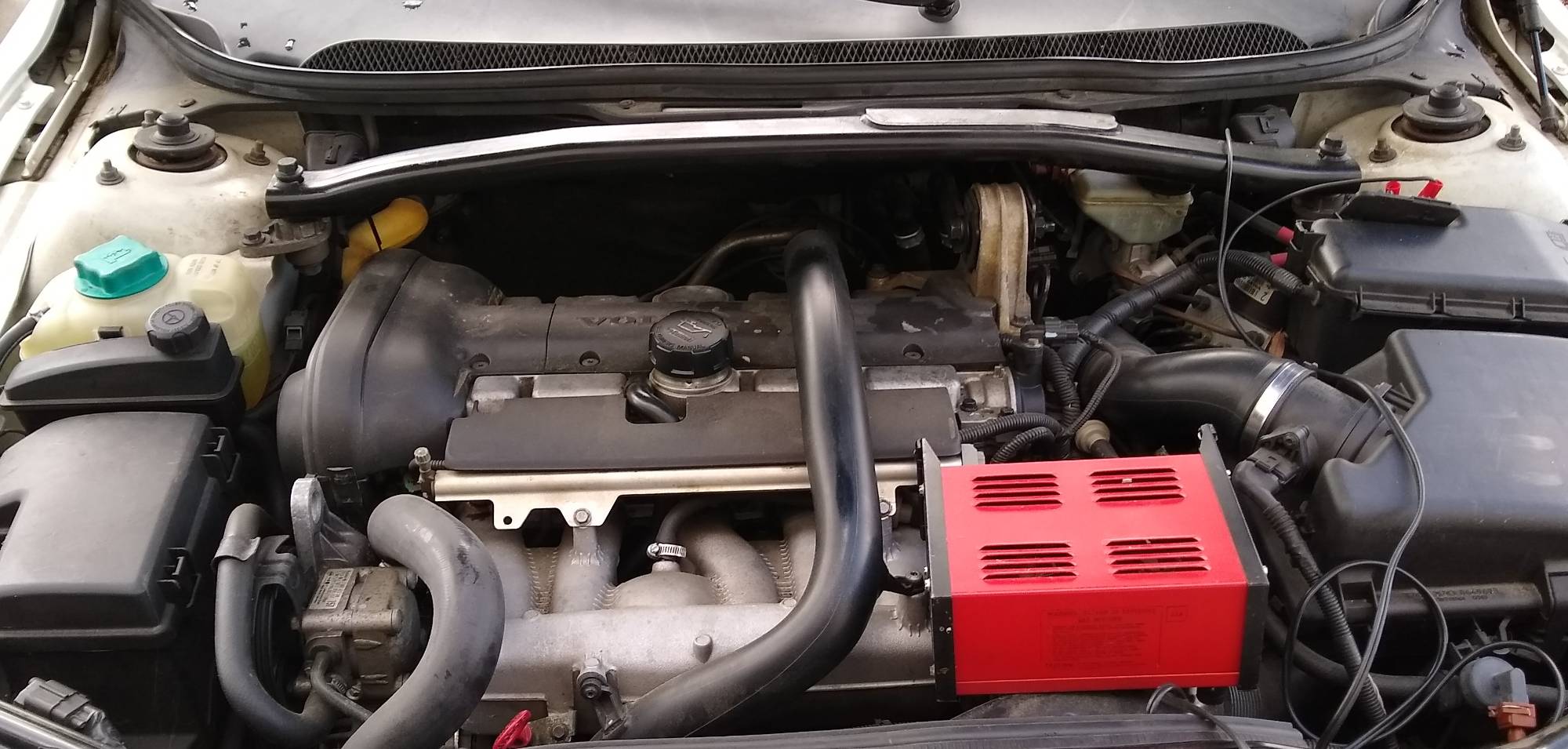

The car has unending thick plume of smoke. Enough to cover the neighborhood so have to shut it off very quickly. Thing was 5 quarts low on oil when I got it. After filling it started twice for less than 30 seconds and there is a large leak on the cardboard. Can't do much as it's in a senior community. The garage is getting lights install then insulation in the walls and attic. Will be awhile so I may have it towed to friend's home more rural with room to work. No water on dipstick, no oil in coolant. 153K miles.
Where do I start besides the quick cleaning and Tech Choice sealant. As for the interior, needs deep cleaning and clothe on door panels replaced.

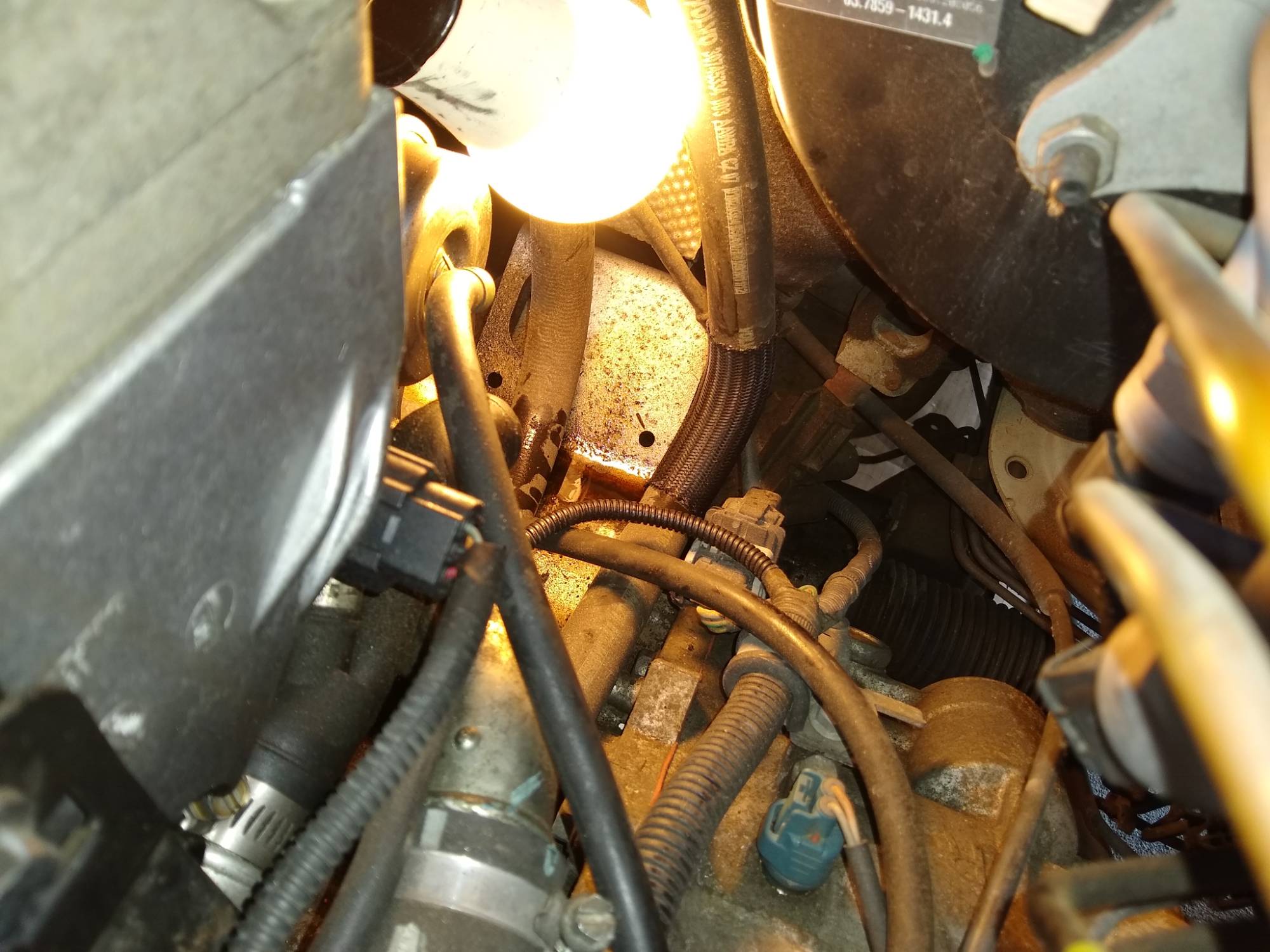

white smoke I'd expect coolant , blue smoke is oil.
coolant can reach the exhaust if the seals fail in the turbo, blown turbo will also blow blue smoke.
I would inspect the turbo from under the car, ramps or jackstands and a strong light, losing that much oil should be easy to track down.

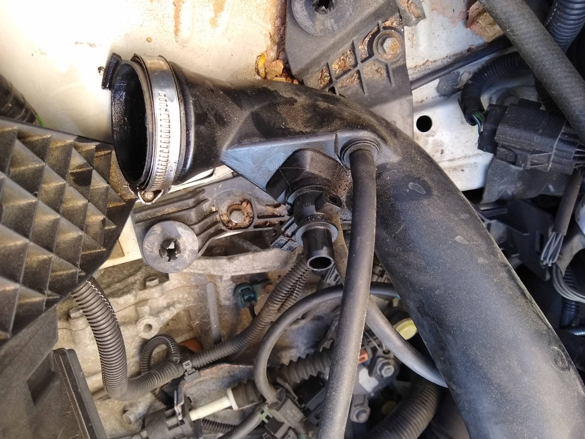

Oil in the turbo and lots of play in the turbine shaft. Both the turbo and inter-cooler pipes had lots of fresh oil inside and drained out.
