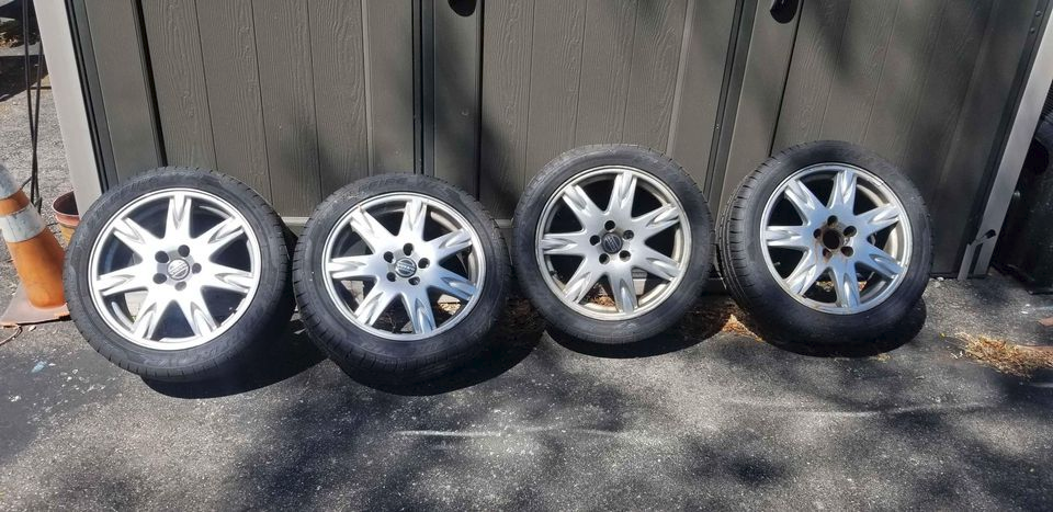

Now if I could only get these to NC! If not perhaps someone else can use them.
$50 Set of 4 Volvo OEM Snowflake Wheels 8634737
https://www.facebook.com/marketplace/it ... _type=post
