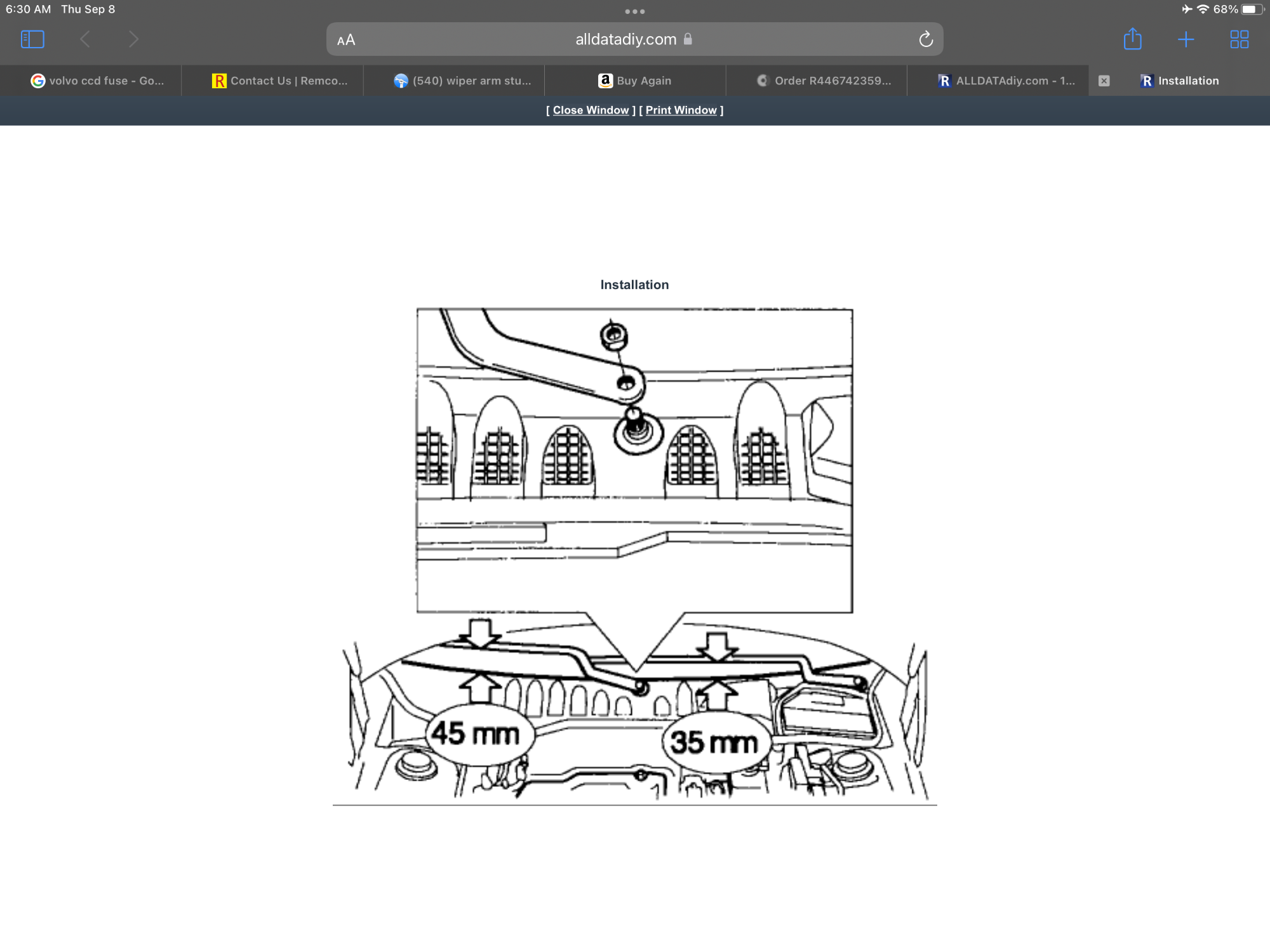

This new blade does not have any serrations in the hole. Are they supposed to be there, or only formed after screwing it on tight ? They gave me PN 9151087 (driver's side) (genuine part).
I last replaced it 7/2019 and IDPusa sent me PN 8501996 which is no longer in their system.
The leaky part is the AIR VENT VALVE PN 9151208 (thanks, IDPusa phone guy). But they don't carry it !
What diameter hose do I need for this portion of the system? I might have to cut some hose so I want some on hand. And some connectors. Volvo only sells complete harnesses.
