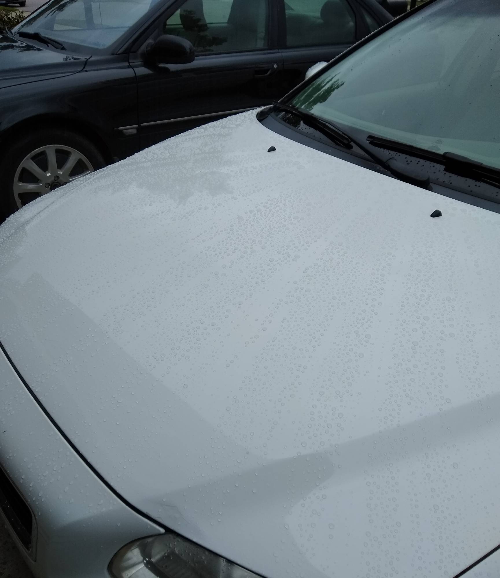

Well, it was over a week or so when I washed the Project 2007 S60 2.5. When I arrived at my folks the other day the electrician said someone sprayed down the S60 but not the S80. He heard something going on outside but when he came out he didn't see anything. It was completely wet.
A neighbor had told me that some of the other neighbors were asking about the parking of 2 car in our driveway (1 allowed). Not wanting to think
... Perhaps someone thought the car was dirty, but how? I ask one neighbor if they saw anyone and she said it just rained not too long ago. Didn't know the other neighbor well enough to ask, besides why would anyone just hose down one car. Sorry, long story short but yesterday it rain again.
