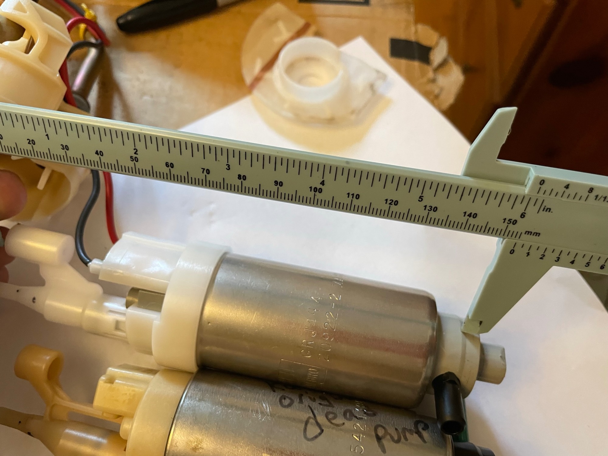

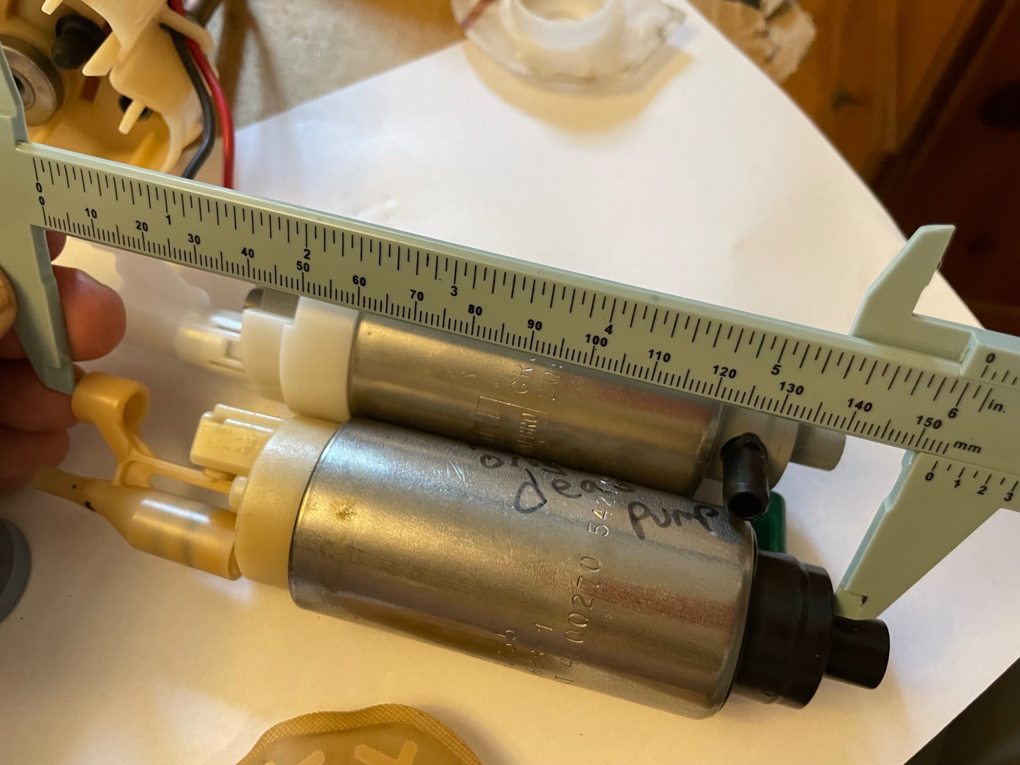

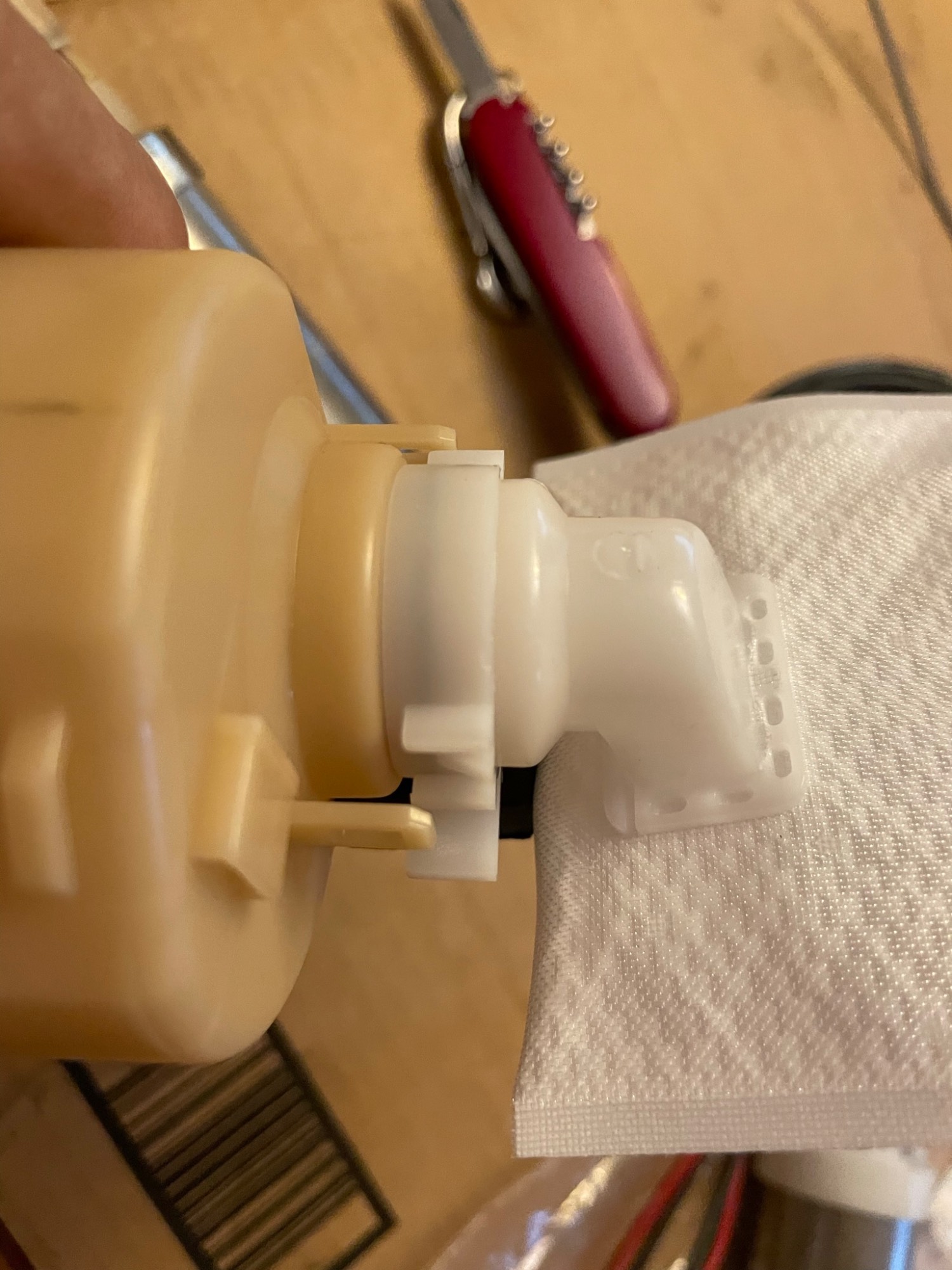

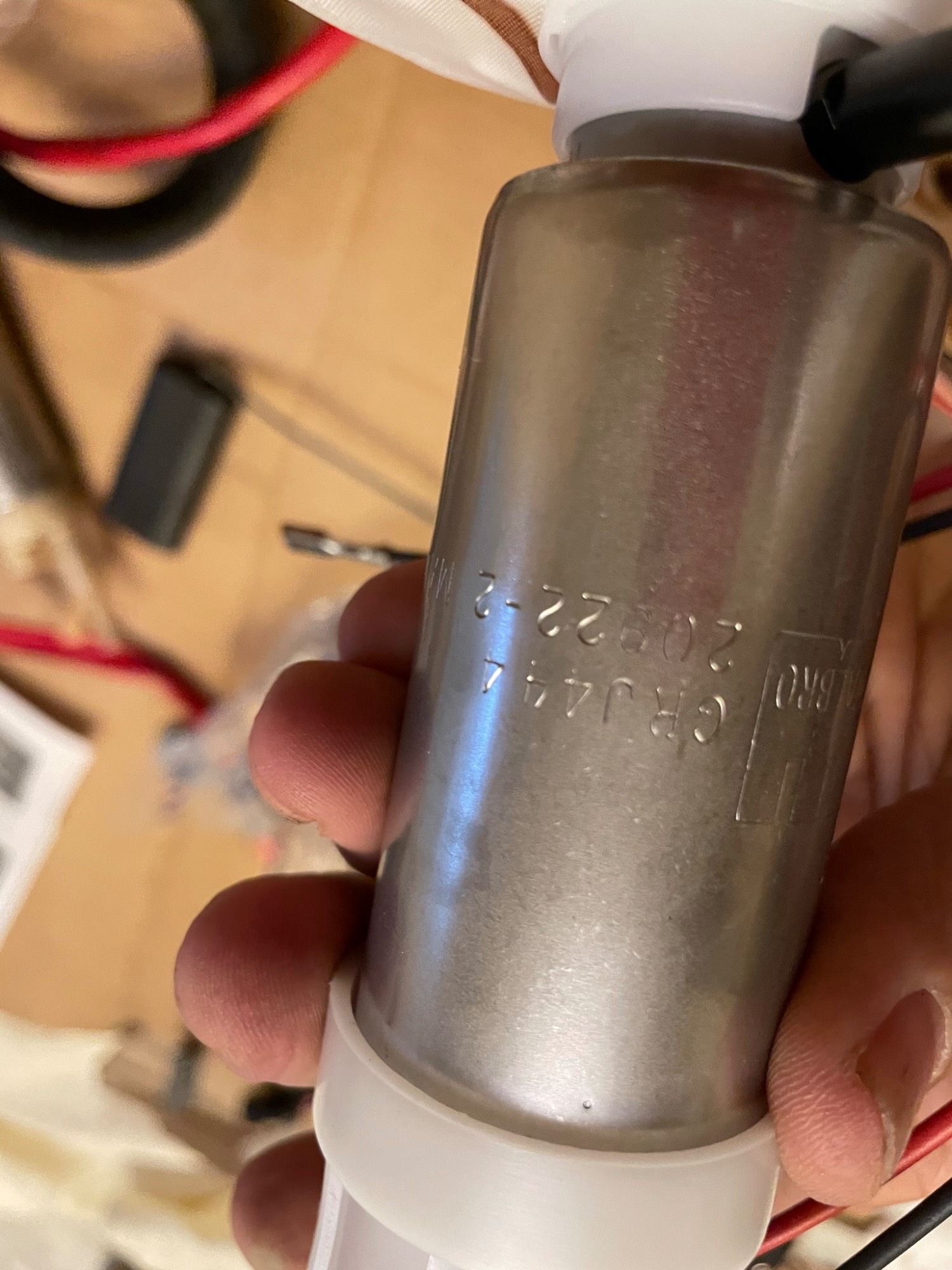

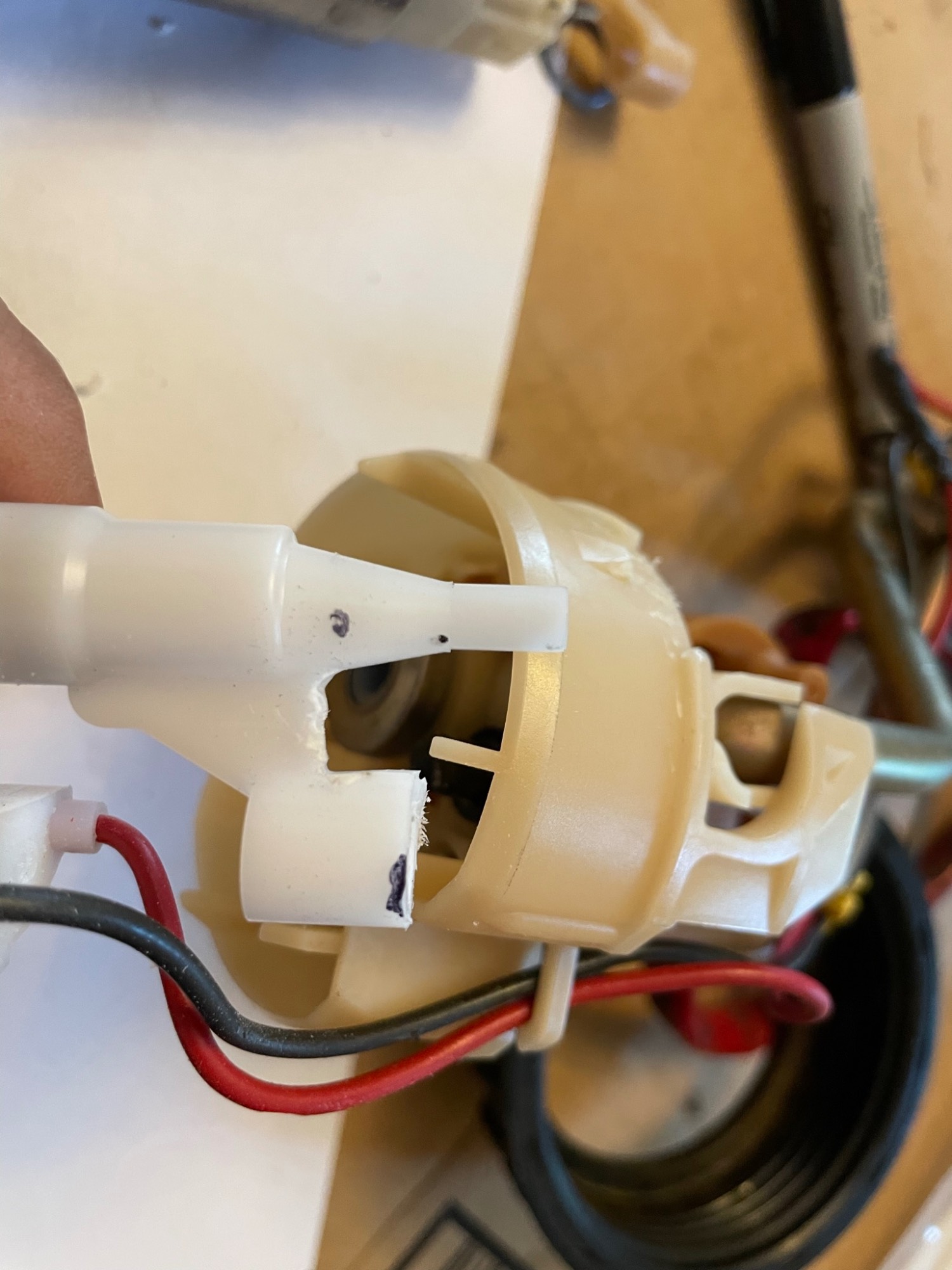

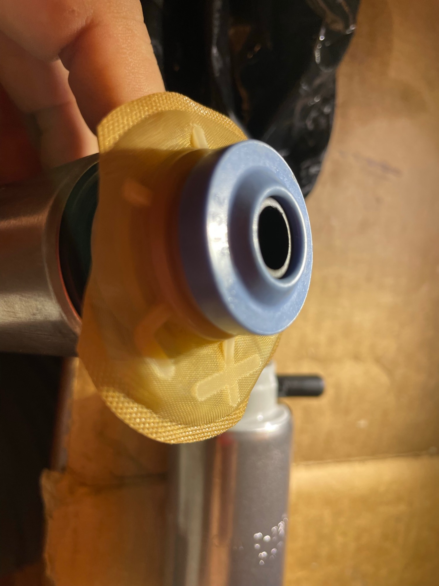

I implemented the TI pump into the Kat this week. This took some modification.
It’s a Walbro GRJ444 pump made by TI
The pump sits inside a long plastic tube , and unlike the FWD pump , the seal to the fuel line is accomplished by squeezing a conical sleeve into a silicone receiver in the housing.
The TI pump is slightly longer than the original, so I had to trim the plastic guide snout to rationalize
The sock is slightly different on the bottom, secure with a drop of epoxy on two sides
Wiring plug is different and the case ground is no longer needed. You do need to ground the fuel lines though using the ground lug.

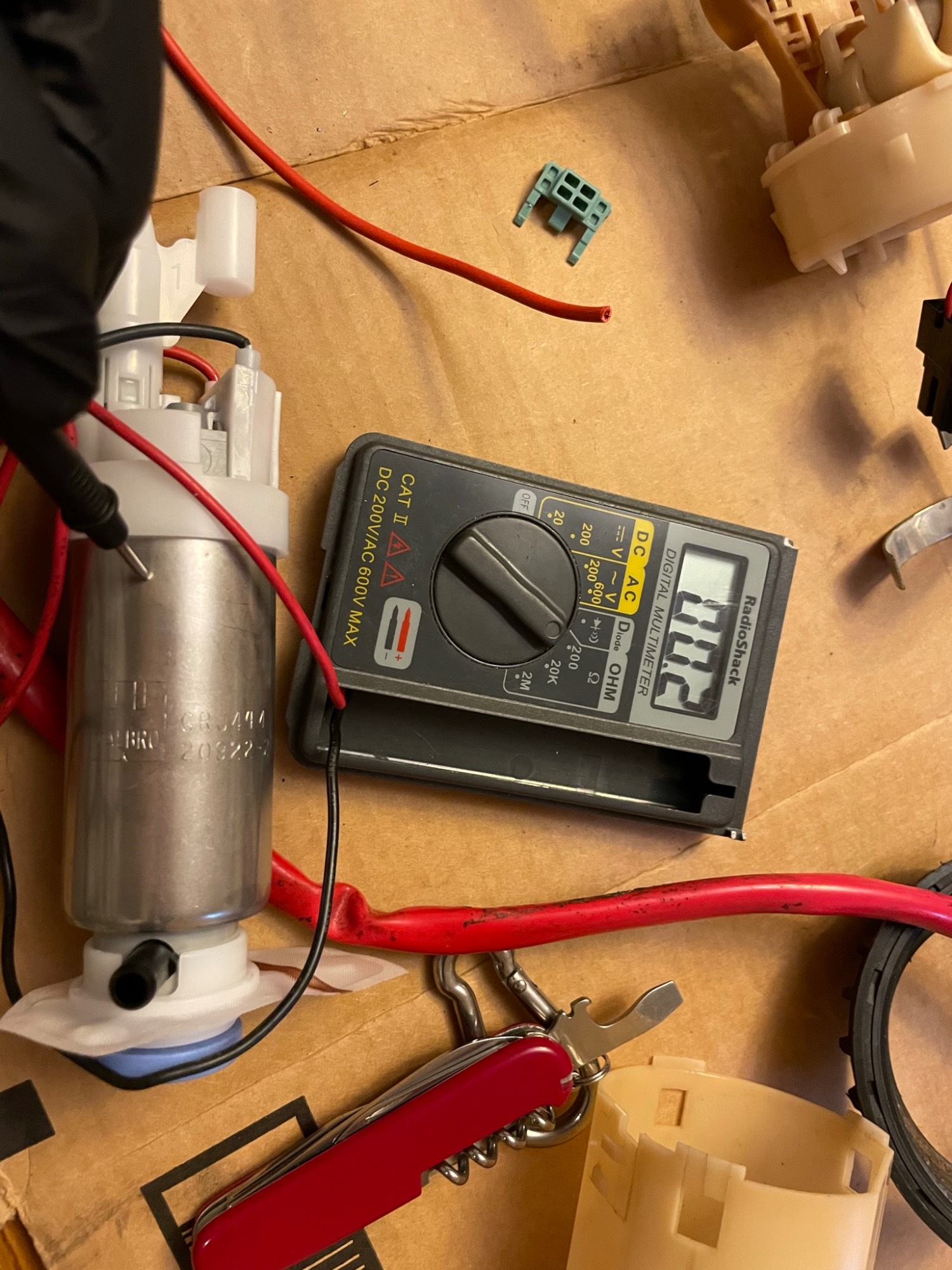

My pump wires had failed at the external connector so I made a through hull wire connector with a piece of CuNiForm and an epoxy plug of about 5 cm to seal
Plan B..one could also figure out how to connect o the tapered output snout of the pump and then run fuel line to direct connect the pump to the metal output line.

TI pump implementation photos, captions to come

Vintage Radio Shack multimeter !
You're going to force me to casually leave my old Fluke in a pic now.
I think Robert did something similar to his Cincinnati 850T5R when he installed a high-volume pump recently.
